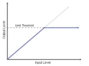

My understanding of limiting is that when the signal hits the limiter threshold that's it. The signal does not get any louder once the limiter is acting. Therefore a true limiter is a (Infinite ratio) ∞:1. With an extremely fast attack.

I don't see that. If 20:1 means that you need to go 20db over the threshold to get 1db over. So, if we assume that (infinity):1 is the same as 100:1, then you'd need to go 100db over the threshold to get 1db over. So, I'm pretty sure that infinity (i don't know how to make the "infinity" symbol) to 1 ratio, or even 50:1 ration is a pretty hard ceiling. I can't see anything going over the threshold with those ratios.

If the ratio is infinite is the actual setting then the actual point where the limiting occurs? Also audio does not actual increase in steps of 1 dB, it could be 0.000001dB above threshold, or in the case if infinite 0.1(-1000000000000∞) above threshold.
Answer? I don't know the science, only that a true limiter will not let the audio level go above the threshold, where by a compressor will reduce the audio level above the threshold by the amount set by the ratio.

If I have an 8:1 ratio and go 4db over, I'll see a 1/2 db over the threshold, I guess.
So with inifity :1 (don't know the symbol either), the compressed level will technically pass the threshold, but not by a significant amount.
For some reason I pictured that any level in excess of the threshold would be reduced to 1db over. :facepalm:
Right. I guess, mathematically, a signal will always pass the threshold by some fraction of a db, no matter high high the ratio. But at some point, it must stop being significant enough even call it passing the threshold.
