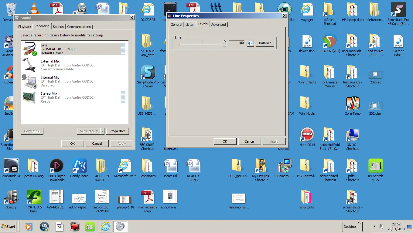

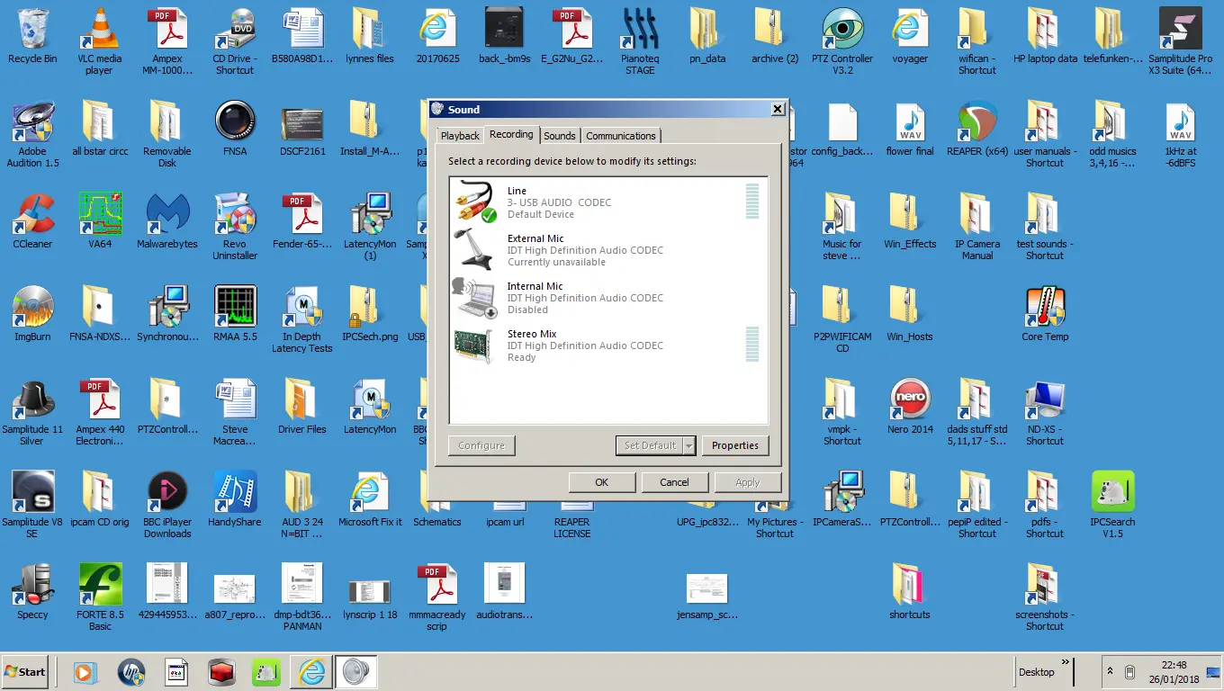

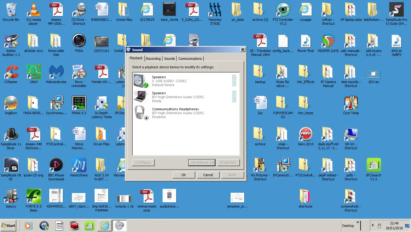

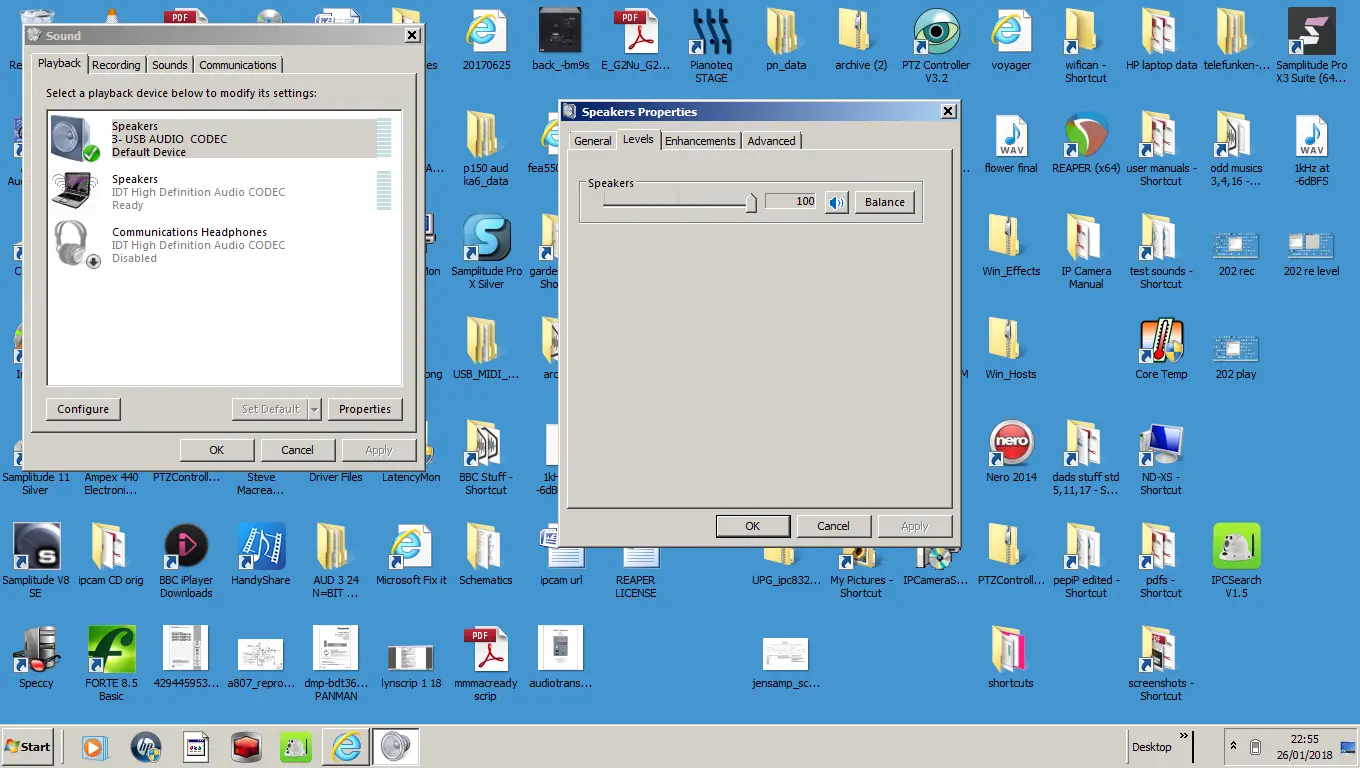

Whatever, that shows the settings for the UCA202 in Windows. The settings need doing for Reaper (defaults to ASIO which won't work) but I think OP has that working? Just need to get the levels sorted..On it. Brekky first.
Oooo! Did NOT like that!
I rigged the attached clip to come out of my KA6 at about 1.5V max on peaks and the 202* was off scale and sounded horrible!
I had to back the level off (in Sampltude) to no more than +3dBu out of the RCA plugs to get a clean recording. That is a smell under 1V.
If overload into the 202 is the problem and you are going to keep the device, the best solution is a 10k log stereo pot in a tin. You can also rationalize to jacks at the same time.
