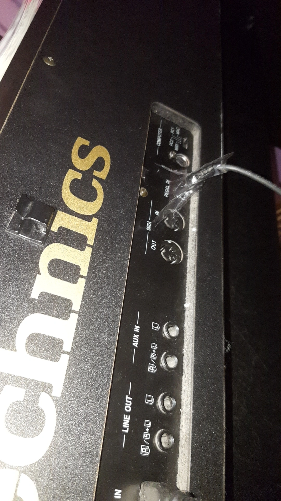

I attached the back of my keyboard's back, thanks for all the help btw!
My desktop has a Line In and Mic In, but I'd much rather record on my laptop so I can have it right beside my piano.
What would you recommend me ordering to make this setup work?

Those look like 1/4" to me so, yeah...The two items linked in my previous post should work just fine.
Alternatively you could just get/make a 2x 1/4" TS to 1x 1/8" TRS cable like this and run straight into your computer as long as it's definitely got a stereo line input.
Be aware, though, quite often the line input inside a computer can be noisy and that's part of the reason why we end up using external devices.
