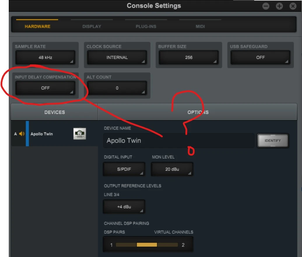

How do I use this function?

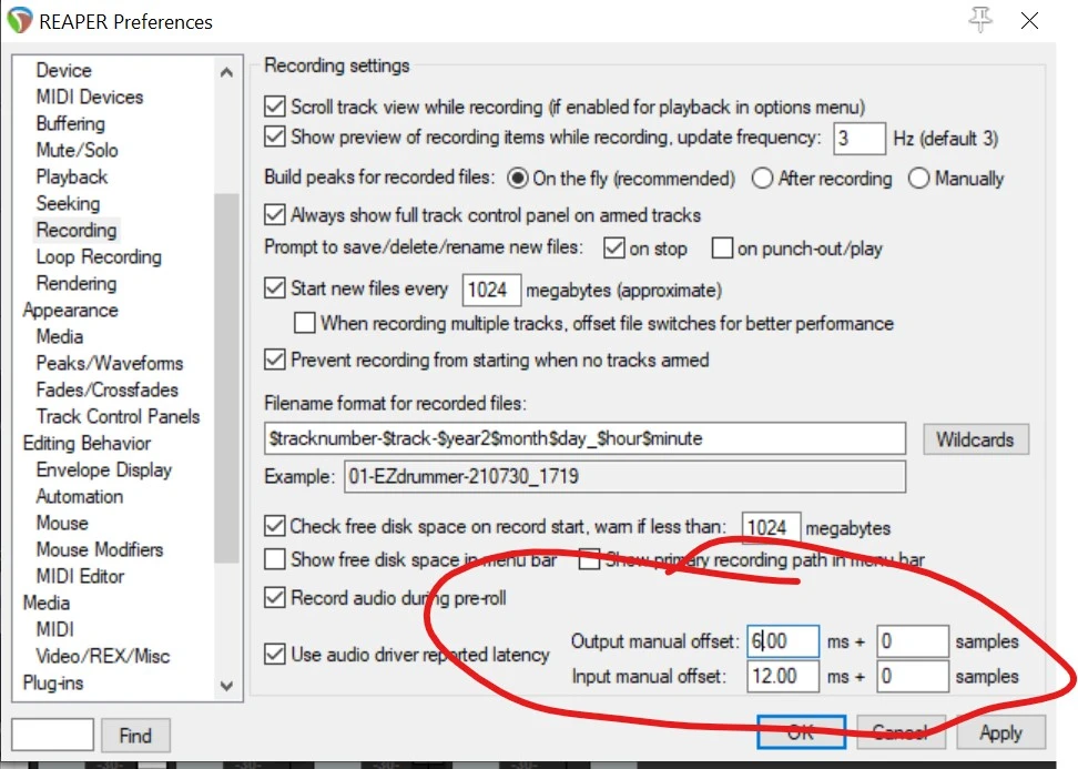

That is not the same as the one in Reaper. That one I measure and take a shot in the dark.
I want it to automatically stay in time. Perfect layering of tracks like a tape recorder.
Suggestions?
