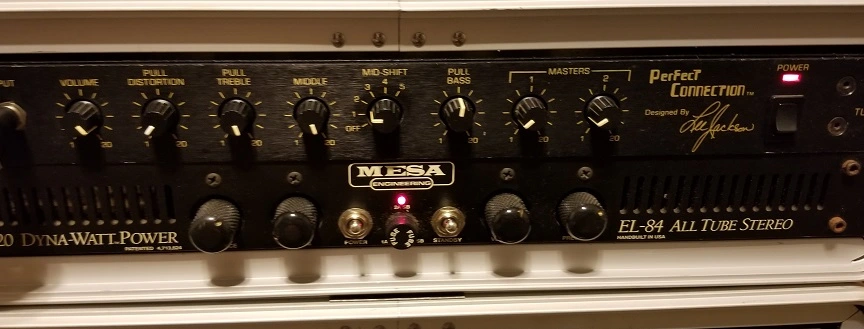

GTO, what is really strange. That GP-1000 video, the guy turns the knobs and changes the mid curve. Does his actual sound change that much? I didn't think so. Also look at how low his Masters are! All the way down? Even if the one channel B looks cracked open at 0.1/20 level, how is the sound so strong?

So Rob, the knobs are irrelevant? His knobs , the Masters are ALL the WAY DOWN! There's NO FUCKING WAY THAT IS HOW TO SOUND BIG AND FULL!
My knobs on my GP-1000 are set just like his. It sounds nothing like that. Unless I crank the power amp, it is extremely quiet.

You can't hear the tone difference when he adjusts the mid volume (note he hasn't adjusted the mid-point)? If that's the case, you need to correct your monitoring ability or ears, as I can hear the differences with my old ears with tinnitus.
The master volume for the right channel is at 1. The channel volume is at 100%. Are you plugging the output of the GP-1000 into the return loop of the MESA?
Yes, and the knobs go 1-20 in range. The first hash 1 is ZERO.

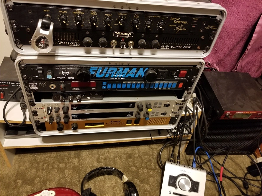

Hey Lazer......been following this thread but I have to admit I'm confused about your signal path and amps and speakers. If that's your photo are you running into a stereo PA system? Anyway.....do a quick list of your signal path if you can. Also....what guitar are you using most? Have you changed the pups?
Mick
Thanks. Sure.
Stratocaster-GP1000-mesa 20/20-1x12 celestion green back 12" 20 watt 8 ohm. Pickups are Seymour Duncan, the Hot Rails set.
No, not this time. No PA used here.
His Mesa is the dual Recto, but that is a Dyna 50/50 power section with 6v6's. I will not attribute any sound benefit from that power amp over my mesa dyna 20/20.

Yeah.....with that setup you should be able to get pretty much near any sound (short of a Ric 325 and a Vox AC30) you want.
The issue about technique does have some validity.....but can't account for wide tonal differences with identical setups. Some.....for sure......pick thickness....approach......fingering....etc...etc. In my own experience.....I do know that as I got better over the years at playing.....I got better at emulating the tones I liked.
But you have always said that your tone is thin and lacks power.....I think. Your room might really be killing you.....as you mic your amps. By the way...what mics do you use? Do you have friends that play by any chance? Have them come and play in your space and see what happens.
