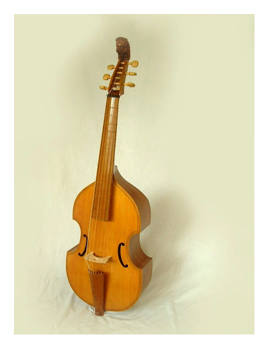

The Viol not a violin. The Viola da Gamba is an instrument that was popular in at the time the violin was in it's early developement. It was a consort instrument and used for a differing style of music. It has gut tied frets in much the same way a lute. The scale length on the one I fretted with 31 frets was around 23 inches or 550mm. True its a lot of frets but it wass still playable.
Here's a picture of one I made quite sometime ago that is very similar in style. Its based on a surviving instrument made about c1650. The modern double base with the flat back is a direct descendant of the Viola da Gamba. I'll try and dig out some pictures of the 31 fret example and scan and post a few. Might take a while my filing system isn't all it could be and I haven't seen them for a looooong time. ;)
