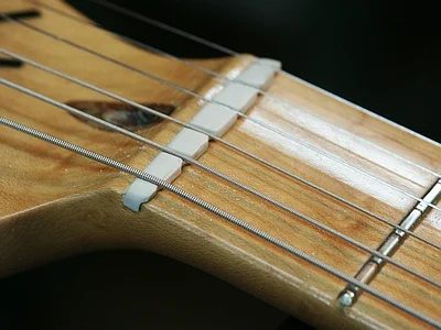

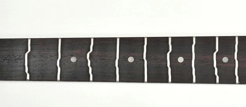

The intonation issue is why you have "solutions" like the Buzz Feiten nut, Eavana compensated nut and the True Temperment frets. I once tried a Carvin guitar with a Feiten setup. It did sound a bit better than the same guitar with a standard nut. I don't know if I could do the True Temp frets. but changing the nut didn't have a downside.
Surely the nut thing only helps with open strings and it totally defeated by a capo?
