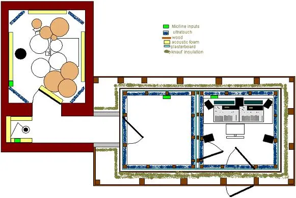

Actually i do plan on setting up 24 mics occasionally, for live recording. I'm building a studio out of a shed, and a 3 brick thick bomb shelter. The bomb shelter has 2 small rooms. The larger will be a drum booth, with 12 mic ins(8mics for standard kits and more if someone brings a bigger kit). the smaller will be a vocal booth with 2 mic ins(maybe someone will want to sing and play accoustic guitar at the same time). The shed will house one live room(tiny by your standards, but as big i can afford/allow), with 10 mic ins, and the control room. I have experience in recording just a few channels with just a few mics, and now i'm moving up to this. Also i'm in a college course learning music technology where we have 2 control 24s and an 02r96. And yes i noticed the name of this forum, but like i said, i didn't know where else to put it. Seeing as i'm in here most i thought i'd ask here. Also, isn't equipment part of building, ie you build to suit the equipment you think you'll buy.

lol, yeah, i will be getting other things than Behringer, but they will make up most of my equipment. I know, only in prestwick, but you'll see :p ! It's a 14' x 8' shed and will be split into 2 rooms. It will have plasterboard on the inside, with 3.5" Ultratouch insulation all over, covered by material. On the outer of the shed i will have 200mm Knauf loft insulation and an outer shed(detached from the inner, with any gaps sealed with either wood sealer or Caulk). This will hopefully be ok insualtion and acoustics. It has a small walkway through to the anderson shelter, which has 3 bricks thick walls, and concrete floor and ceiling/roof, and it will have plasterboard on the inside, with acoutic foam and 3.5" ultratouch covered with material. Got the shed and walkway up, have the knauf insulation, and have the wood for the outer shed coming at the weekend(have all the cabling too). (See the attached plan)

hey panda it's a pitty you have that knauff loft insulation. Travis Perkins in East Kilbride do the real deal Knauff Rocksilk RS45 rigid fiberglass. You get the same sound isolation from the 50mm stuff as you do from 200mm of the loft stuff....coulda saved yourself 6 inches on each wall, that's a full foot both ways across your rooms. Space is everything, and air conditioning....
The 200mm stuff compresses easily and we're filling a 4" gap with it. It was really cheap, on special offer. It'd be that size anyway because we're building out the outside of the 14' x 8' shed that we got cheap. I'd rather close the the drums, with clip on mics as i want a lot of control over ther sound of the drums, as i am a drummer. :D
