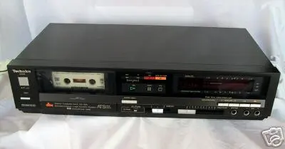

... 2. If I went with one of the traditional stereo cassette decks, I am giving up mic inputs.
What I'm accustomed to as "traditional" stereo cassettes, would INCLUDE mic inputs. These may be mostly older Ebay-type items, that have this feature. One of my favorite searches is Ebay: "Technics cassette". (See: Technics RS-955, below)

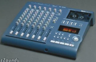

If I wanted cassette and had 1200.00 for everything then I think I would go with a new tascam 424 mkIII. Thats 300.00 Plus it would give you the extra 2 tracks to play with other mics if you want plus with the extra speed better qaulity along with dbx. Also pick up a couple of mxl 603 condencer mics and a ART phantom power supply to power them. Add some cords and maybe some stands and you are still below 650.00 bucks and would have a pretty nice setup. Or look for a nice used tascam 22-2 reel to reel. Now your talkin some nice sounding recordings.
I'd just stick with the Tascam 424mkIII.
It's an integrated mixer/cassette recorder that will do everything you need it to do, in a small, inexpensive package. ;)

The 424mkIII...
The 424mkIII is capable of "recording live to cassette tape in normal speed, standard stereo format, with 45-min of run time on each side",... as your original stated goal. (See notes, above).
However, your best sound quality & production value is attained by recording 4-tracks, direct & live-to-tape, in High speed (in one direction). You'd mixdown and dub to a "normal" cassette or the 'puter for burning to cd, later.

OK! I will move the Tascam 424 MK III back into first place on my list. that's where it was a week ago before I tried reading the manual. I suspect this is one of those things that is easier learned by doing, but after reading the manuals for some of the digital decks, this didn't look all that much eaiser all be it with no menus.
that still leaves the question about getting the recordings onto the computer for buring to CD. If I go with something like the Delta 66, will I need a preamp as well, or do the preamps in the Tascam suffice. Sorry for the typos. Can't edit these messages for some reason .
That is also the reason why I recommended the rather "simple" approach with my original reply. However, knowing more about your expectations steered the final recommendation toward the 424mkIII.
It's (the 424mkIII) really not that complex and yeah, it would be of more benefit to you to be actually working with the unit than reading the manual - except the part about cleaning and maintaining the tape path on a regular basis. ;)
