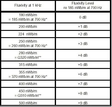

The chart below is from Jay McKnight of MRL. It may shed some light or make things more confusing. :)

Aaahh! Thank you!
That puts it all in perspective.
This morning, I was contemplating scanning my tape reference card & posting it, but you beat me to it! My reference card is a laid out a bit differently, but your level reference nicely explains what we've been talking about.;)
Yup. I actually feel like I have a solid grasp of what the MRL tape is telling me and what my meters are telling me now. I'm sure there is plenty more that I don't get- but as far as this topic goes the various things that were confusing me magically cleared up when I realized the conflicting sources I've been reading are talking about different reference frequencies and opperating levels.
I may not have it *right* but the picture building in my head is at least consistent with what I've learned so far. The odd behavior when the meters went well into the red is because 0dB on my meters (which read 0dB with the 355nW/m 1k MRL tape, or +6 given that the 0dB reference for the machine is 250nW/m) is actually the MOL of the tape. MOL, I'm *guessing*, is the max level for no distortion and the peaks of my test records with *well* above that.
