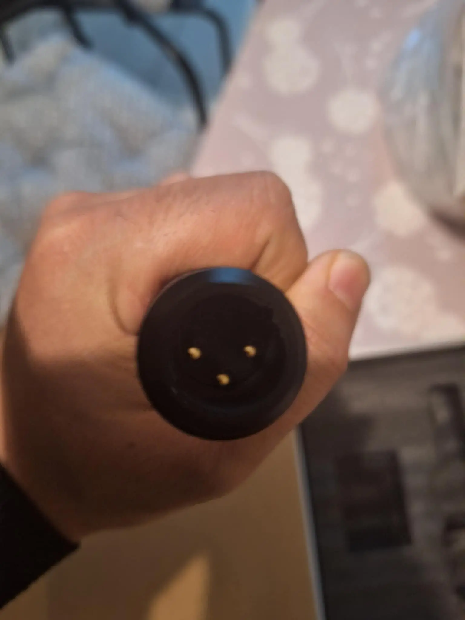

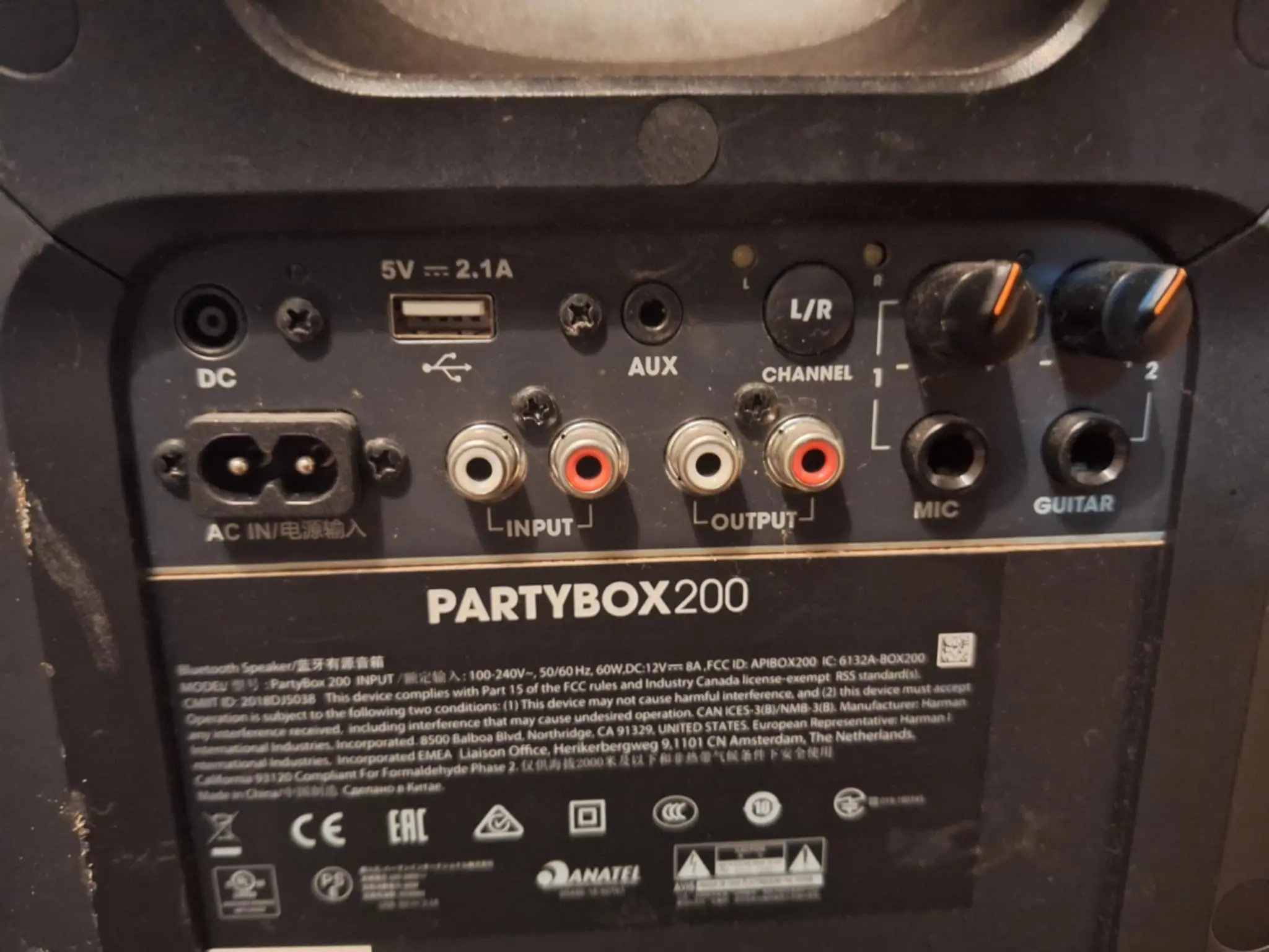

Hi everyone. So I have this microphone Lewitt which I attached in a picture. I also own a JBL speaker called party box 200. I attached in pictures both of these. What I want to do is connect my microphone with the speaker. But the end of the microphone with the three small parts does not fit in the back of the speaker that I also attached. Is there a way for it to connect with the speaker?

Get a male XLR to 6.5mmTRS adapter, and you could be set. I say 'could' because I don't know whether the Lewitt needs phantom power, in which case you would also need a phantom power supply.
What model Lewitt microphone do you have? The MTP 250DM, 550DM and 840DM are dynamic mics and would work. If it is a condenser mic, like the 350CM, then it won't work as it needs 48V phantom power.
I'm going to assume this isn't the LCT440 or 540 that you wanted to by some time back. Both of those are condensers requiring phantom power.

Hello to you all. Thank you for responding. The microphone is 'map 340 cm.' It is a condenser performance microphone. I will look into buying the adapter from the store. I would like to know, does the JBL speaker, 'party box 200' have reverb? The guy at the store said that using a mixer would allow for reverb, whereas he said buying a speaker from the store and connecting the mic to the speaker wouldn't allow for reverb, hence the necessity of a mixer. But if my JBL speaker has reverb, then there would be no need to buy a mixer nor a speaker from the store. Pls advise. Thanks in advance.

It can't have reverb. There is no reverb button, nor a reverb knob.
No phantom either. They don't give phantom on 1/4" jack sockets.

Mics like yours have a 3 pin XLR socket - this is the 'standard' connector. Condenser mics have electronics inside them and need powering. The other common mic is a dynamic - this does not need power at all. The cables don't care at all - as they just get audio from A to B, and also get power if you need it from the gizmo connected the other end, back to the mic. The power is 48V phantom power - phantom, because it's superimposed on the audio travelling the other way. A dynamic mic would simply ignore it, but a condenser mic uses it to power the innards!
Your partybox has an ordinary jack socket so cannot supply power. Cheaper, semi-pro mics have jack plugs - the kind found on cheaper karaoke machines. It also does not have any reverb or effects. Not vital, but also it's tone controls are also a bit limited. This is why people are suggesting a little mixer - tone controls, and extra nice things plus on some, reverb and the all important phantom power. You can buy a phantom power unit, but a mixer is not much more and much more useful - you could then add an extra mic, or play back music or add a keyboard etc etc. Condenser mics will NOT work from the partybox, even with plug adaptors from xlr to jacks - it is very worrying your local shop were clueless on this. It is sort of microphone 101!

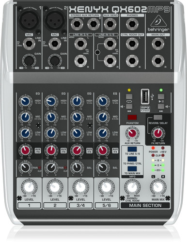

If you're looking to use it for a performance at someplace like a coffee house or restaurant, something like this would probably be preferred over piecing various bits together. It has speakers, the mixer, reverb, and a microphone and designed to be portable. Everything fits together for travel.
JBL Professional EON208P Portable All-in-One Dual Speaker,
That mixer ^ would solve both problems. Has Phantom power and reverb. Behringer kit is not THE best around but I have had several of their products and they all worked well. Many here will have had the same experience. You can pay more for "better" gear from Soundcraft, Allen & Heath, Yamaha, Mackie and others.
I suggest you think carefully about the mixer you get. That Xenyx will take two microphones. Might you need more in the future?
