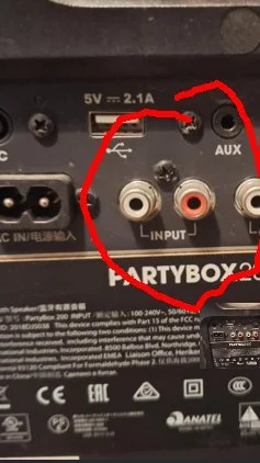

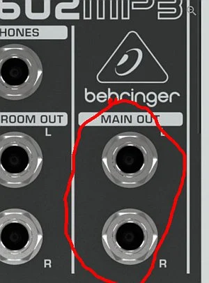

Someone said earlier that condenser mics will not work with the party box, so I am assuming that when you say the mixer would work well with my party box, you are referring to using a dynamic mic. But I don't really want to buy another mic...
No, plug the condenser mic into the mixer. Then you plug the mixer output into the line inputs of the Partybox. You just can't use a condenser directly into the Partybox.
https://www.amazon.com/Cable-Adapte...rds=rca+to+quarter+inch&qid=1738013272&sr=8-3
The big end goes into the outputs of the Xenyx mixer here. The small end goes in here on the Partybox

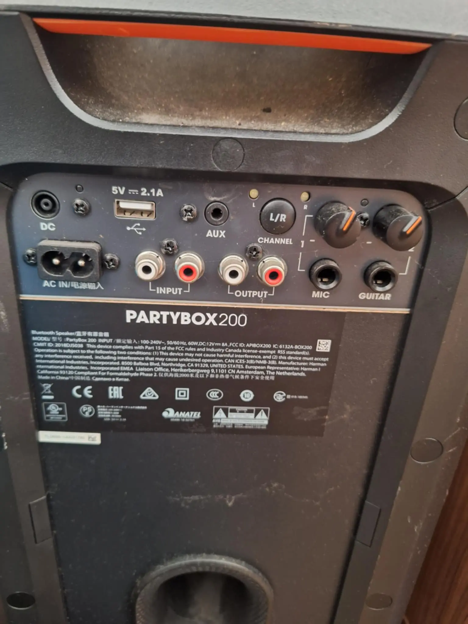

Hello to you all. I need your help again guys. Basically, I bought the mixer and the cables. The guy at the store gave me the cables for the mic and guitar options on the back of the jbl not the input option. Which one is better, and lends for a better sound? The guy at the store told me to try the cables for the mic and guitar and if they don't sound good to return them and get instead the cables for the input option. What do you guys think? Thanks in advance.

So you have a mic with a ¼" unbalanced plug on the end, and the same for your guitar.
Your input sockets are to connect a stereo source, via the RCA phonos - do you need to do that? They won't take a microphone, and pretty much all guitars have ¼" connectors - so you are done.There won't be any quality differences, you just have scope for plugging in an old CD player, or maybe ipads, that kind of thing - plus you an hang a recorder on the two output sockets. If, on the other hand you want to use the mixer - you need stereo cables from it to the inputs. We thought you bought the mixer already?
You can plug your mic and the guitar into the mixer and the mixer into the speaker. If you didn't buy all the cables, you'll not be able to try it? You need 2 x ¼" to 2 x phono(RCA)

Hi there. I'm only using the cable for the microphone with regard to the mixer and the input* on the speaker. I am going to use the amplifier that I connect my guitar with for guitar sound, I don't want to connect that too, to the mixer as my amplifier sounds great as it is.
When you say a stereo source via RCA phonos what do you mean?
I am going to use the mixer to bypass it seeing it is a compressor microphone that will allow phantom power and reverb too.
When you say, if you want to use the mixer, I need cables to the inputs, are you saying that since the mic and guitar inputs on the speaker, will not do the job? I can easily trade in those cables for the input cables, on the speaker, as I have not used them. Thanks in advance.
If you are coming out of the Behringer mixer for your microphone, you need to a 1/4" to RCA cable. I put a link to the type of cable you need in the post #26 above. You don't want to be plugging the mixer into the mic or guitar inputs.
If you have a guitar, you could use your regular guitar cable to plug THAT into the partybox, but I have no clue how good it will sound. It would probably be good for an acoustic guitar, but sound anemic for an electric guitar. Most acoustic guitar amps are full range systems, sometimes with a chorus, where as electric guitar amps are designed for a limited frequency range and provide things like reverb and distortion.
You're talking about a $12 cable, so it's not like you are dealing with high dollar stuff. Order the correct one and move on.
If you are just using the speaker to hear things. Its just far easier to have the mixer do all of you mixing and effects.

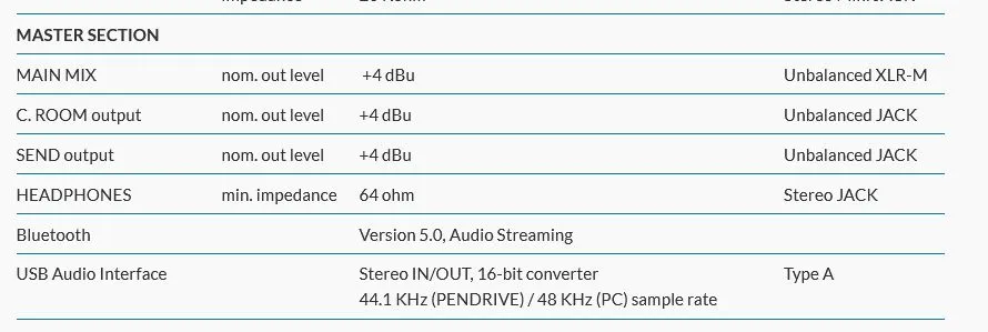

OK - scrub our advice then. Your mixer has ¼" jack outs designed to feed the monitor speakers so you can turn them down without impacting your recording. You can use these output to go to the speaker ins. You confused us, so I guess the store guy was confused too. Have you actually tried it? Because you might have cables that will fit? A guitar cable will go from the mixer to the speaker, and you might have an XLR to XLR for the mic?

In the case of the Proel, you would know that you could use the Control room output just like from the Behringer with a 1/4" to RCA, or you will need an XLR Balanced to RCA unbalanced cable.

Like I said earlier, I let the guy at the store choose the right cables and didn't have a say in that. I thought he would cover me.
Yes the cables are xlr. It says so: 3-XLR+6.3mm M
He said to connect both wires to the 'mic' and 'guitar' input to the right of the JBL. This is for the microphone, nothing to do with the guitar etc, as opposed to going directly to the input option for both wires. My initial question was whether it is better, sound-wise, to get wires for the input aspect and not use the 'mic' and 'guitar' option. He told me to try it the way of using mic and guitar and see if it sounds good, if not, to return them and get the wires for the input aspect and use the input aspect instead. I haven't tried it out yet because I've been sick with the flue. Thank you guys.
This is precisely why I said it would be worthwhile to learn a bit about basic electronics for audio. The outputs of the Proel are line level signals. This is the spec from Proel's website. When you see something like +4dBu, that tells you the signal is 1.23v reference level. That is line level. A microphone such as used with the Partybox will put out some thing like .01 or .02V and the input is designed to amplify that. Feeding it a signal that is 100 times higher is bad.
The RCA inputs of the Partybox are rated for 0.5V. so you are much closer to the proper level. Simply lowering the output will give you a proper signal strength.
The guy who said to go from the output of the Proel to the mic and guitar inputs is a flake! Simply put, he's completely wrong.
Get the proper cables and hook it up. Then give it a thorough testing to make sure you have good levels, and that your recording setup is correct. The last thing you want to do it to get to a venue, and plug things in only to find that "it don't work like that"!
