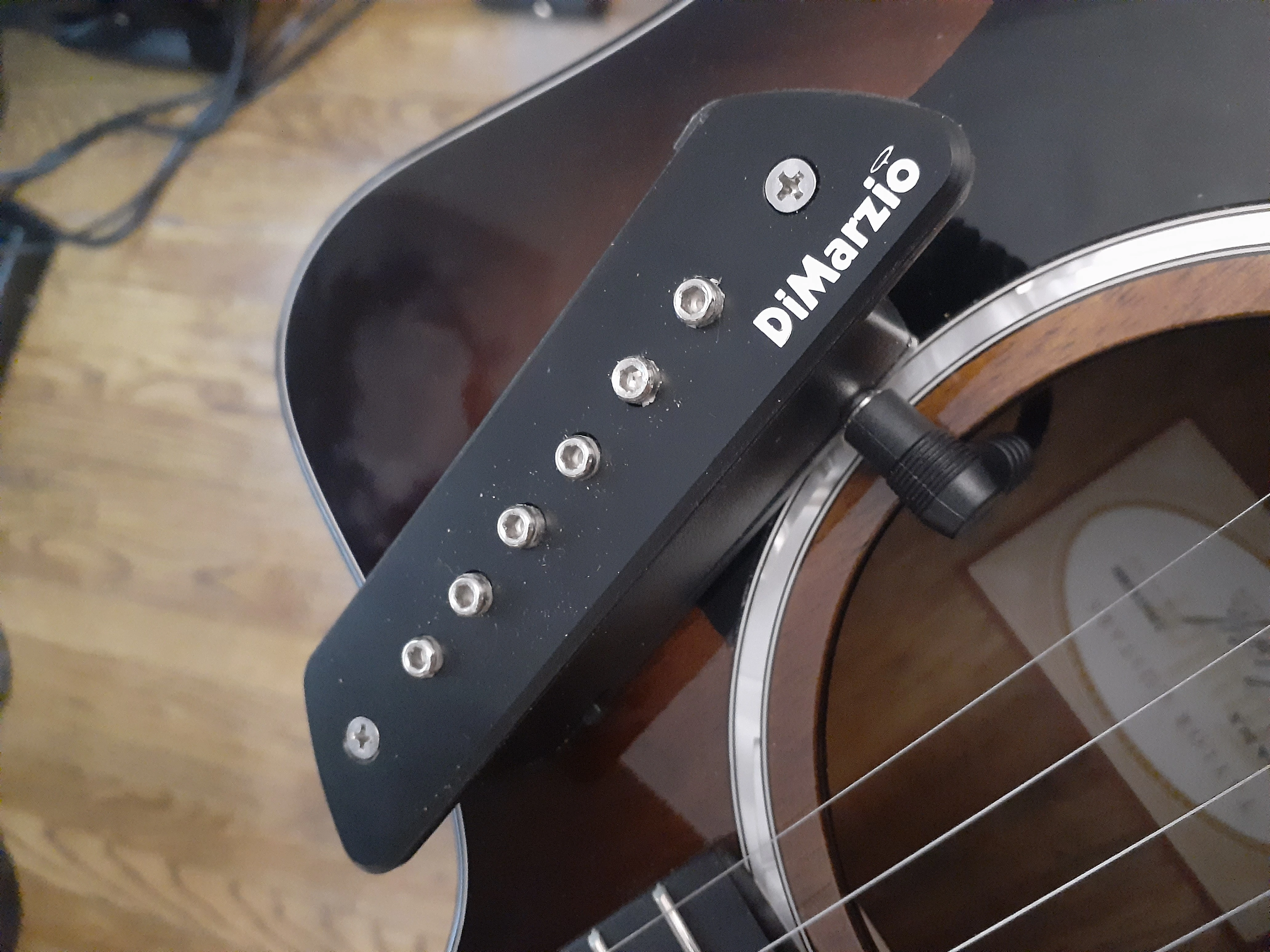

Its an acoustic guitar with a dimarzio acoustic sound hole pickup. Its a great sounding pickup just getting this issue. I can place the sheet metal somewhere else. where should i place it? I would have to take out the pickup and test putting it behind it to see what happens. The sheet metal is too big to fit behind the sound hole at the moment. I would have to cut it down. Let me trying taking it out and test that.

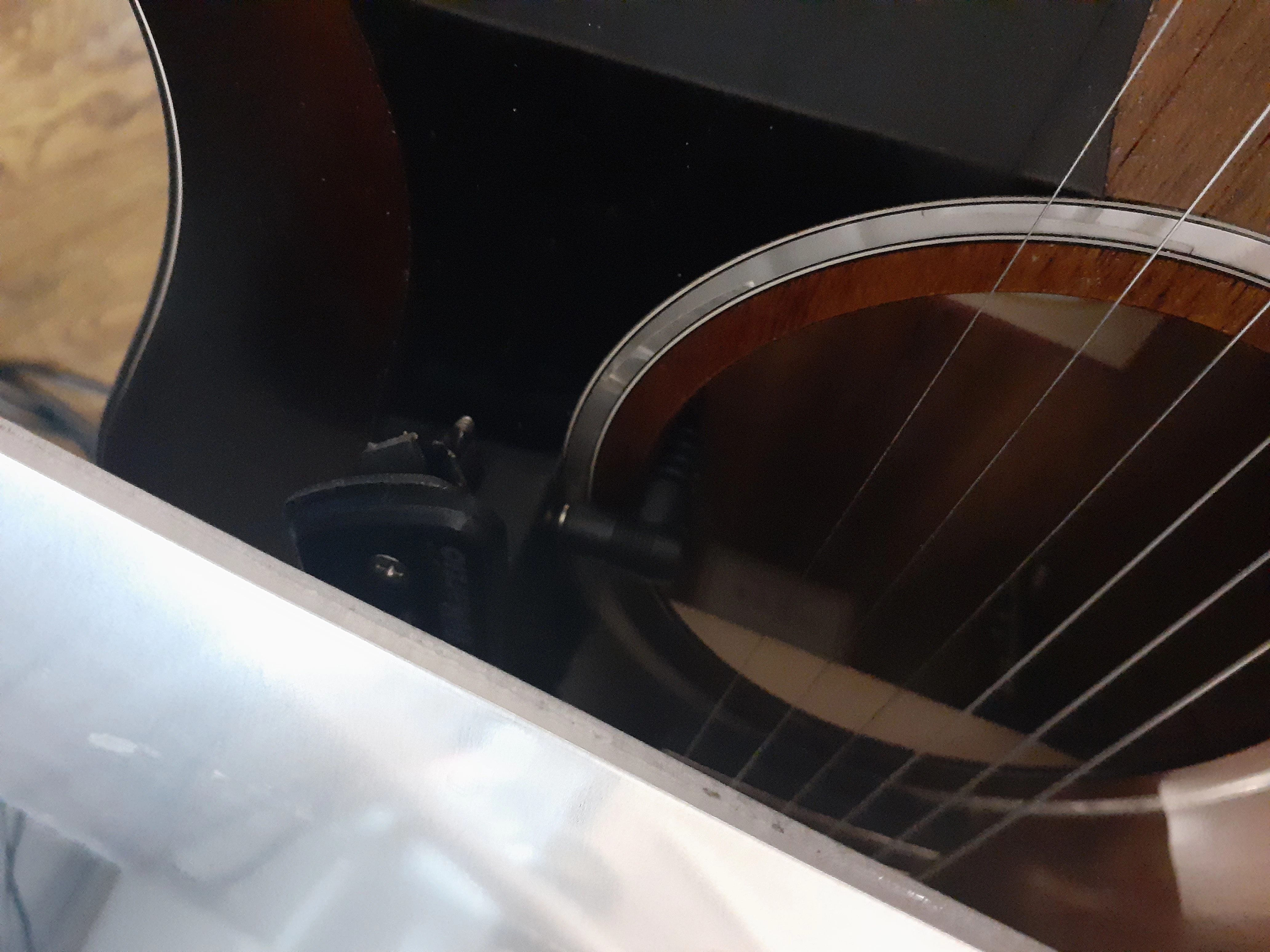

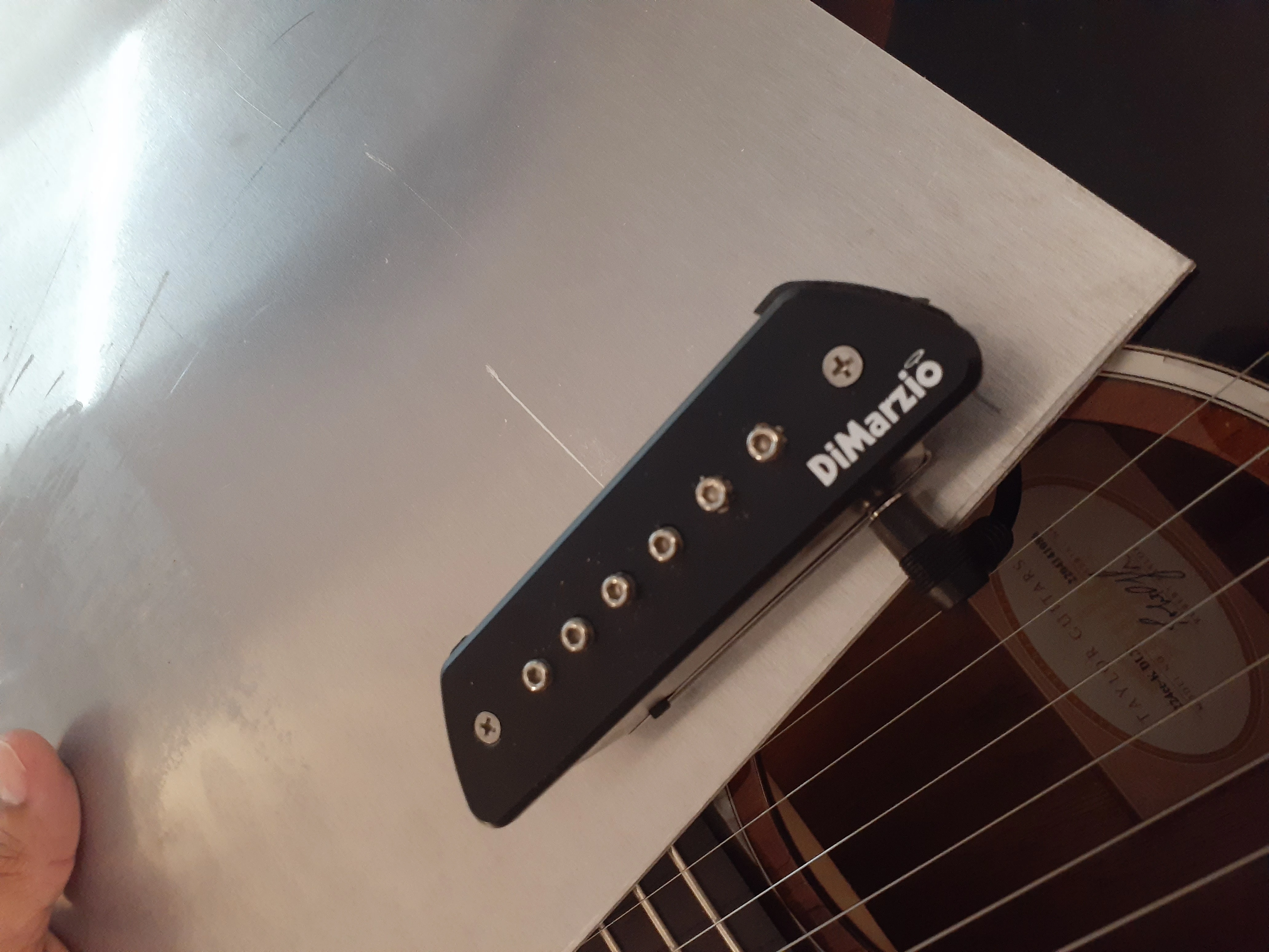

I tried under the pickup and didnt have the same effect. When the sheet is over top of it is when it stops the noise. When i disconnect the 3.5MM plug it just does the normal buzz like any guitar cord would do when disconnected. when connected i put the shield over the string path and the buzz still happens. the sheet really only works if block the front of the pickup it self it seems.

i hear what your saying on the size of metal. I was thinking i just do the back wall that my guitar faces when i record about half way up as it seems to stop the noise when i place the shield in between my guitar and the wall. its about 6.5ft by 5ft area. not too big. I think if i did that little piece it will help alot. Just a hunch though i would have to test that. If that works, i would probably cover a small portion of the adjacent wall as my rig is tucked in a corner.
Again i can rotate the guitar and it drastically goes away but still hear remanences of the noise. with the shield it goes away completely. Turning the guitar sideways the noise seems to sneak in through the side of the pickup somehow. Also I rather block the sound than having to rotate uncomfortably to reduce the noise. when I'm recording for hours on end i want to be comfortable and know that i dont have to have the guitar in a specific spot. That is tremendously annoying when you are trying to get a take down.
