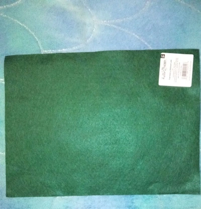

I went to Wal-ly world and picked up a small, thin sheet of green felt. They had all colors and I think this hunter green looks best with the Taylor's wood.

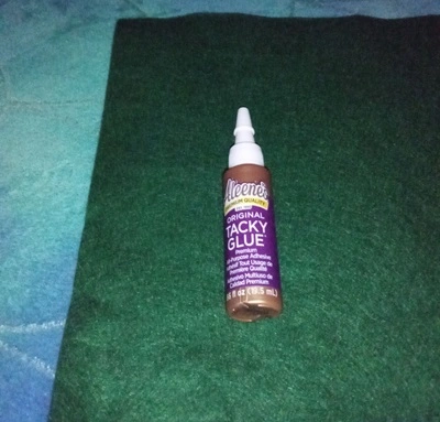

Then I scooted over to the next aisle and picked up a bottle of Tacky Glue. The online description says it can be repositioned but the bottle says it's permanent. It was less than $1, so I bought it with the idea of experimenting on different surfaces to see if it was suitable.

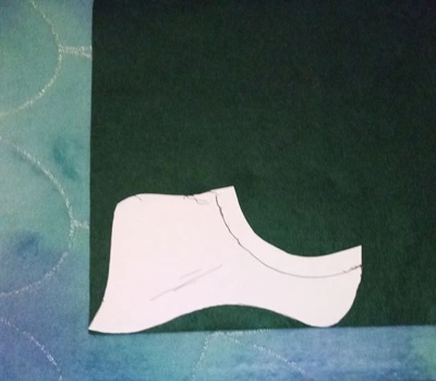

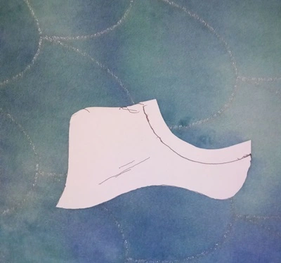

I took a sheet of copier paper, laid it over the pickguard and traced the outline with a gel pen. Then I cut it out, adding about .5 inch to the inside curve of the soundhole because the pickguard stops that distance from the hole. This will allow it to cover up to the edge, and maybe a hair over the soundhole when finished.

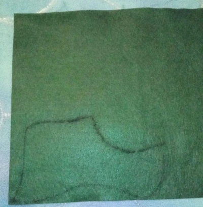

I laid the cutout template over the felt sheet and traced the outline with the same gel pen.

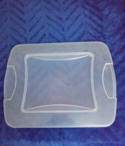

I cut out the felt, staying just proud of the lines. Then with a scrap piece of felt, I tested the adhesive on the pickguard. I applied a single drop to the felt and gently pressed it onto the pickguard. I let it sit for 2 hours. It pulled off easily but the adhesive hadn't fully set, so there was a loose pasty gob left on the pickguard which wiped off easily with no residue. Not wanting to just apply adhesive to the whole felt and apply it - letting it sit overnight - not knowing how it would turn out, I experimented with other surfaces. The first was the clear plastic cover of a package of 9V batteries. It's very smooth and, hopefully, not porous. A small piece of felt with a single drop of adhesive was placed onto the clear, flat surface and left to cure for 4 hours. That worked perfectly. Peeling the felt off revealed a nice, clear, flat pad of adhesive on the felt and zero on the plastic. It released easily, was tacky and when reapplied, it adhered nicely. BINGO! Then I needed to find a similar, much larger surface which I could use to apply the whole felt cutout. I found the lid of a small Sterilite storage box was just the right size.

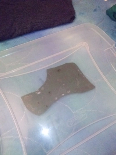

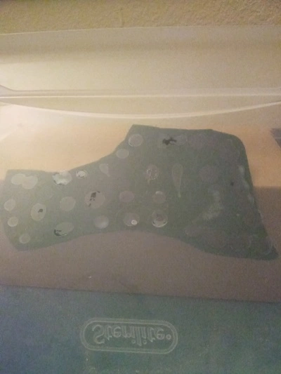

I wiped the lid surface with plain tap water, then dried with several paper napkins. I applied adhesive to the back of the felt cutout - some perfect dots, some uneven strips - and placed it on the lid, gently but evenly pressing all areas.
Continued from Post #8

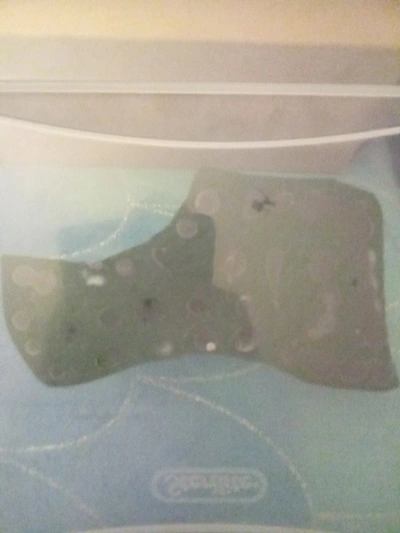

This time, I left it overnight - 12 hours. Before removing, I flipped the lid over to examine the adhesive spots. Some were visible, some not so much. Most of them dried clear.

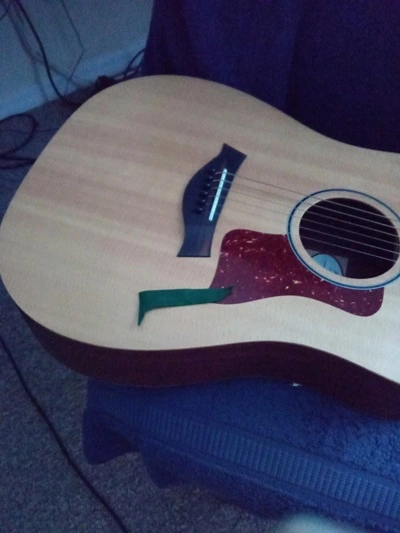

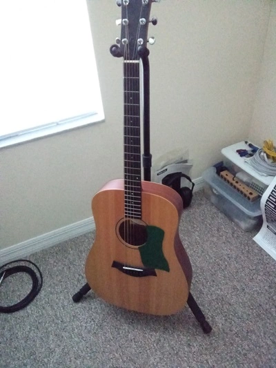

Looked good to me, so I carefully peeled it off (released very easily) and placed it over the Taylor's pickguard. It adheres beautifully. Perfectly tacky.
I played around on it some and didn't get any pickslap or loud 'tick' noises. I could feel the felt as the topside of my strumming fingers stroked across on downstrokes. The only problem I might possibly have (maybe) could come on some returning upstrokes. Going down, my fingers and pick go beyond the edge of the felt and coming back up may (or not) catch the edge - won't know if this will tend to pull the felt away or not - we'll see. I can always make another which extends lower.
