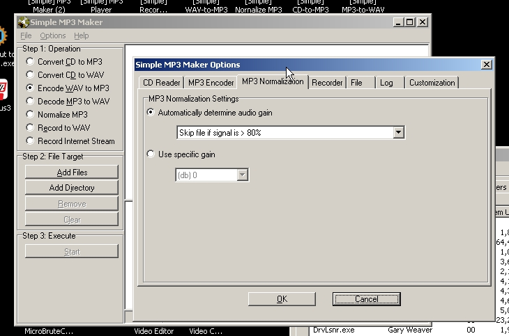

I have used built in export and conversion options to target a level before. Hard time remembering where. I think I last saw it in foobar and Ardour ?
This is a really old utility I still use;
