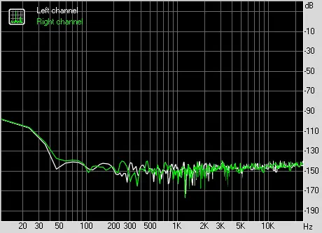

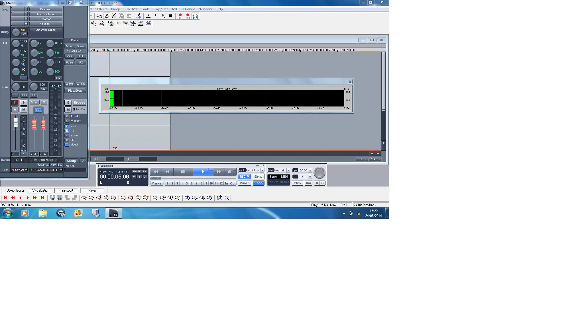

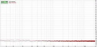

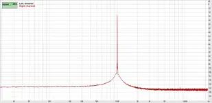

Ok,
Attached is a record/play noise plot for the KA6 done in Samplitude SE8. 24bits 44.1kHz and all gains were at minimum, inputs open circuit.
You can "calibrate" the plots by the internally generated tone at -18dBFS.
There is also a grab of the Samplitude meter. I have had to tweak the gain by ~2dB because the range stops at -90dB . The actual rms noise is: Left -102, Right -101 and these are of course unweighted figures.
These recordings were done on my HP i3 W7/64 laptop but a quick check on a W7 64 bit desktop showed the same results.
Of greater importance to me, more so than the low inherent noise, is the total absence of artifacts. Very commonly with cheap USB devices you see spikes popping up all over the shop!
Dave. Right! You've seen mine. Let's see yours!!!

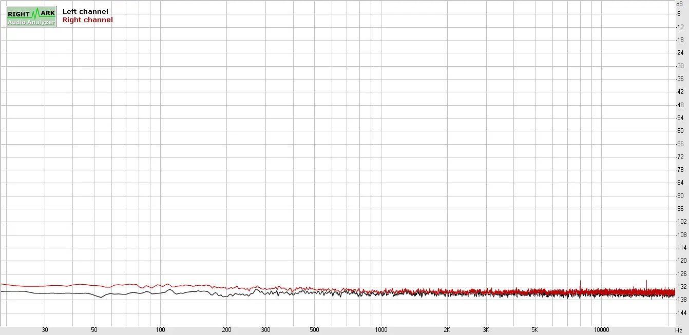

Here is a Spectrum, but i simply chose that i wanted to record from my soundcard (with nothing connected to it's input), and saved the graph in RMAA.
That's what I wanted! See, if I play your audio file on my system I add my system noise to yours , gets us nowhere!
Except! In this case your spectrum, whilst being an average 3or so dB lower than mine is very spiky. Then I wonder why you have that steep rise above 50Hz?
Anybloodyway! It is clear that the KA6 has a comparable noise floor to the SB and a damn sight smoother!
Well can't you just analyze the digital file?
Cause now, i just clicked "Record" on RMAA, but never recorded anything at all, just copied the Graph. But well it should yield the same result i guess?
I can't read hertz and db, or rather spiky vs smooth doesn't tell me anything in reality.
But as it's below all other noise, does it really matter?
And for the 50hz thing, i have no idea, i actually thought that was normal, that 50-20hz was harder to "maintain" or something.
I use Google Drive, but it's a bit less user friendly when sharing files;P
"I can't read hertz and db, or rather spiky vs smooth doesn't tell me anything in reality."
No matter. I think the important thing is the tests show that the KA6 is at least as good as the SB and I would say better.
