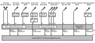

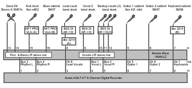

Jason mages some excellent points, none of which I disagree with. But if you're looking for guerilla recording live it *can* indeed be done with 8 tracks on a budget in an extremely portable form factor with suprisingly decent quality if you're willing to do some submixing on the fly.
I have done this fairly regularly for about 5 years now using a single 13-U rack on wheels with a Mackie 1604VLZ mixer, an ADAT XT and some common live use microphones. Substitute your 1/4" for the ADAT and you could do the same thing. Attached is a basic schematic diagram of how I lay it out for a typical rock band.
G.
A very long time ago, I worked on a Mackie and a tascam 16 track. It worked out well, the two complemented each other.
If you want to stay with 8 tracks, I would still try to get a 12 or 16 channel board (like Falken said) because you will need more inputs than tracks. Biamp and Tascam made decent boards that aren't too expensive now.
The minimalist thing messes with my way of thinking. I normally have at least 10 mics on a 5 piece kit, going back to 8 tracks for a whole band would make my eyes bleed.
easychair said:
Glenn,
Just curious, why DIs on the vox?
I was wondering how long before someone would ask that...I judt didn't think iit would be that fast! :D
The only reason the DIs are there is so I can split the signal to send one line to the PA and another to my recording mixer.
This layout also assumes no FOH to tap off of.
G.
G.
