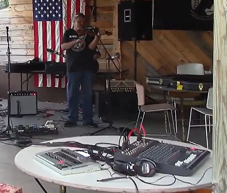

I've used my Zoom R24 to record the instruments and fed the vocal mixer to the 8th track many times. If I was doing more, I would be looking at the Tascam to handle everything in one package. I like the layout as it's like having a mixer that just happens to record all the tracks.

I haven't used the Model 24 personally, I run a Tascam 16x08 at home which has 8 mic inputs plus 8 line inputs. That's been primarily just me or a friend recording. When I've gone mobile, it's with the Zoom with an old Yamaha MX 12/4.
The audio quality the most recorders today will be very close unless you are overdriving the inputs. When run clean, as you should be doing, you'll find that most are going to be quiet and flat +/- tenths of a dB. There are several videos online of people using the Model 24 to record an entire band. Comparing my Zoom R-24, Tascam 16x08 and my old Yamaha AW1600, there was very little difference between the three at 44.1/24bit except for a bit more noise on the Yamaha. I get WAY more difference between microphones.
