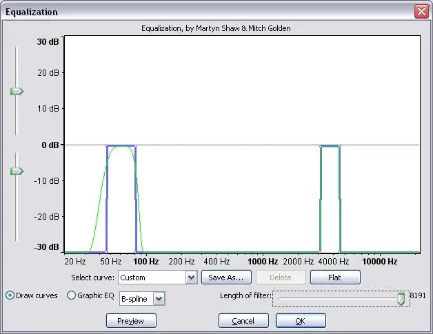

Hey, here a rookie question, " i just brought out all frequencies except 60-80Hz, and around 3-4kHz." how do you do that in para - can you send a pic of that or something... I always see reference to that for EQ, and I am not sure what to do...

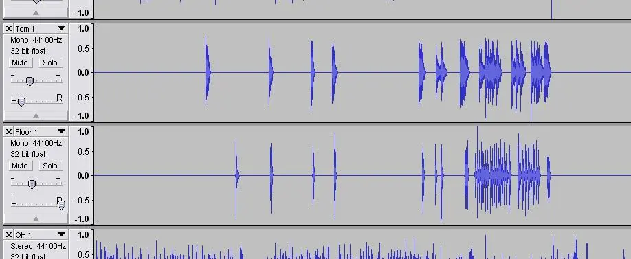

Also, how did you remove the bleed manually on the toms?

Here you go...
In audacity you can't delete parts of tracks... Also you wanna fade in and out each part of track so you don't get any glitches
That is very laborious to fade in and out on a track link that... but, I guess normally the toms aren't really that active.
Is the first pic showing how to use certain areas for the EQ? I can not see how that would work in Sonar.. but, I will take another look
That pic was taken of the para eq in audacity. I'm not sure how it'd look/be done in sonar. Why not just use a graphic, and take out all freqs but the ones shown?
And yes, it is very laborious...
