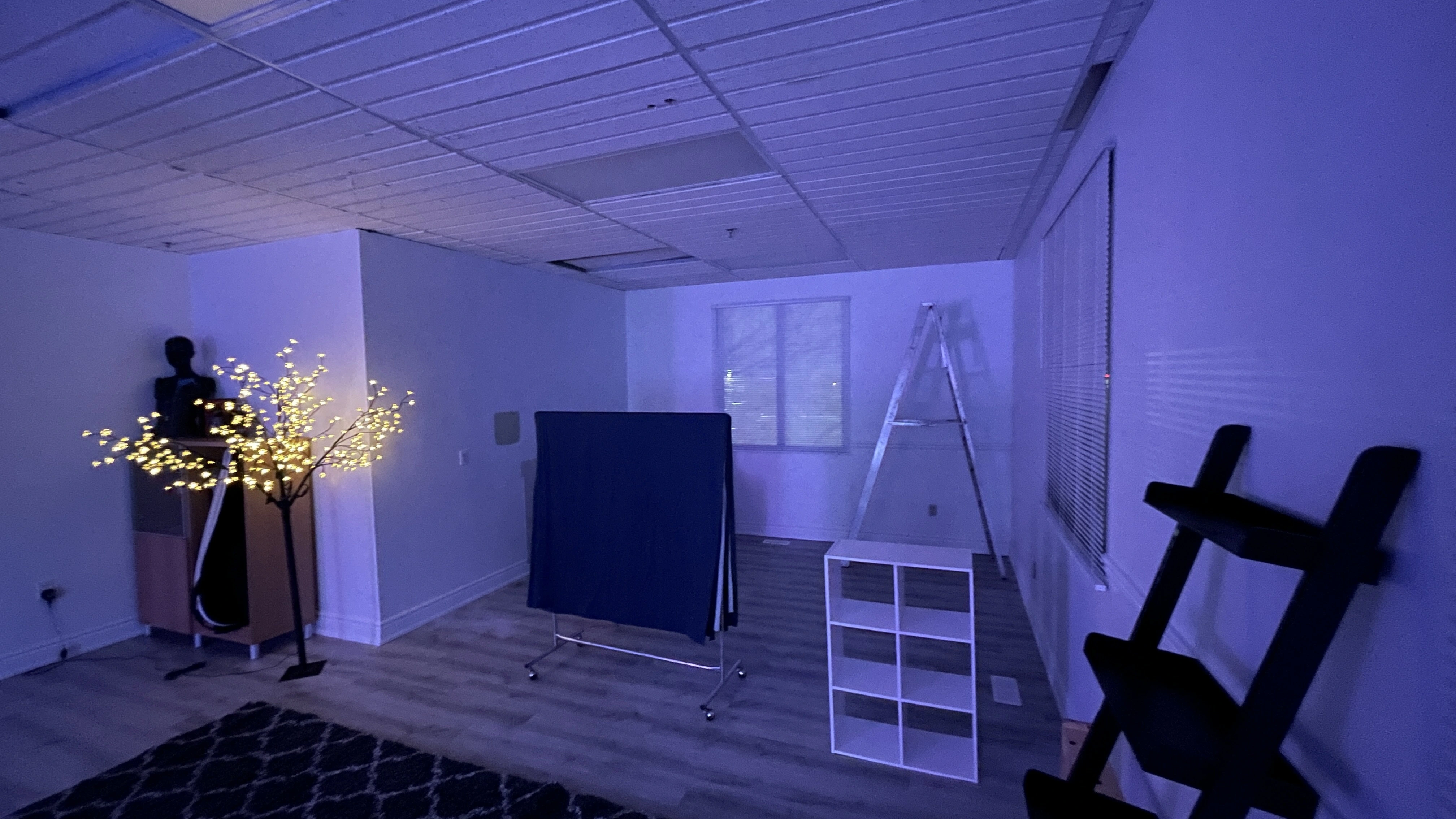

I’m in the midst of building a studio. I’ve got just under 800 sq ft with 9ft ceilings, laminate flooring and a mostly rectangular shape. I’m doing what I can with baffling and such and plan to use a calibration mic in the next couple of weeks to fine tune reflections. I’ve built a few gobos and can build more as necessary.
What I’m after with this post, is info on how live rooms in the 60s and 70s were set up. I’m not super interested in the super clean (some, like myself, might say sterile) sound of modern recordings. I want character and controlled mic bleed. Not necessarily a Motown or Abbey Road sound exactly but definitely in that “world,” so to speak.
I did some searching just to see if I could find some info on how some of these old rooms were set up but useful results were quite limited. I know that I’ll probably need to build a half height wall (I’m thinking like 4’ high) to separate the bulk of the drum sound from the rest of the room but what else should I do?
Here’s the space:
There is some room (13’ x 10’) behind the camera in this shot, and I am planning (read: thinking about) building a wall here and making a dead room for vocals:
So. Do any of you have tips on how to design this space for the vibe that I’m after? What would you do if you had this place? I’d also be very interested in any videos or photos of 60s and 70s studio live rooms that you might want to share.

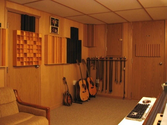

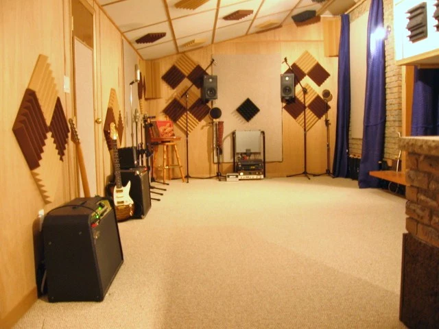

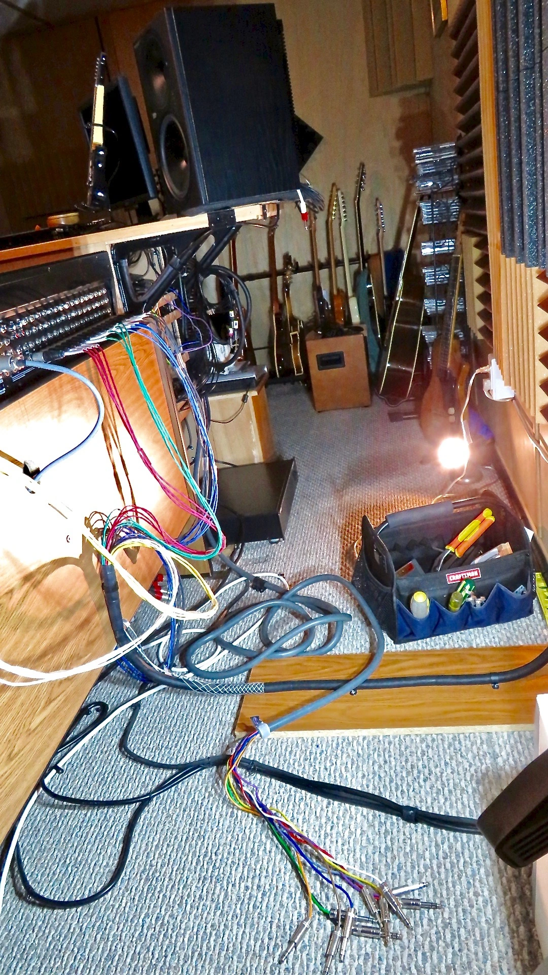

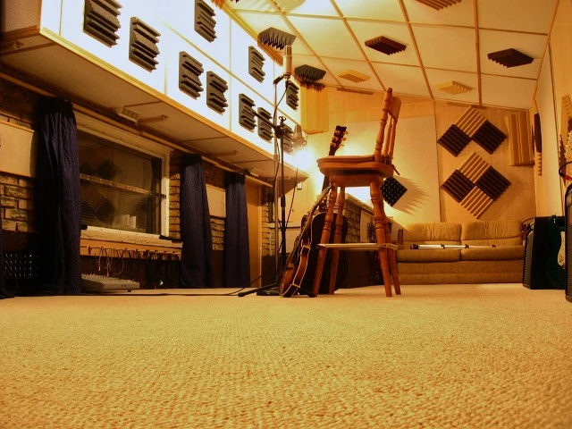

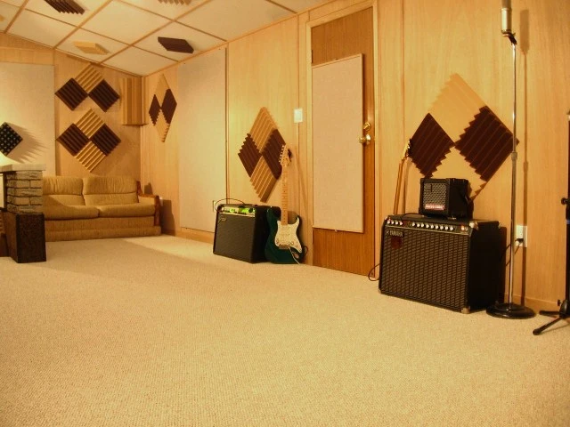

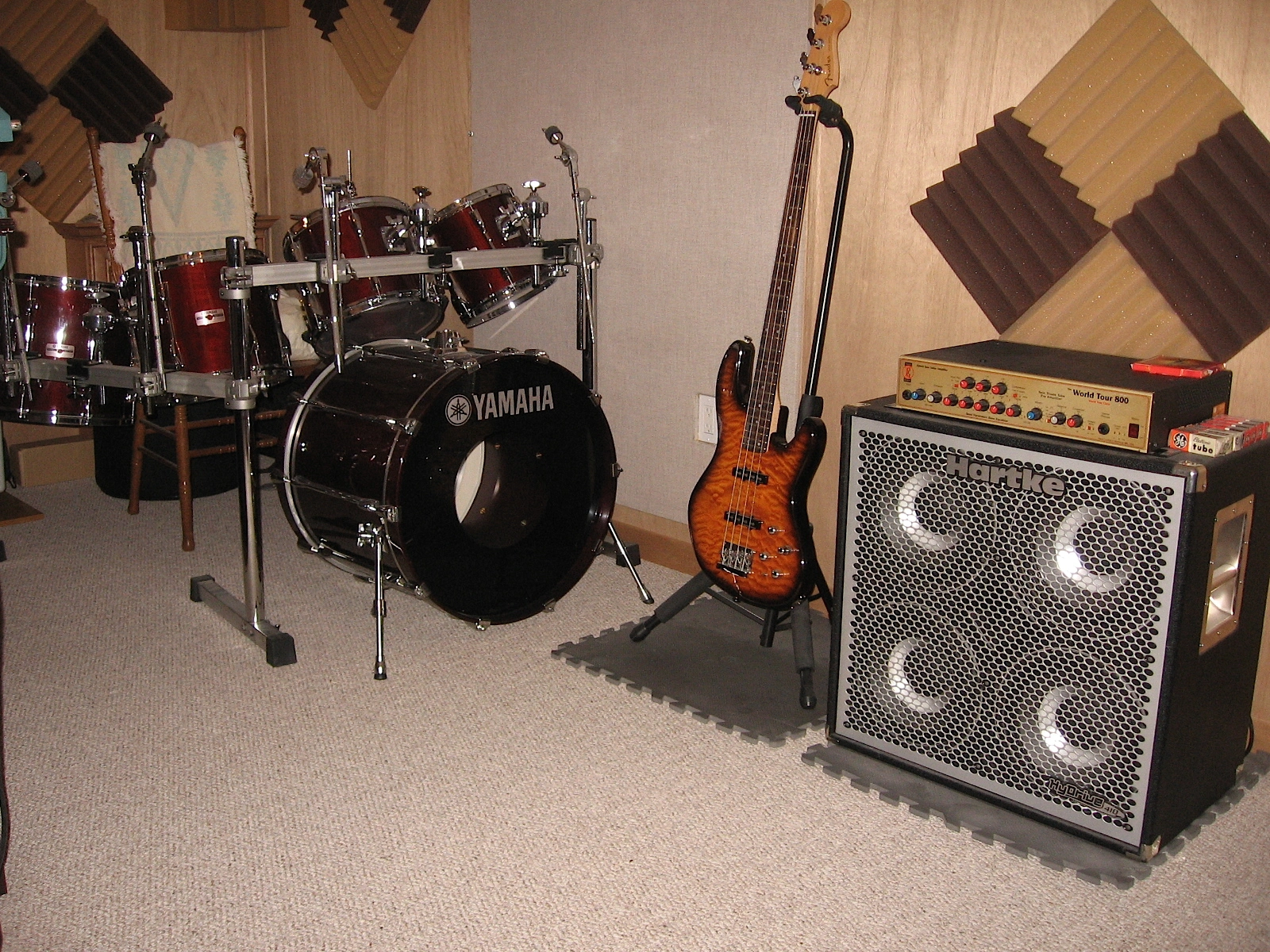

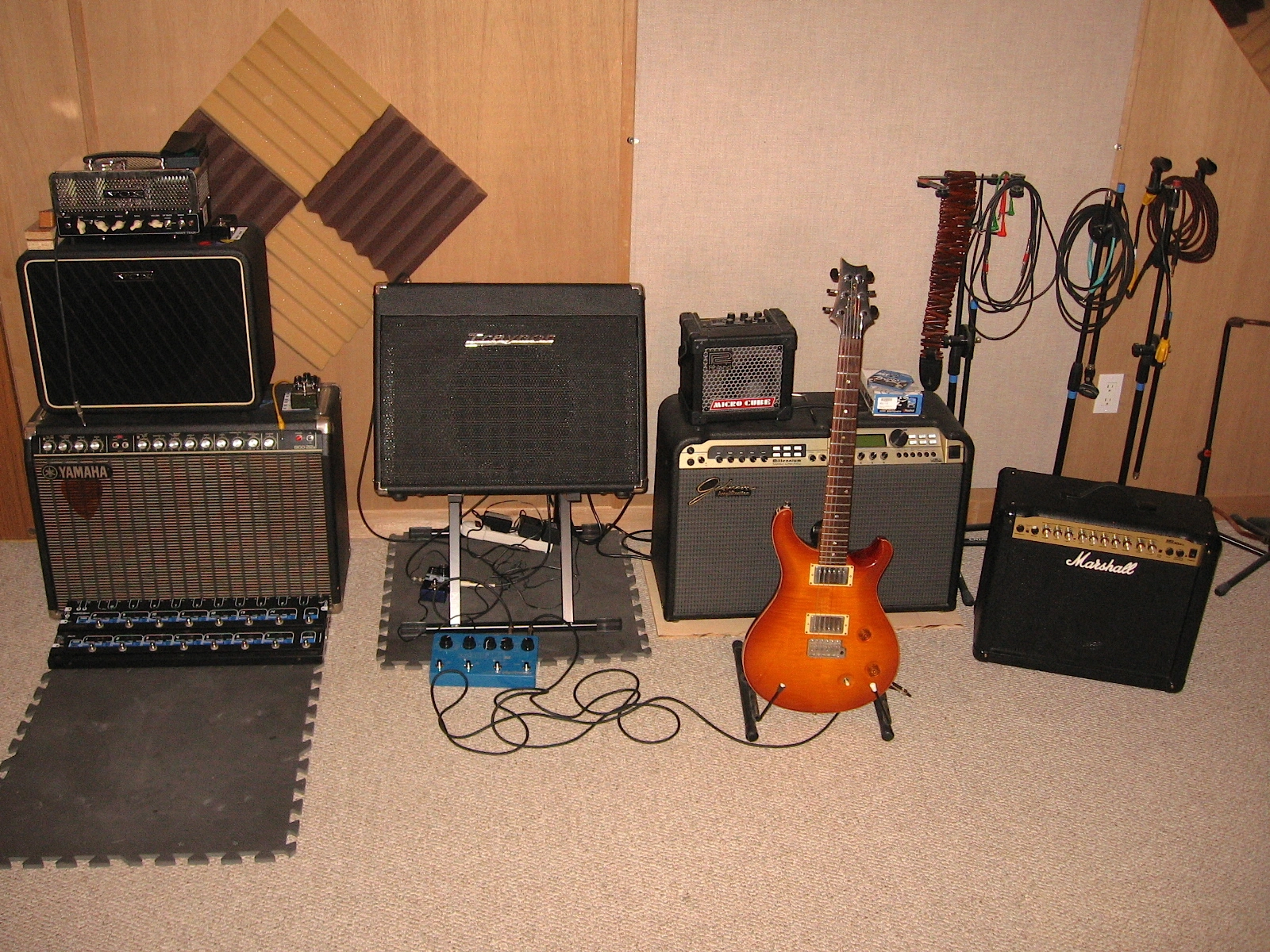

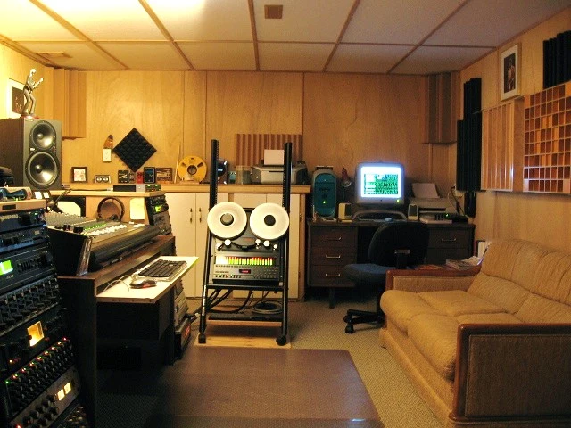

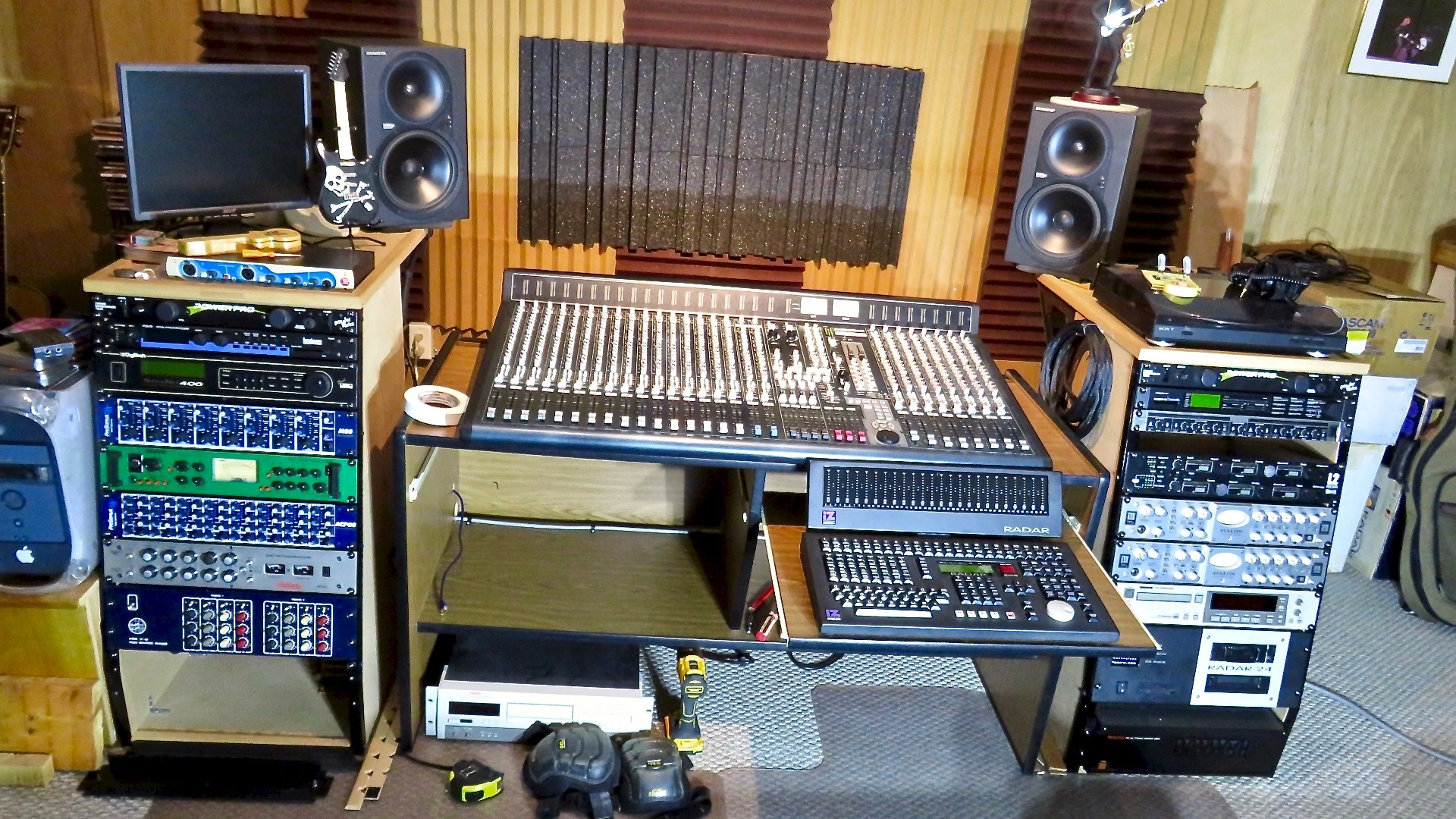

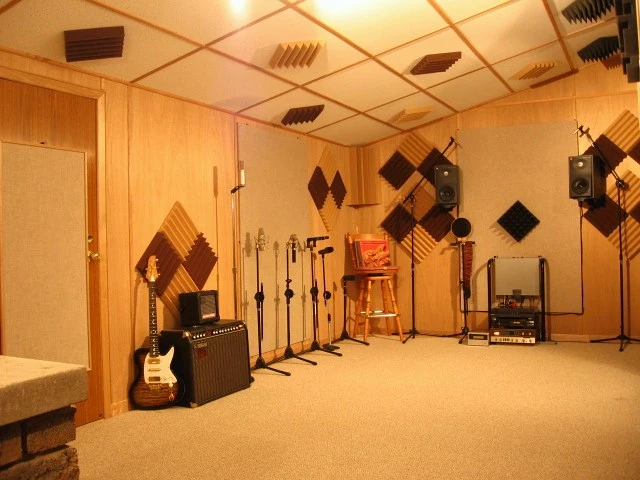

I built my studio live room around 2000 and it is based on the type of vibe I think you are looking for. I also incorporated the possibility to have 70's dry vibe or more lively reflections by utilizing the brick surfaces by pulling back the curtains covering them. I also made some 4'x8' hardwood floor coverings to lay over the carpet when going after more natural reverb for drums and other instruments when required. So the room is actually very versatile and produces various vibes that suit the requirements of different musical genres.The control room is based on the LEDE(Live end dead end) approach which works fine for my needs.
Here's some photos and videos of my build that may help you in your construction.
Control room gear upgrades currently being done.
@TapeRoll - that is pro level. It looks like you have a good visual vibe with thought out sound treatment.
I think one has to also remember the visual vibe. How does one feel in the room?

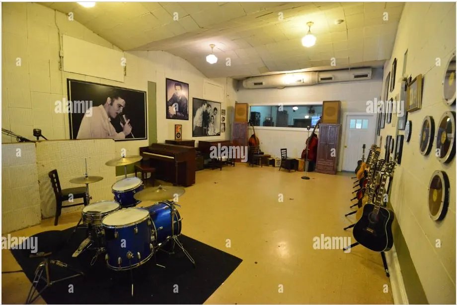

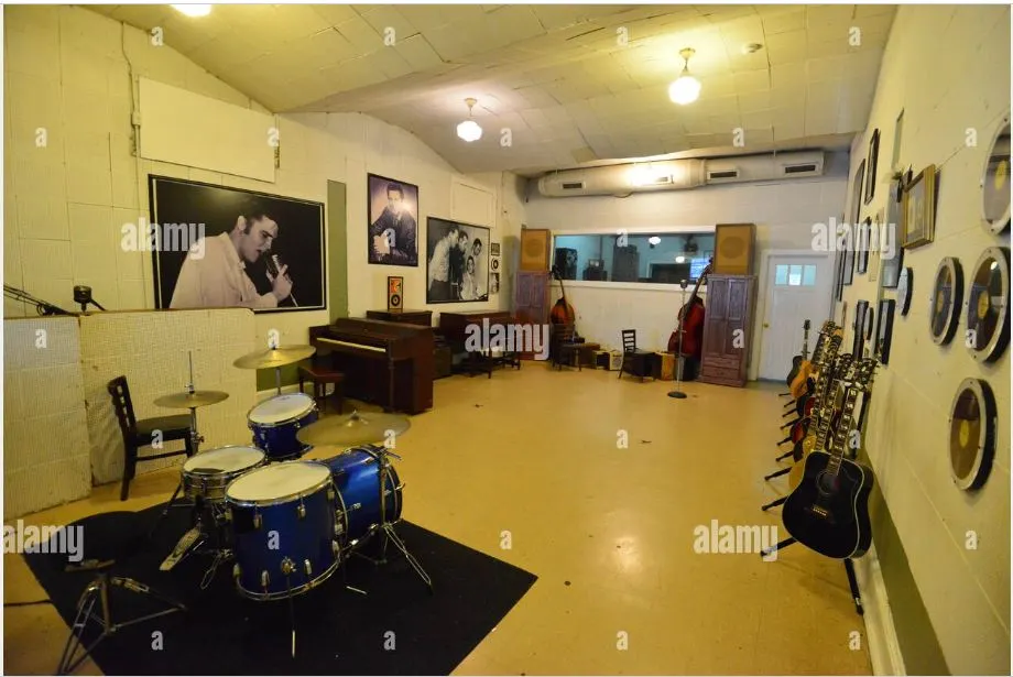

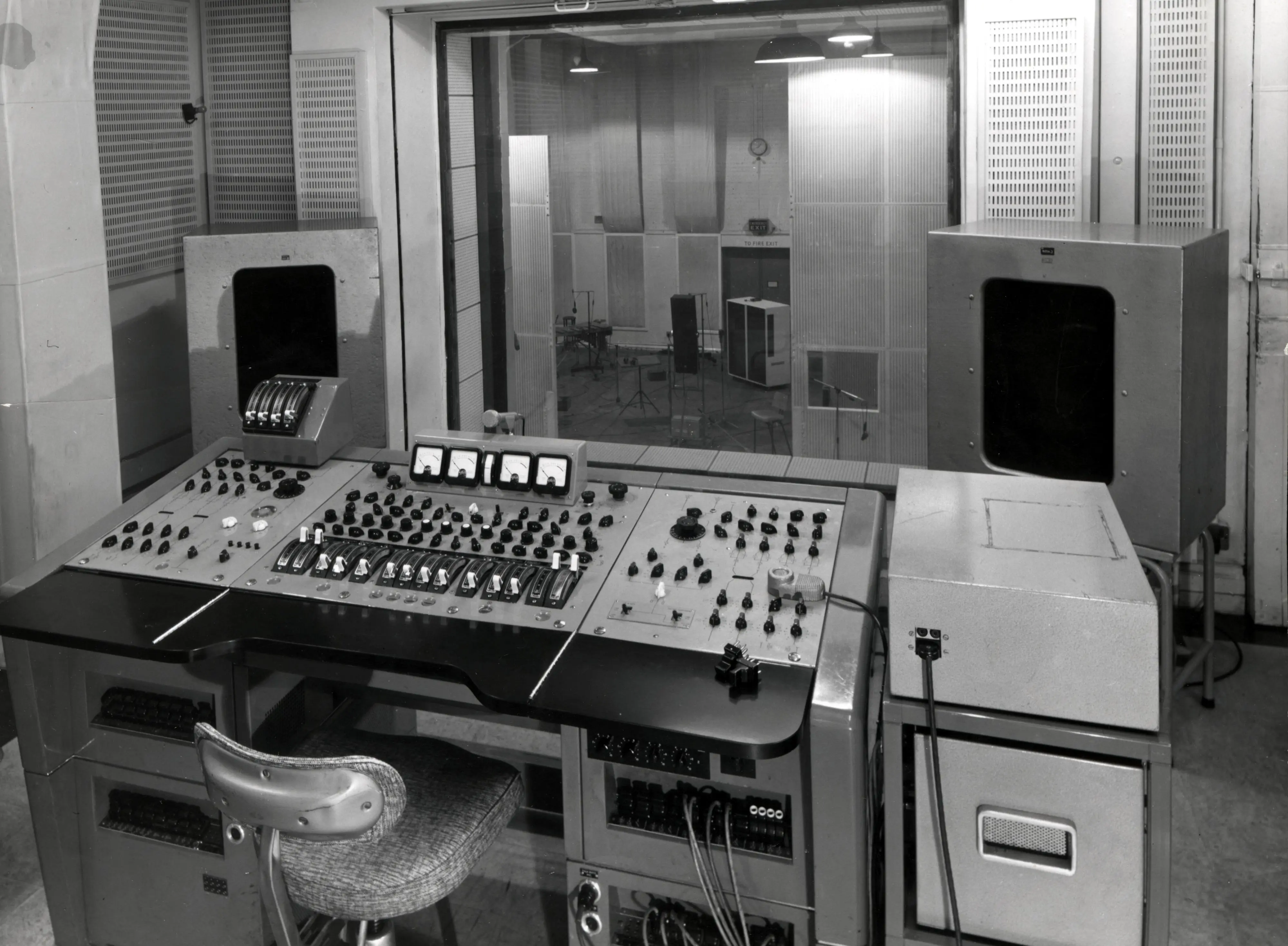

the Sun shots are interesting and small, theres some Motown pics online showing a crowded little room too...a lot of music made.
