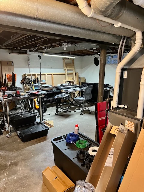

So after reading all of your responses I realize my imagination sometimes is waaay bigger than reality. I was excited that I had a 25' blank wall which aligned with the idea I wanted to see all of my selves playing at the same time. So the first problem and first question. I have a Furnace/AC in the center of my basement, this means at the center of that 25' wall I have about 8' distances between the furnace and that wall, however (let's call it the West side of the basement) in front of the furnace I have roughly 15' that can see the length of that wall but that furnace will be in that scene, so in a nutshell, maybe 10' would see the wall without the furnace and then some options outside in my yard like against my garage.
Question, Lighting, are we talking about indirect lighting, shielded lights I can hang between my jousts?

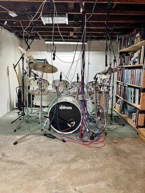

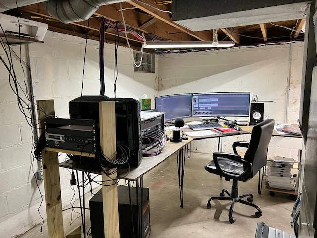

So the picture the right shows if I step forward a bit I have some depth however off center. the full kit and wiring was just to get the cabling semi where they are needed

The thing with green screen is that you must think in two ways. 16:9 or just portrait. With the drums, they create shadows, so they need to be further from the wall, so think how you will get light behind the so the screen is lit evenly. Your height will be your prime issue. All you need to do is adjust the camera distance to max, so there is green on all sides, and of course the floor. You can use a green cloth on the floor, although i have painted my floor. You can try lights from the floor behind the kit where they cant be seen by the camera. You can do what you want in that space. Height is always an issue, and i have a route through dangling lights in my studio, because i have similar height to you. All you need is green on all sides of you and then you move that image to the right place.
The chrome drum parts are going to reflect the green too.
Nice drum kit!
