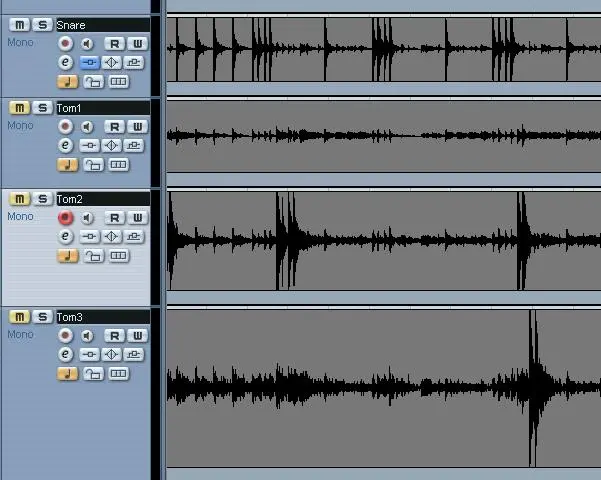

Wow! Those tracks are WAY bad! Sorry. :(
There is more highhat in the snare track than there is snare. You need to post some pics of your mic setup, and we can help with that. That's where a lot of your phasing problems are coming from as well.
Here is a pic of some of my drum tracks. Notice the clearly defined snare hits. The Toms are the same way. There are No tom hits in the Tom1 track -

That's what i was saying. You bring down the OH and you've still got too much cymbals n hats, lol. Btw i was using audacity to mix, so obviously i was very limited. What cubase is that?
