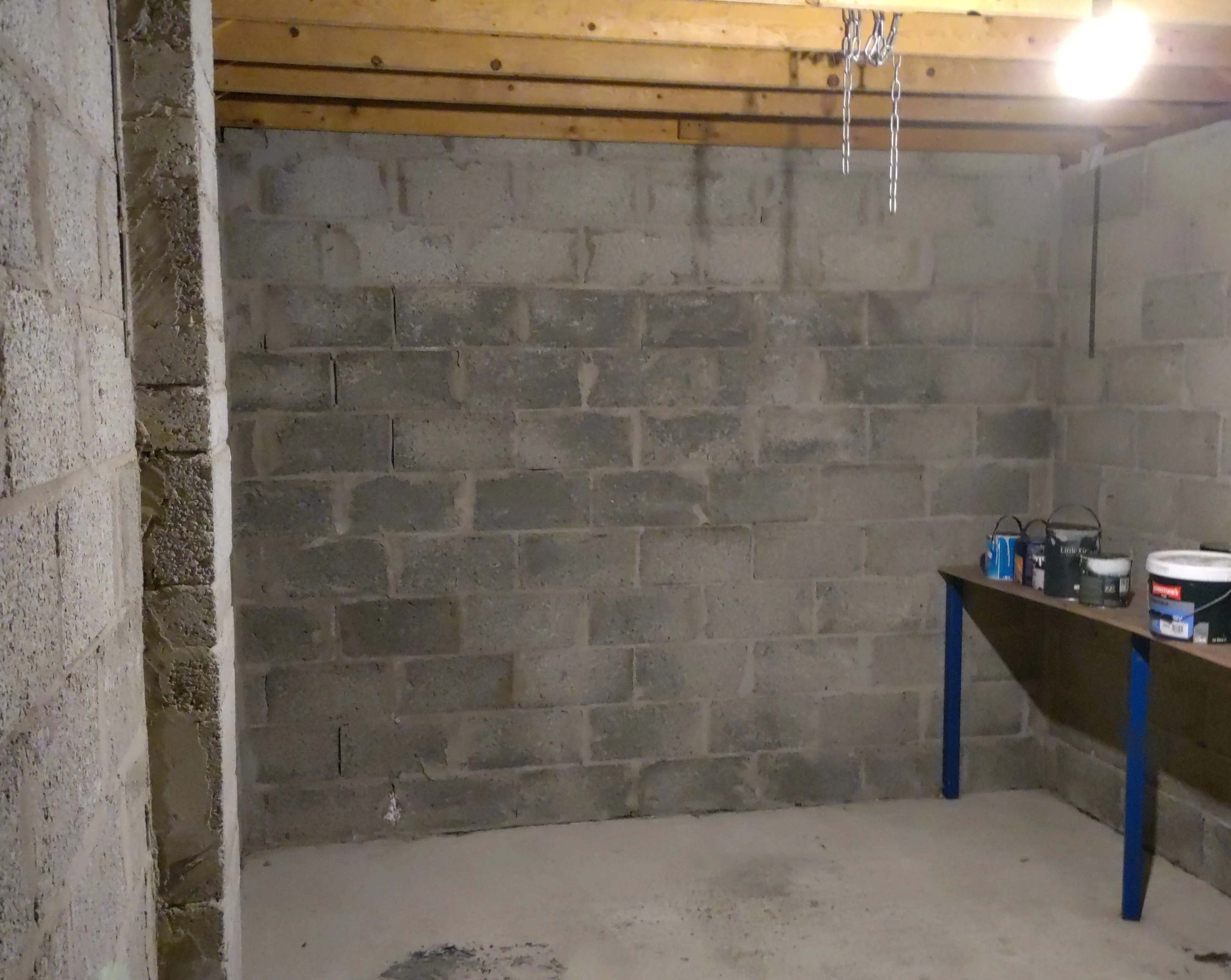

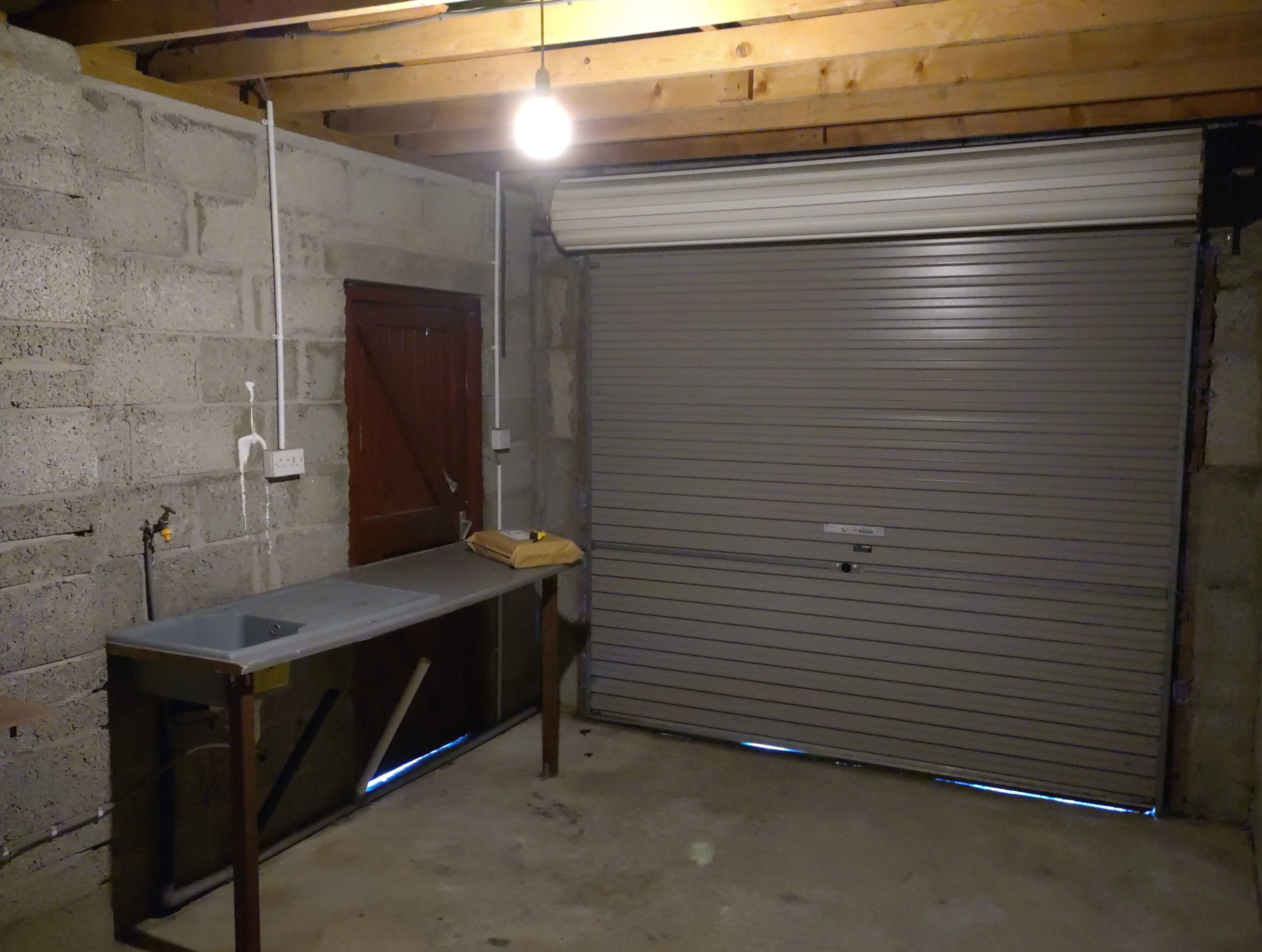

Hello! Thank you for anyone who is reading/replying, This forum has been a hugely helpful, but the more I read the more I feel like I have questions... hopefully my homework has taken me half-way.
Background

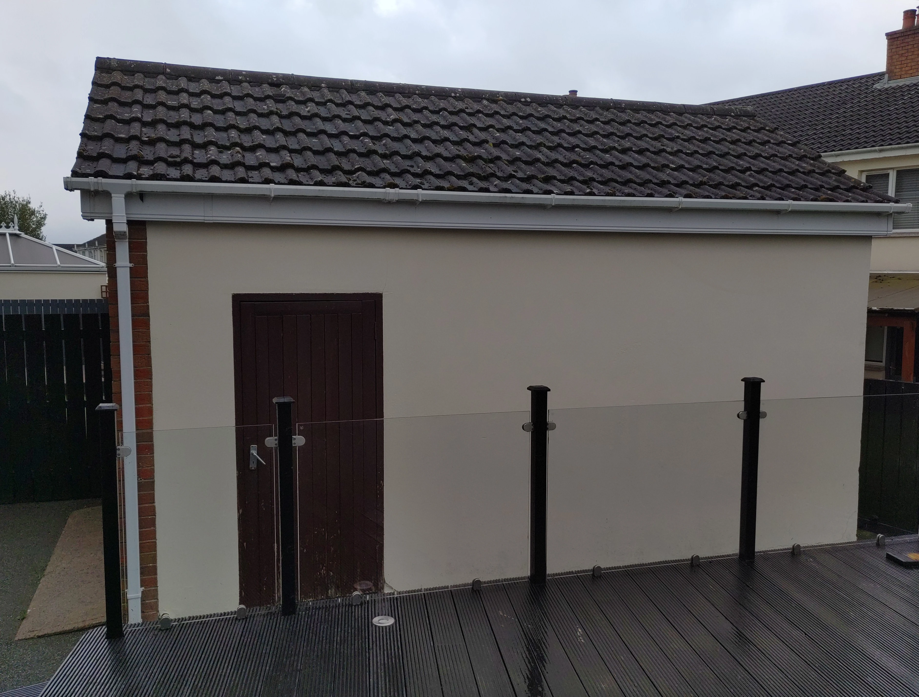

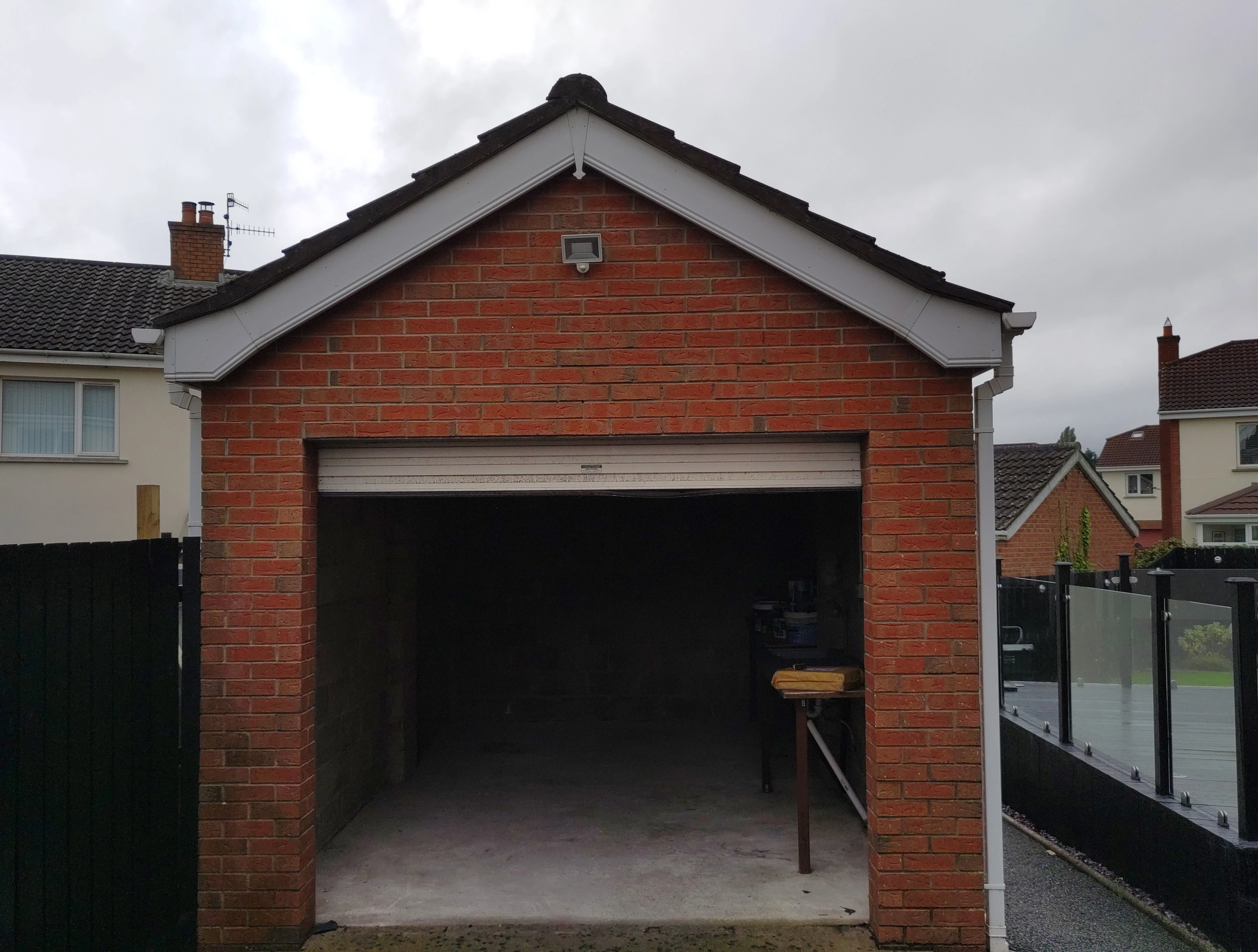

My wife and I recently bought our first home together. Having an environment for me to make music was an essential requirement. The house we bought has a detatched garage, which will be turned into my studio.
I appreciate there are limits to what I'll be able to achieve with this space, but I'm very excited to have a dedicated writing room, I never had this before.

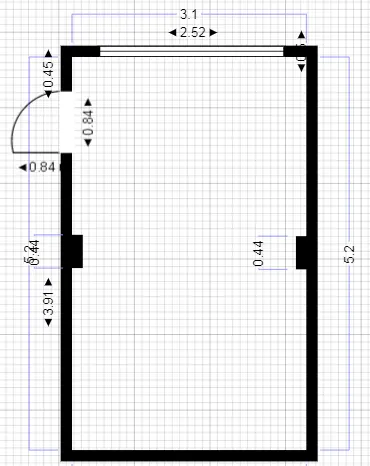

Garage Specs (in cm)
I have posted a few pictures including a floor plan. Below is a bit more detail:
Room size: 310 x 520 x 250 (to the wooden beams - actual ceiling goes higher)
Garage door: 252 wide
The side doors 45 from the wall, and 84 x 193
Pillars on the long sides: 11 (sticking out) x 44 (length)
The workbenches and sink on the side are being removed
Garage Roller Door
Possibly the first thing to think about: the garage door. Either I do a great job at insulating it or I have the door removed with a wall being erected in its place. The latter is more expensive and I need to get builders in... but maybe it's worth it?
Roof
The roof is a also a concern. I'm assuming I need to look into insulating it, but I fear it will be tricky. The beams seem strong, I was hoping to put some panels resting on top of the beams, and insulating wool resting on the panels. I wonder if the actual wooden beams sticking out (at about 2.5m from the floor) will give any problems?
Soundproofing
I found conflicting information about how much of the walls need to be covered to soundproof the garage. Some sites suggest every last inch needs to be covered in insulation, others suggest strategically placing acoustic panels on ~30% of the room will do the job. I'm currently planning on building a full "room within the room" (genieclip + stud wall), is this considered a good approach?
Pillars
About half-way through the room there's pillars slightly sticking out (11cm) from the walls. I understand corners/irregularities need to be managed. Is it enough to add acoustic panels to the adjacent bits of wall, to even out those 11cm? This will leave that small section of the wall slightly less soundproofed.
Door
The small door on the side will be my only way to access the studio. I plan on obtaining a soundproof door, although the size of the existing door seems to be non-standard so it might be tricky. Any advice on this?
Floor
The floor is currently concrete. Some studios have carpets to reduce the sound reflections, is that southing I need to consider at this stage or can I wait until later stages of the studio development?
Acoustic Treatment
I also appreciate that soundproofing and acoustic treatment are two related but separate topics... at the moment I'm focusing on the former, fully aware I will need to take great care of the latter. Any tricks I might be missing by compartmentalising the two too much?
Thank you to anyone who provides any insights!

A detatched garage...I'm already jealous.
I say keep the garage door, then it is all reversable, when you want to sell.
Build a soundproofing wall inside the garage door.
Line the space with thermal insulation, and a couple of layers of plasterboard, including a ceiling.
As it is, any noise will escape or enter easily.
Cover the floor with underlay/chipboard/underlay/carpet or a hard floor.
It is a good space.

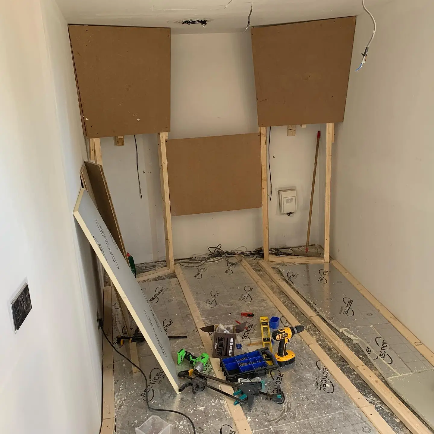

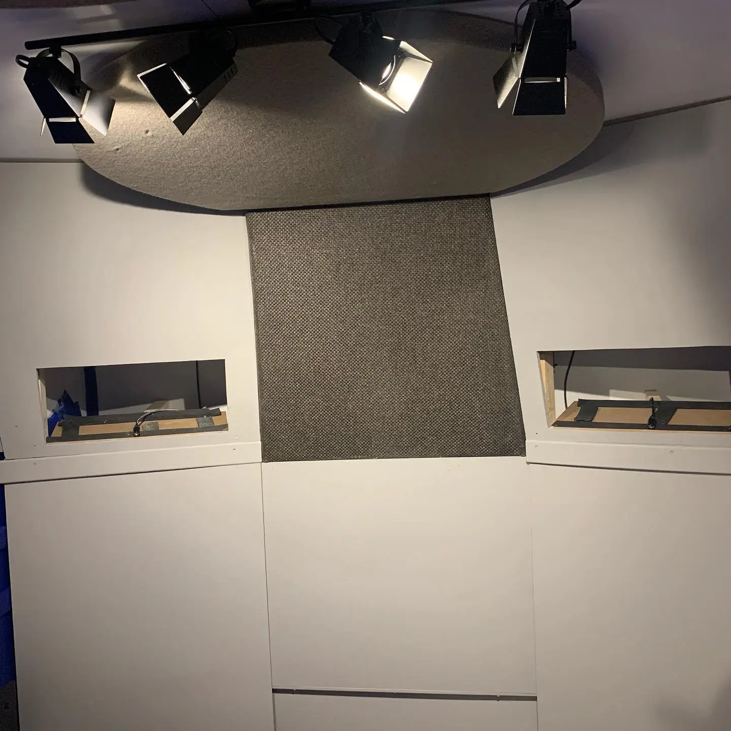

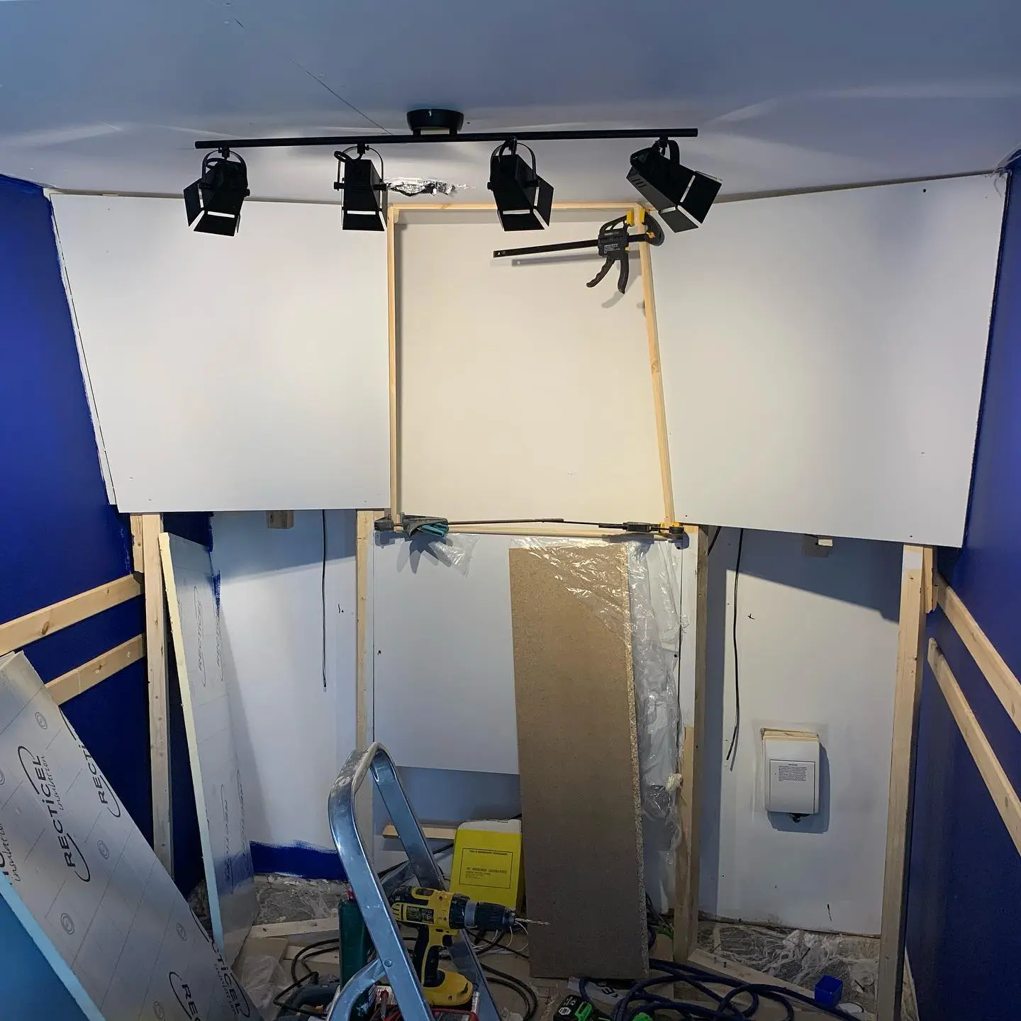

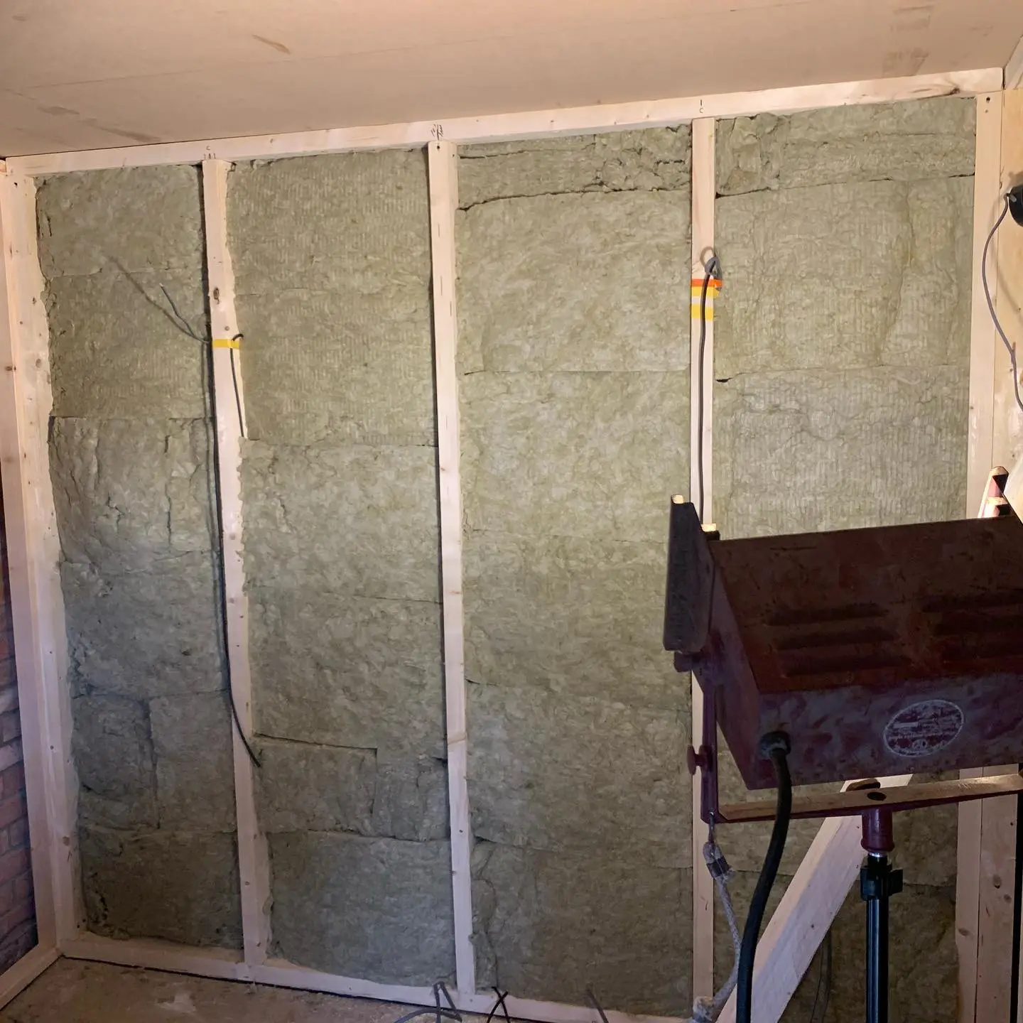

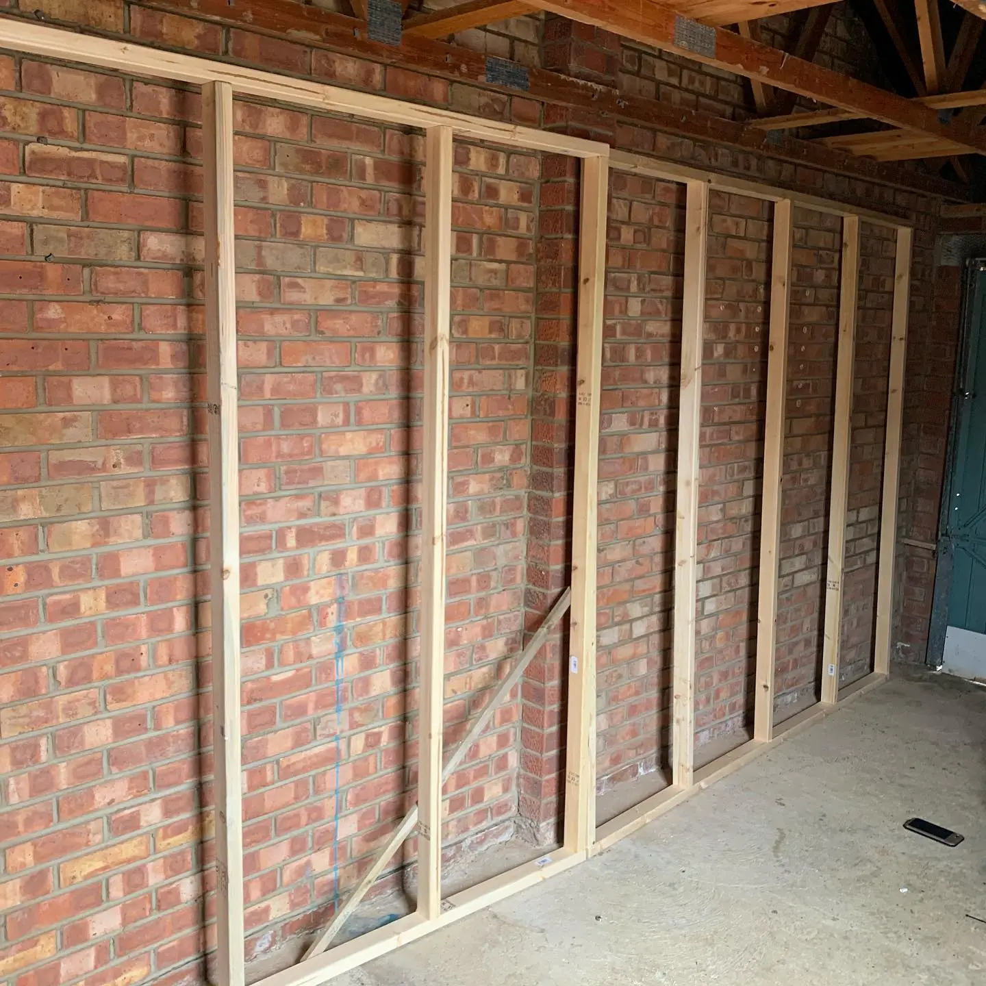

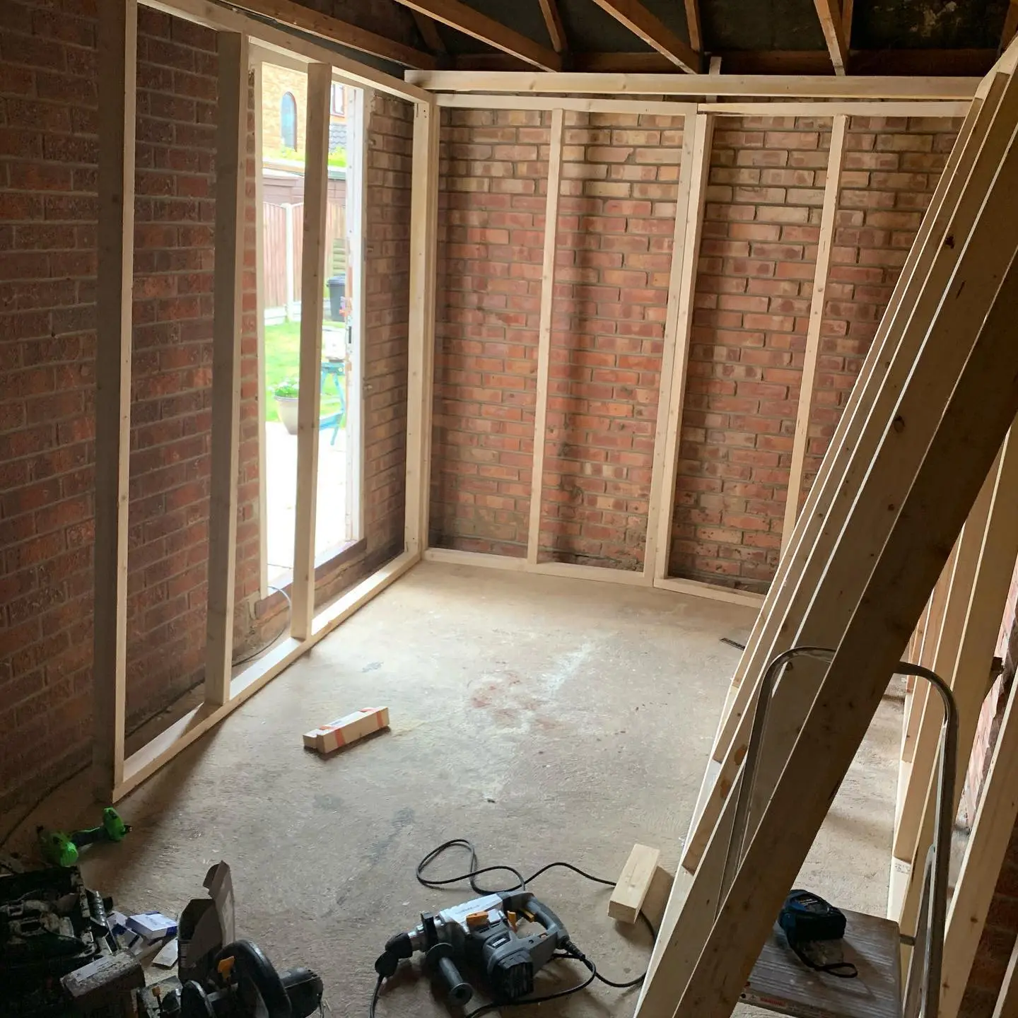

That's rather messed up with sound treatment. If you want to keep inside sound in, and outside sound out, then you need to build a room within the garage - you can get away with 75x50 vertical stud work, and if you build in sections you can adjust each panel's it is slightly in, or out, so 90 degree corners are absent - which helps no end with standing waves - which parallel surfaces tend to produce - and make the classic boxy sound. EVERY surface needs to be layered - two sheets of plasterboard as a minimum - my builds standardised on 2 x 12mm PB and one 18mm MDF on the inside surface, because it's tough easy to finish and really dense. To maximise ceiling height, put the cross joists that hold up the ceiling sheets in between the timber preforms you have for the roof support. Ceiling needs exactly the same sheet material. Ducting can go up into the roof space with fans etc.
Sound escapes/enters through the weakest links - usually doors, and door frames in particular. So slicing off the end gives you an outer and inner door - double soundproofing.

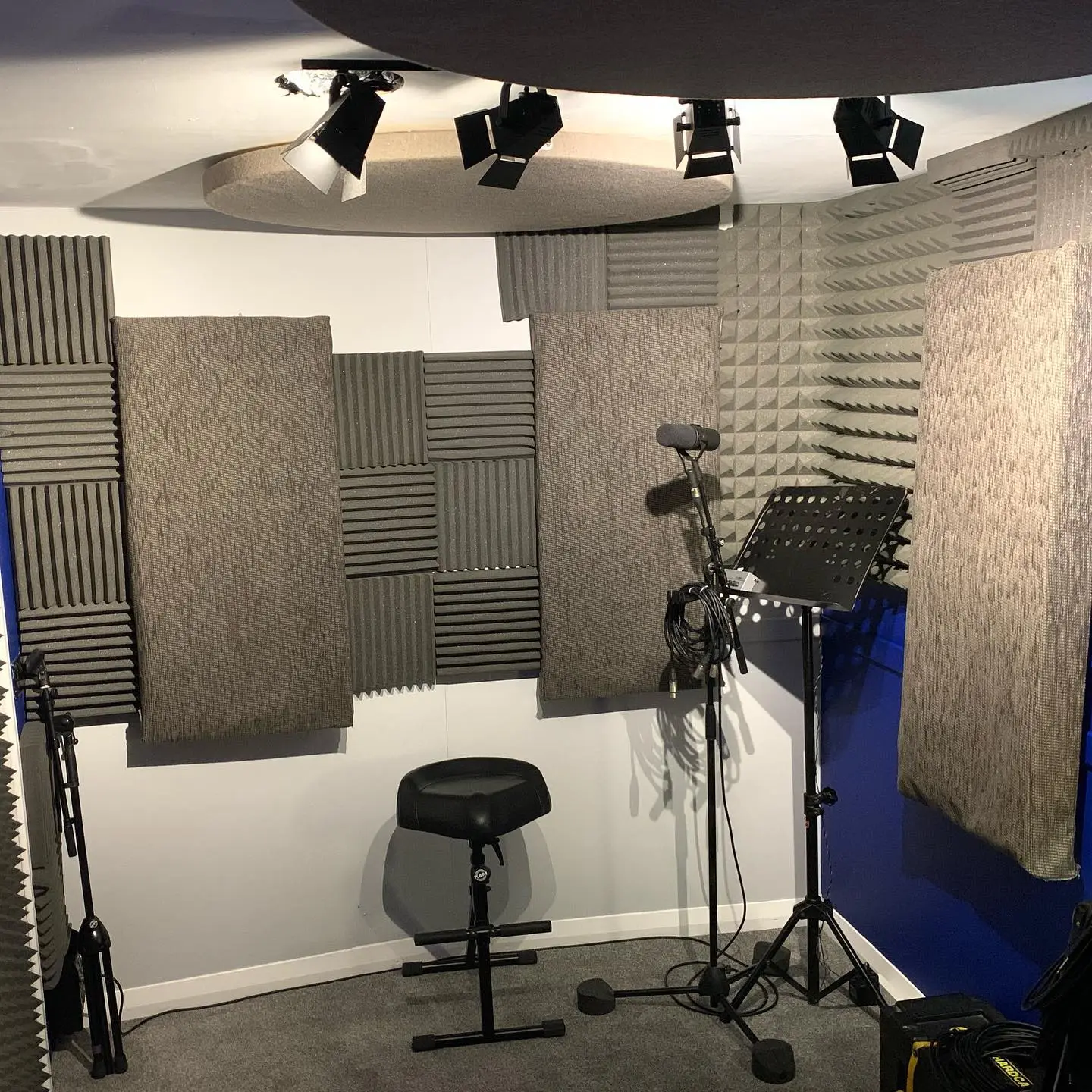

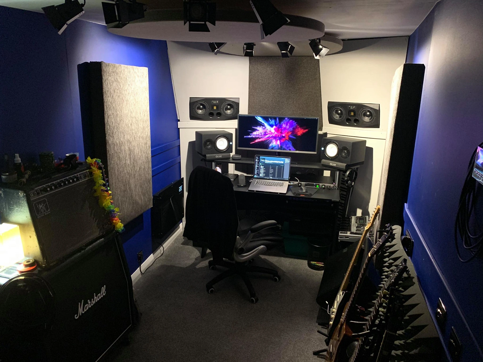

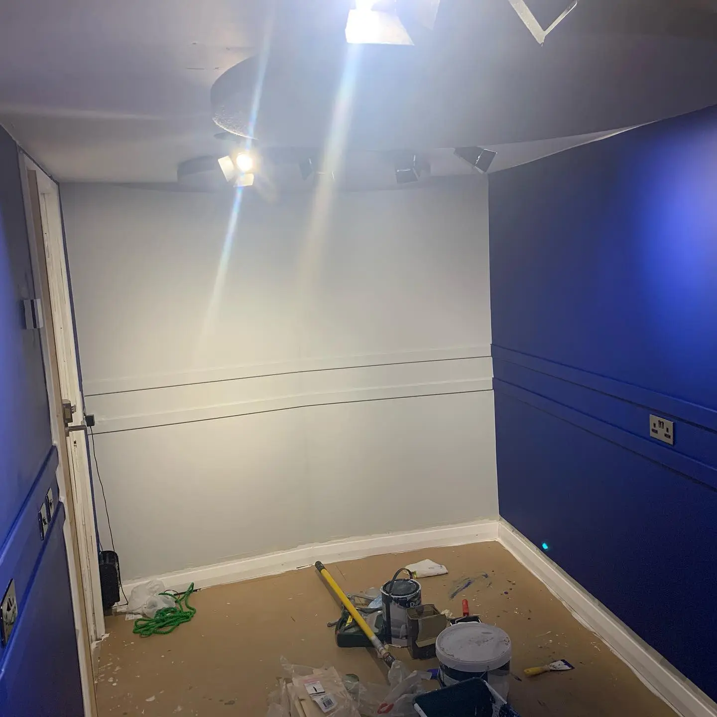

I've put some pictures up of one I did for a friend a while back in his British single garage.
Soundproofing and acoustic treatment (panels etc) are very different (just for clarity).

I'd do it pretty much the way that Rob has described but change a few details. I would add a compliant layer under the studwork and under anything else in contact with the floor. In my studio I used rubber crumb carpet underlay made from recycled car tyres although other studio builders use neoprene strips.
I would also use different thicknesses of plasterboard for each layer - the plasterboard manufacturers suggest a layer of 19mm plasterboard plank with a layer of 12mm acoustic plasterboard (which is heavier than the standard grade) on top for sound resistant walls. One studio builder that I know suggests using a third layer of 15mm acoustic plasterboard on top of that although I didn't feel it was necessary in my build which already had 150mm blocks on the outside.
I used the same construction for the ceiling.

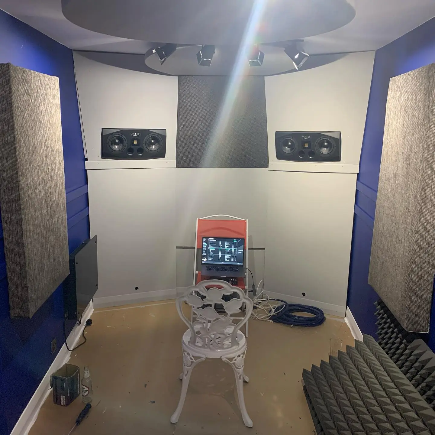

I moved house in 2021 and had to build a new studio in my garage - which is almost exactly the same as yours, except I have a flat roof..
You are right to build a room within a room, it's the only way to achieve good soundproofing.
I used 9 x 3 floor joists for stud walls stuffed with loft insulation, skinned with double-thickness plasterboard. The floor is chipboard floating on polystyrene.
Up-and-over door: I left it where it is. I left about four feet at the front of the garage for storage (PA hire gear :D) and built a stud wall across the front with a second-hand double-glazed PVC external-quality door for the entrance.
I have a separate recording room and control room. (Another PVC door between them). Only the recording room is room within a room. The control room I just put 2-inch battens with insulation and plasterboard straight on to the walls, because the only sound in there is the monitors, so they don't need so much soundproofing.
Side door and windows: I just left them and 'stud-walled' over them.
Inside, I bought the cheapest duvets I could find and covered all surfaces, including the ceilings. Carpet on the floor.
It works. I can record drums in there and there is only a slight suggestion of a thud outside the studio.
Picks and video:
Hope that helps. Fire away if you have any questions.
