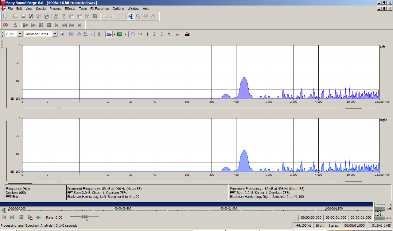

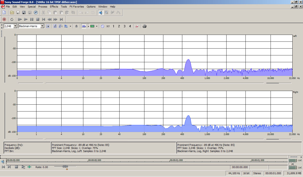

Neither of your files resembles the original sine wave, even though the recorded level is at a very reasonable -14 dB.
I just read your page again and saw that you actually did the processing with the signal 14 dB lower than in the 24 bit file on your site. So I took your 24-bit file, dropped the volume by 14 dB, converted to 16 bits truncated, then raised it 14 dB.
I still get a sine wave that looks and sounds like the original. So even though I mis-read your web page the first time, it's clear you reduced the file to 8 bits instead of 16 or something like that.

The description of what I did to my files is explained on the page, there were no errors, just misunderstanding on your end. The files were originally recorded at -80 dBFS and then brought up to -14 so that they could be heard more easily and without additional noise from a montoring chain. Truncation distortion is correlated to the signal, that basically means that at lower levels the distortion is a larger percentage of the signal and can be heard readily.
Even on your graphs you can start to see where the truncated signal gets "squared off". This is essentaily harmonic distortion, something to be avoided, not swept under the rug of a louder signal.

Yep, they were not reduced to 8 bits though. They were reduced to 16 bits within the 24 bit bus of a Pro Tools HD system (non-dithered mixer) using an L2 plug-in. If you try to increase the gain after a conversion to 16 bit, well it gets real ugly.
One thing to possibly consider is what Sound Forge is doing "behind the scenes". I'm not aquanted with this program at that level, but it could be doing it's processing at 48 bit. Also try using the FFT instead of viewing the waveform.
You're kidding, right? This is what you offer up as proof of the importance of dither? Okay, you're correct, it's not 8 bits - it's more like 3 bits. Please tell me this is a joke.
