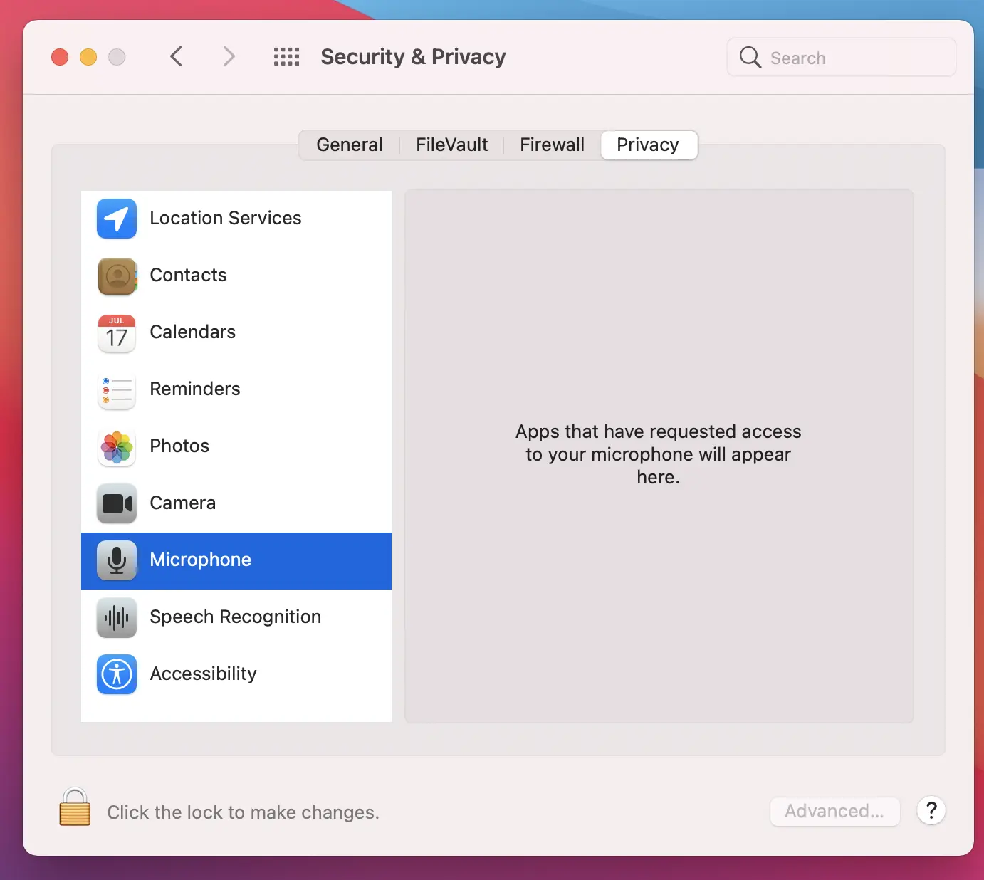

Okay. Still stymied. I did the above Privacy > Micruphone cha-cha and got:

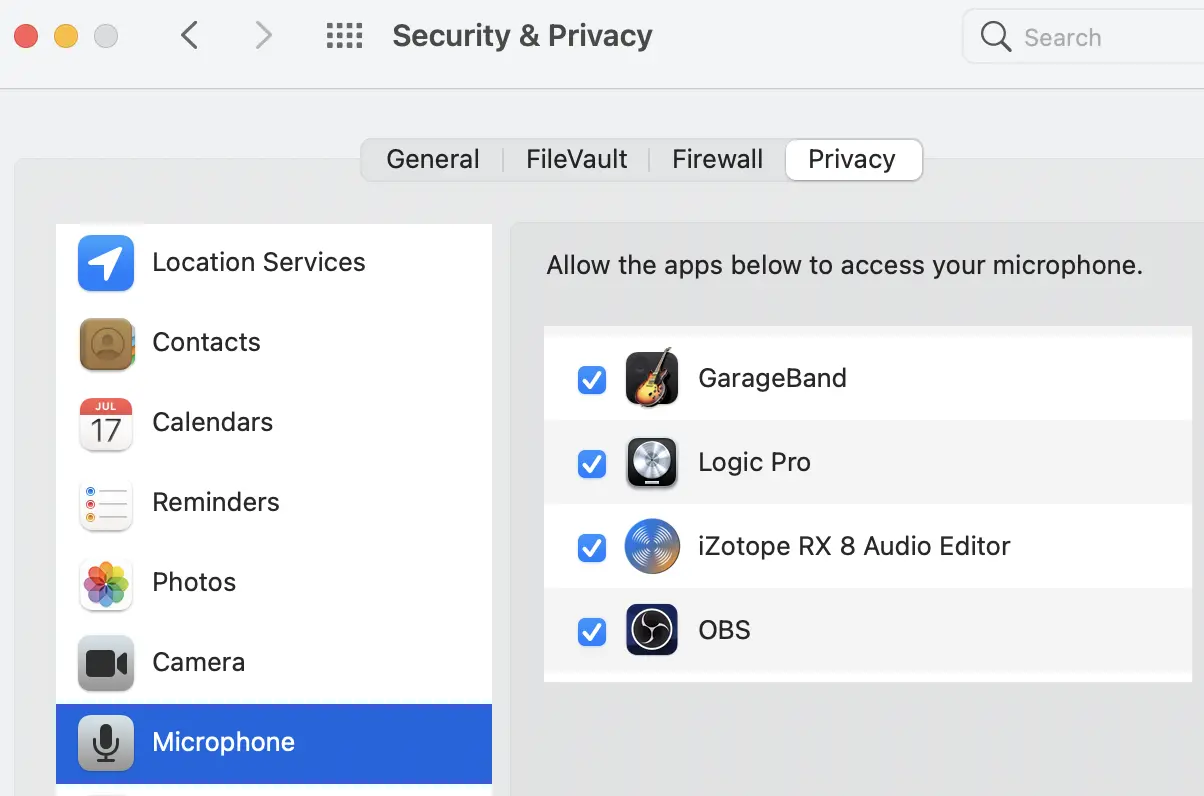

So, did you click the LOCK icon and add apps? Here's mine with (just some) of the apps that can access the "microphone" on my Big Sur install. (If there are no apps asking for access, that's a little weird...)

No, I didn't. What does the Lock icon do? Do I want it to be locked or unlocked?
You have to unlock it to make changes. But, I honestly don't remember what it looks like before. What does your audio-midi setup app show?
Aha!
I'll experiment and let you know what happens. And I'll look around for the setup and grab an image of that for you.
So far so good. Thanks! Got the mic to record on channel 1. Now the mic is plugged into channel 2, but I haven't gotten it to record yet.

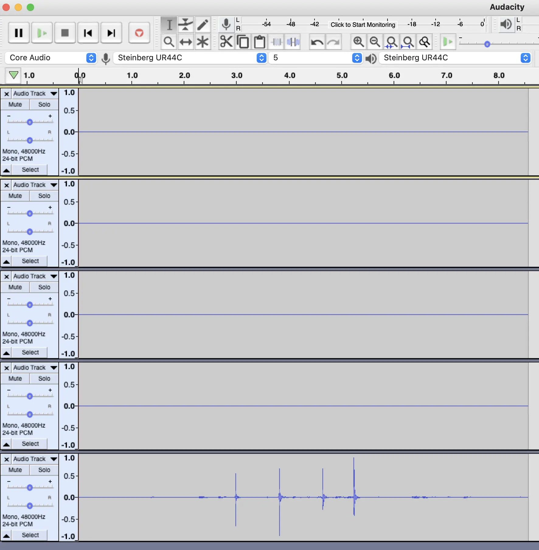

Yes, I think you have to set in your Audacity Preferences how many input tracks you want to record, and then you have to actually add that many tracks, whether you have input on them or not. I just tried to get Input 5 (where I have a preamp routed) to record, and I had to add 5 mono tracks (I guess I could do 2x stereo + 1 mono to save time).
I use Audacity for almost exclusively editing and almost never for recording. Most of the other things I might have used it for in the past are now done in iZotope RX (standalone).
(image is me snapping my fingers in front of the mic that's going into input 5 of my interface)
