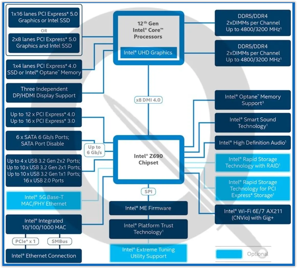

Here is a bit of an explanation of USB functionality.
This is a graphic of the I/O of the chip set and CPU on a PC. Note the USB section where the term "Up To" is used. The motherboard has a USB controller that manages USB data between devices and the chip set and the chip set manages data traffic to the CPU. The USB controller buss to the chip set has finite bandwidth. So it is common to see a certain number of high speed USB and a few lesser. The combination adds up to the maximum bandwidth the USB controller can process. On the OP's Asus motherboard, there is a variety of ports with different speeds. The total of bandwidth of these ports is the max the USB controller can handle.
USB 3.2 Gen 2 has a speed of 20Gbps. Certainly this would be enough bandwidth to handle putting everything on one line, right? Not so fast. Here is the thing about serial data communication.
Serial communicates data on one single line, one transmit, and one receive. USB 2.0 is a Host-Device standard. A device doesn't transmit data unless the host tells it to transmit. For instance, the host computer will poll a standard PC mouse about every 8 milliseconds for location status. Even shorter duration of polling if it is a gaming mouse. The PC asks the mouse "what is your position" and the mouse replies. Same for keyboard. USB Midi also works the same way. It is counter intuitive. We all think that when we press a key, we are sending the command but it is the USB controller polling at high speed for changes in state. It just happens so fast, we don't usually take note of it.
So what happens with devices that have a continuous stream like an audio interface? Well, that is what buffers are for. Most DAW users are familiar with buffer settings. So if you place the audio interface, keyboard and mouse and a whole bunch of Midi devices all on one USB line, the controller is polling multiple devices on one line but can only do it one at a time. If you separate these sources, the USB controller can poll as many devices at once as you have physical connections. So you are not adding interrupts to the audio stream traffic if you keep the interface on its own port. Put too much traffic on one Hub and you increase the need for buffer size. Too much and even the buffer won't compensate enough. Some interfaces are also just picky and it doesn't take much to break the connection.

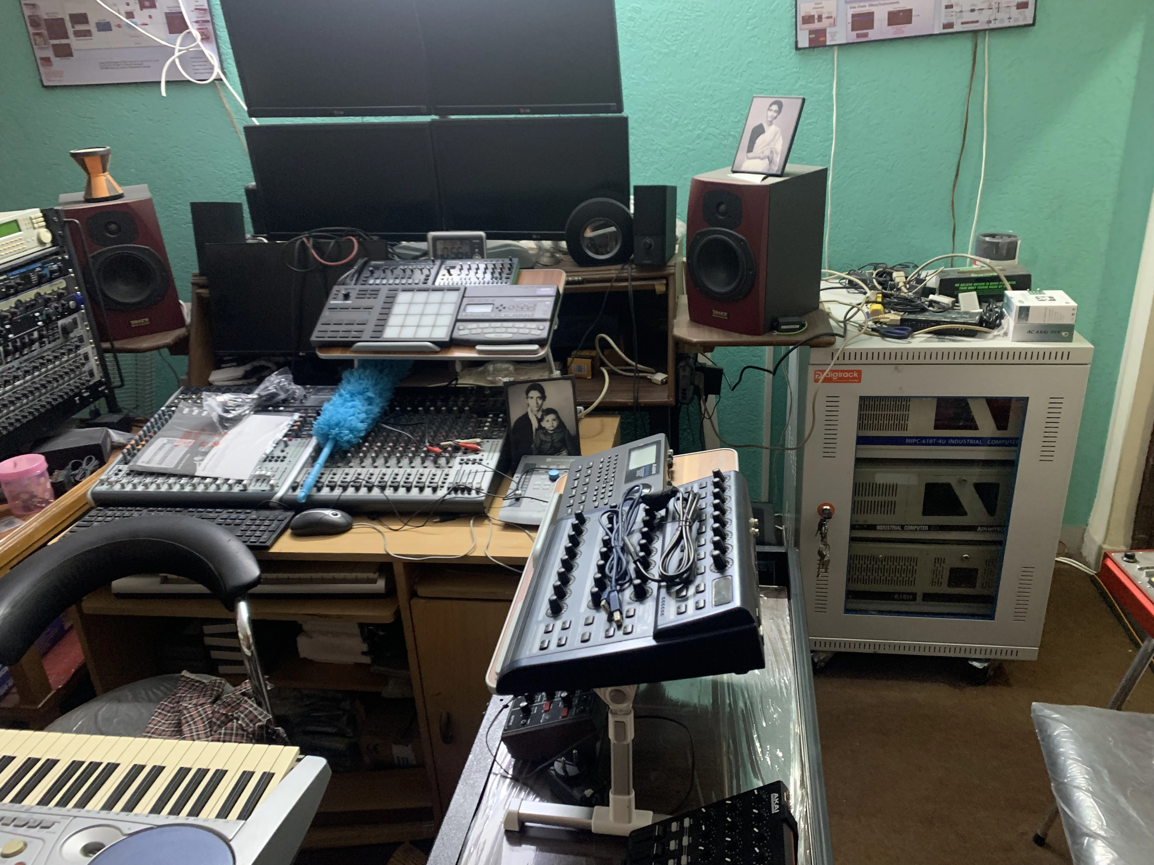

Attaching a photo of the previous rough layout. The PC cabinet is on the rightmost. The rackmounted interface devices are on extreme left, just next to the left speaker. So the problem was to connect the interfaces to the PC cabinet on the right.
Forgot to mention that thr PC cabinet has 4 large fans on top.
