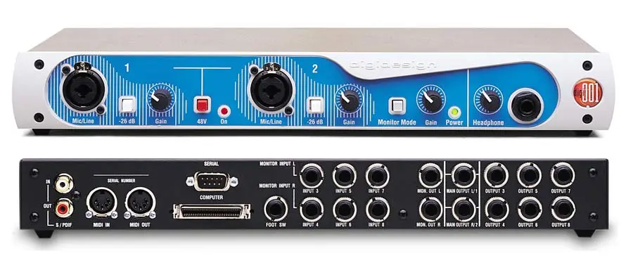

Hi CUZ,
I was just wondering what YOU think of the Digidesign Digi 001 studio set up campared with the OMNI/Delta system?
It seems to me that these two products are very similar in basicfunctionality, etc...but the Digi 001 is quite a bit more expensive at approx $799 USD, and of course incorporates the Pro Tools software bundle.
As YOU have your own recording/voice-over biz, I was curious as to whether or not, you'd consdered buying the Digi, before getting the OMNI? The Pro Tools gear always sounds so great in the reviews etc, is it really much better.
Don't get me wrong, my OMNI sounds great....but I'm always curious :-)
10 - 4, over....
KEV
PS. what a wcky month here in Toronto - weather-wise, we've had 31c degree heat, and now snow (today) all in the space of one week. I gues that's CANADA for ya - eh!
