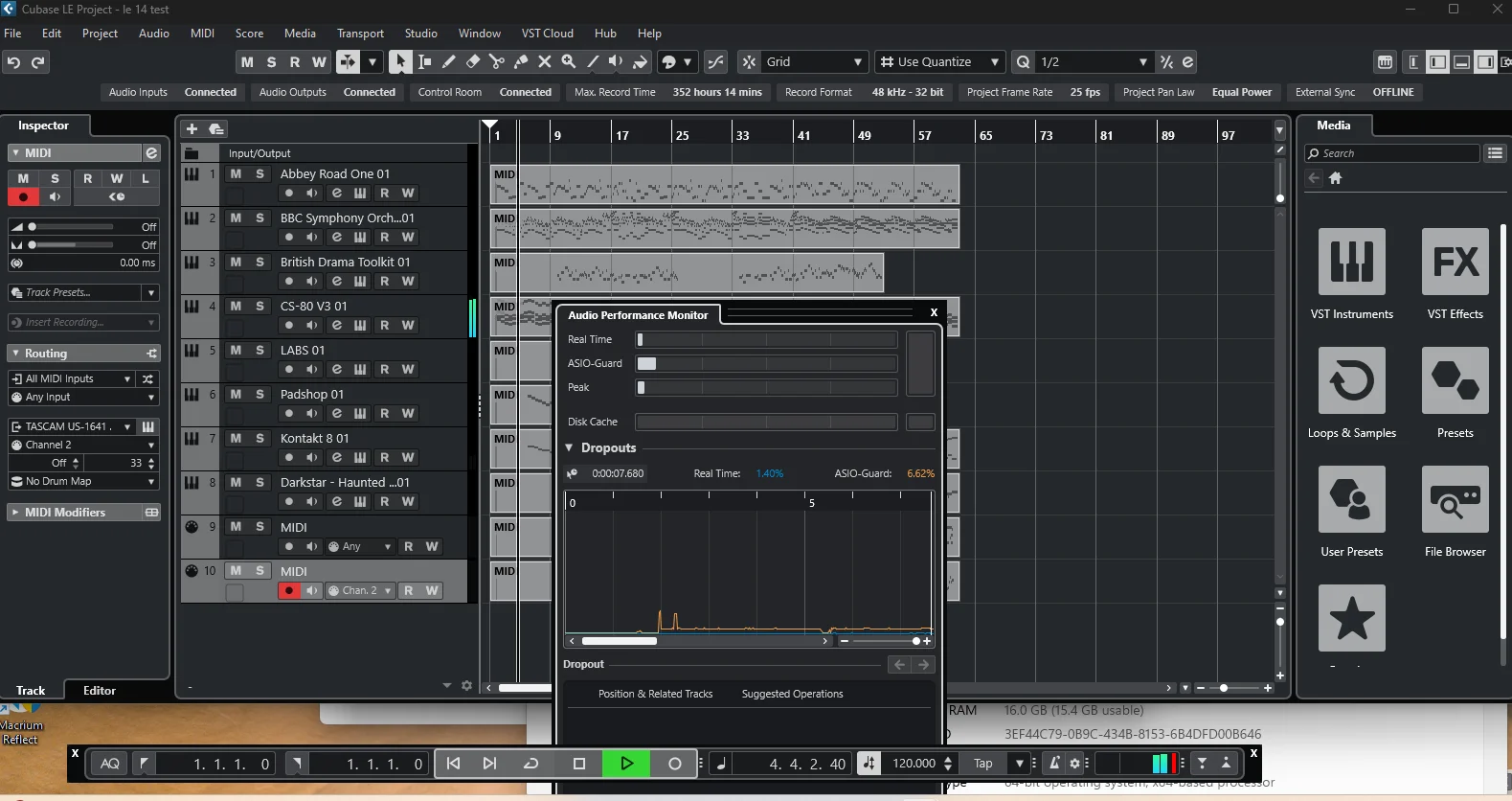

The cheaper computer I have in the office is an AMD ryzen 5 pro with onboard graphics 3.7GHz and has 16GB of RAM. It runs cubase fine - and today I have completed the sample installation - my drive space total is now 10.9TB - Cubase no issues, a bit laggy on premiere with 4K, OK on HD with real time graphics - rendering speed isn't brilliant, but I can use it as a backup. The image is with a pile of VSTi tracks and shows very little stress. Does this help?

Not a lot but thanks Rob! I don't know how that Ryzen CPU compares to an i5 gen 10?
