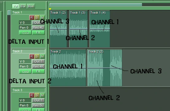

Okay I did some more tests today. I'm not sure what to think. First of all, my board is older so I do run into problems where channels fluctuate in volume. Channel 6 still needs to be repaired, but channel one seems quieter as well, but not by much, I didn't even realize it until now.
But if I'm right it also seems my 2 first inputs on the Delta are giving me different volumes. My test was to take one cord from the snake and hook it up to the first XLR input. I turned on the organ and let some drum machine run on it so I could get a steady volume.
So I set the first 2 channels on my mixer to the same volume. I plugged the mic into channel 3...good volume. Channel 2 I got the same volume. Channel 1 I got half the volume.
Okay so then I moved the cord from the snake to the second XLR input on the Delta. First channel was nice and loud, even louder than channels 2 and 3 on the first XLR input. Then channel 2 and 3 I got the same volume, but it was even hotter than channel 1.
So basically: Channel one was half the volume on both Delta XLR inputs on the Delta, but the second input was louder than the first XLR Delta input.
Now I'm not sure if it's the channel on the board's fault or what. On the board it seems like there is only a slight volume difference, but when recording it's like half. I'll try running channel one into a Delta RCA input later for another test.

Well I just bypassed the board. Channel one is half the volume of channel two. I don't have mics at the moment to test, but running it directly into the organ shouldn't make much of a difference, the signals still differ. And both are set to the exact same things into the Delta control panel so...fuck.
Oh yeah, I also took a track and put it into channel one and two in Cool Edit Pro. I ran them both out to my board and the board didn't show any difference between the two tracks volume wise.

Yeah I keep testing it and I get the same thing. Today is just not a good day. Not to mention I just got another busted knob on my mixer from trying to pry the damn thing off (there's another email to Yorkville).
Now I am throughly stumped myself. I have all the inputs and outputs -- everything -- set to the same level. All I'm doing is switching from channel one and two by moving the mic cable to each input, and I get different levels.
