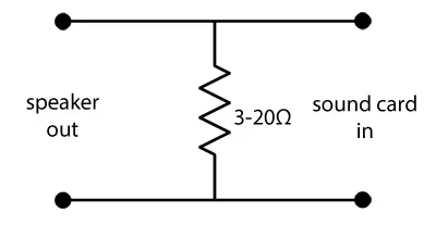

Thank you so much for taking the time to consider this - it is very much appreciated! Just to be clear, you are recommending that I go straight from the speaker jack to the sound card input with a resistor (between 3 and 20Ω) wired in parallel to the connection? Do you have any idea how many watts this resistor should be rated for? I'm guessing that in order to keep the signal/noise ratio nice I'll probably have to turn up the deck's volume a bit. BTW, I realize that my "sound card in" of the schematic is mono - I'm planning on just wiring to one side of the stereo 3.5mm plug.
Sorry for so many questions, and thanks again for the assistance!

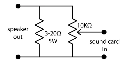

Do not apologies! All good stuff. Yes you need to have a decent amount of drive from the valve and if you blew the 'its off that 6V6 you would only get 5-6 watts (at 10% distortion!) So, a 5W R should be fine. If you have any kind of AC voltmeter (and you strike me as the kind of chap that would) look for around 0.5 to 1volt across the load, that should keep you well above 'system noise' but well below distortion. However, possible snag.
You are going into (ugh!) a PC soundcard and they tend to be neg 10 devices (300mV ave) and so 1 volt is about their limit and so, get it right for the valve, overload the soundcard!
Easiest solution is a pot across the load and the SCd input goes from wiper and earth. Any old pot will do and almost any track value. 10k log is pretty ideal but it really won't matter.
So, recap: Set for around a volt then pot down to get -12dBFS in the software average, max peak -6dBFS, if running 16bits. Should you be able to run at 24bits, neg 18, peak -8ish.
Why yes, I do have a multimeter. :D
So does this look about right?
