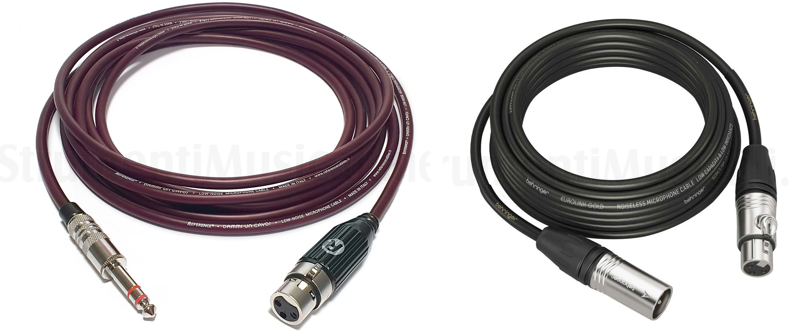

  • - female XLR cable -> TRS (from CP88 to Audient)
  • - XLR female cable -> XLR male (from CP88 to Audient)

I attach photos of the CP88 outputs and the Audient inputs and photos of the 2 cables to choose from

The problem Dave mentioned was level - if you keep the Yamaha lower than maximum and the gain on the interface lower, it should work - the danger is just distortion of the level of the keyboard overloads the input. won't hurt, but will sound rough. In fairness, one of that keboard's selling features is that on stage you just use mic cables to plug onto the stagebox.
Based on what I could find on the CP and the audient my advice would be go balanced xlr as opposed to unbalanced 1/4. You mention that you used 1/4" balanced cables and it stopped the noise...Not sure why that would make a difference because the 1/4 outs of the CP88 are unbalanced the xlr are balanced. Whenever you have the option to go balanced you should go balanced as it reduces possible noise. Being as the audient offers XLR I'd definitely go XLR to XLR as it insures the best signal you have available. The audient 1/4" inputs and the CP88 outputs are TS not TRS so using balanced 1/4" cables is a waste of time and money. That you eliminated the noise using balanced 1/4" doesn't make sense. Perhaps one of the 1/4" TS cables was bad On the XLR cables any name brand decent quality xlr cables will be just fine.

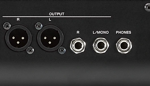

Yes, I confirm: the CP88 has 2 outputs (jack or cannon. I attach photos).
The first time I used unbalanced TS cables from the CP88's output jack to the Audient. There was a lot of noise, hiss, hum, clipping etc. Etc. Very bad...
Then I used the CP88's XLR output and connected the XLR to the Audient and all the noise disappeared!
TAE, maybe that's why I didn't have any more noises, because I changed the outputs used in the CP88. I left the TS outputs and tried with the XLRs (as you see in the photo).

No bother. I think you just need to try a couple of XLR cables and see if it works for you. The theatre I run often have these in the bands and they ALL use the XLRs, and engage the pad on the mixers - so the same should be true for you.
