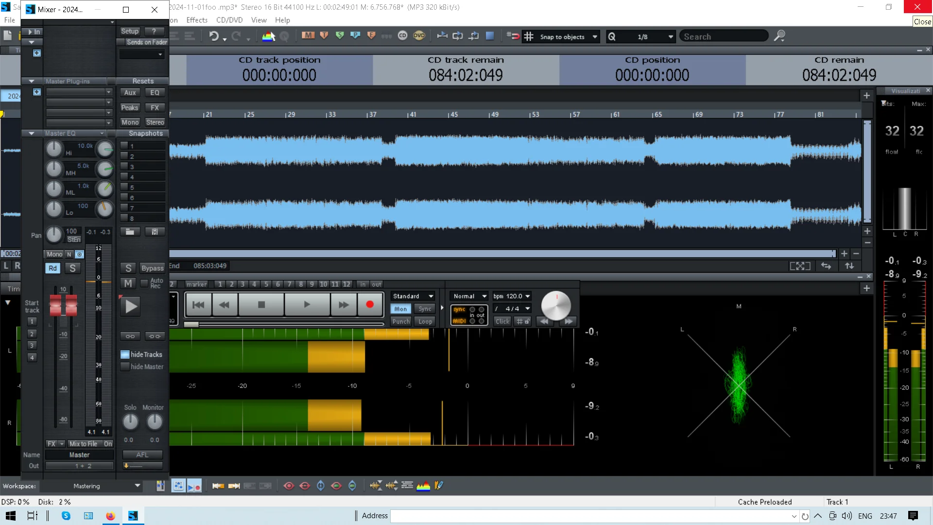

Attached is a direct recording of the YT sound done from "the screen" via the 5/6 'loopback' function in my MOTU M4. I then exported it as a 320k top quality MP3.
How does that sound? I cannot see how you could get better quality than that? (I am NO judge but that, IMHO is not a good sample of music upon which to judge sound quality?)

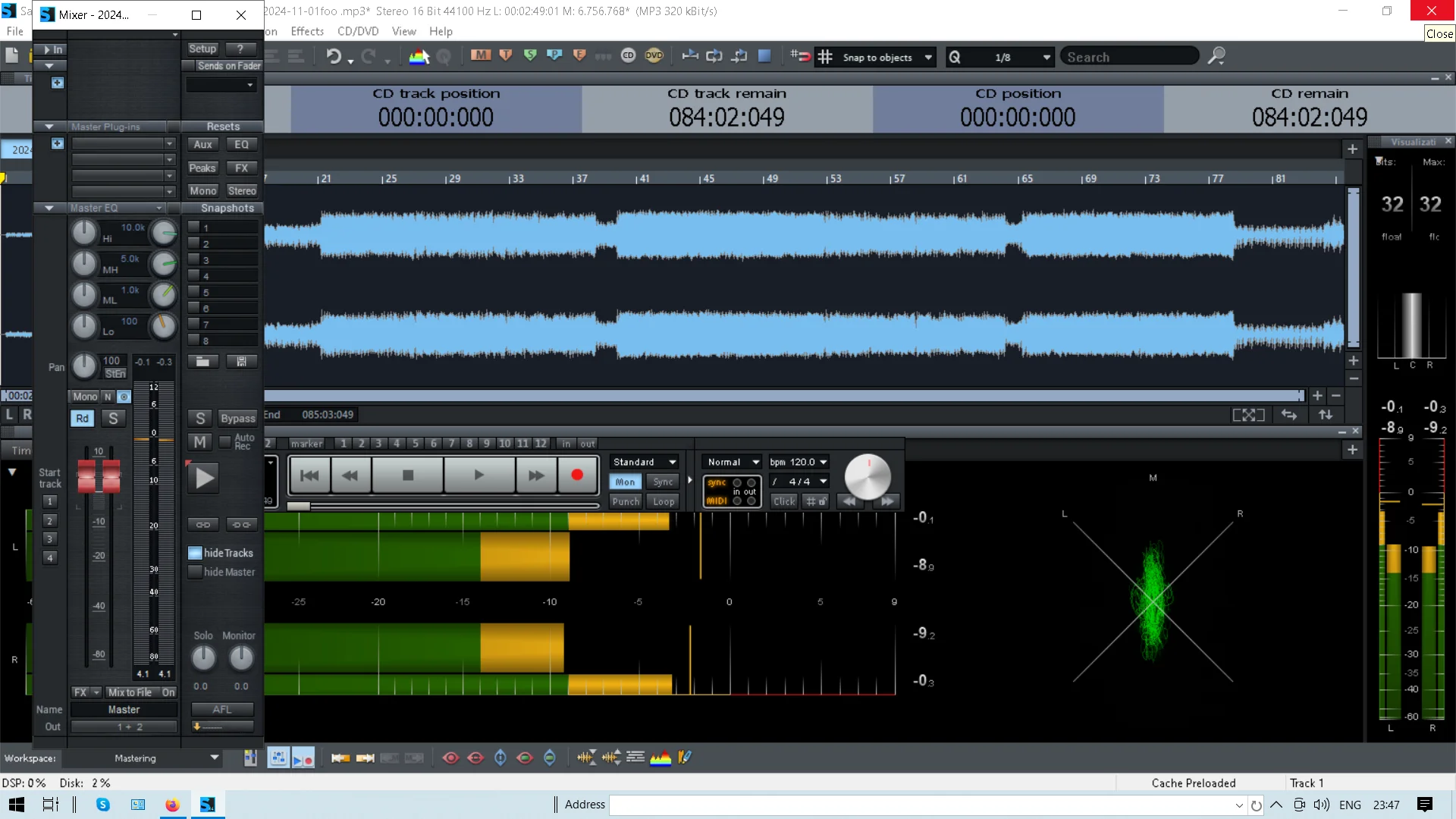

??! My track is exactly the same amplitude as the YT track, i.e. peaking to -6dBFS. Or as per the screenshot, can be boosted to just under 0dBFS.
Yes, the Behringer interfaces have a very limited line output level (about +6dBu or 1.5V rms iirc) so if you want to drive monitors louder and they are out of gain you will have to add a 10dB or so boost to the outputs.

If i toggle between the youtube and the mp3, the mp3 100% sounds quieter. By quite a bit. I have not tried downloading and inspecting, but its a clear difference on this device? Odd?
Hmm? They are comparable to me Rob. I know I am deaf! But I can compare two clips and discern a significant loudness variation.
In any case, it does not matter! The MP3 clip can be at more or less ANY level. If it is at say -20dBFS just normalize it to a sniff under 0dBFS. Or, as I often do for a small boost. just push the master fader in Sam's mixer up a dB or 3 and "Save As".
But, I repeat...you will not get lot of level out of a UMC interface. You also do not want to run it at higher than ~-6dBFS Absolute peak or they get 'scratchy'
Yeah it's just rather quiet and normalizing should do the trick i guess, which is not too big a hazzle and quality wise should be fine for our needs ? id still be curious why this would happen from a technical standpoint, if anyone has an idea!
