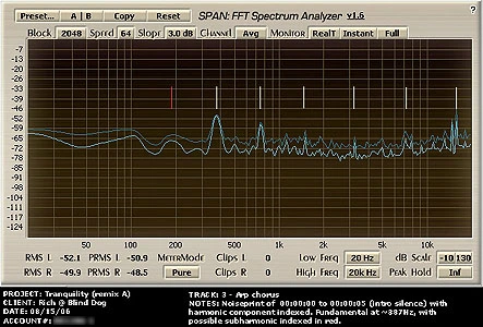

I had a gig this summer where I was asked to remix and premaster some analog synth stuff in the vein of early Vangelis or Synergy (lot's of fancy ARP and Moog and Oberheim patches, oh my :) ). The client had recorded this stuff to computer via a very dubious quality sound card and unbalanced wiring. This had left a rather noticable noise floor on his tracks.
None of the NR tools I have - including the Waves stuff - was able to knock down the noise to acceptable levels of some of his synth tracks without artifacting the signal to the point where it sounded like beached whales with golf balls in their blow holes.
After analyzing the noise, I found that there was a harmonic component within the noise with a bizarre fundamental (see attached graph). I have no idea just where it came from, but I had to knock that down manually with a harmonic filter before throwing an NR plug at it in order to keep the plug from artifacting the signal too badly.
