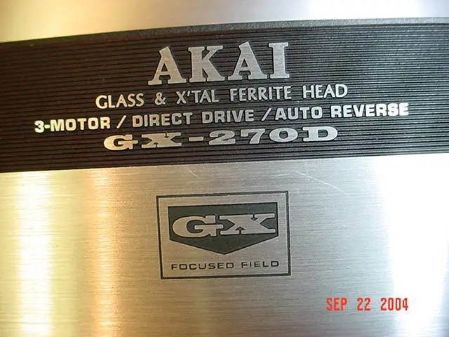

Calling VINTAGE TX (Rolf)! (My restoration project!)

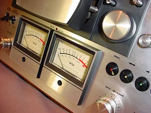

Looks much cleaner now ...

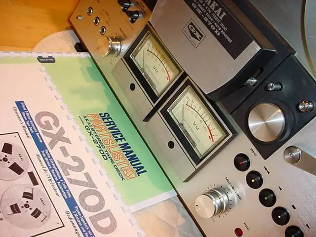

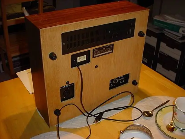

Another one ......

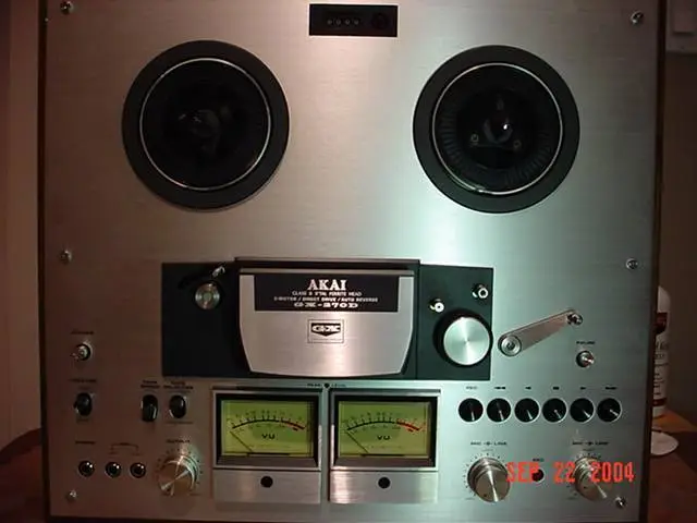

Clean baby!! :)

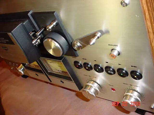

Now, I'm getting "artsy" with the picts .... ;)

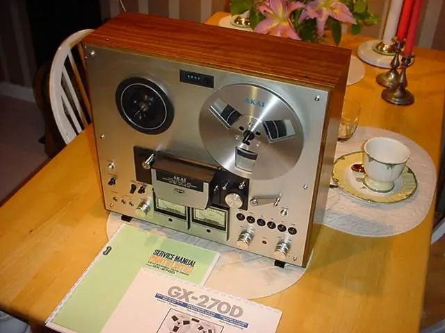

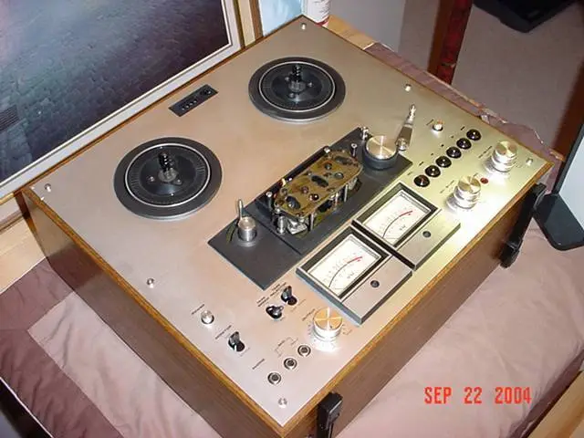

last one .... :(
Want an encore ? Didn't think so .. :eek: :D ;)

Looks very nice Daniel. :rolleyes:
Your parts are packed and ready, will send it Monday.
Got behind here with packing 3 decks last week. :o
Holy Smoke, I missed all the pictures before posting. :eek:
WOW, how many hours (days) did you spend Daniel ? :D
Let me guess..... 3-4 days.. :rolleyes:
Very nice !!!

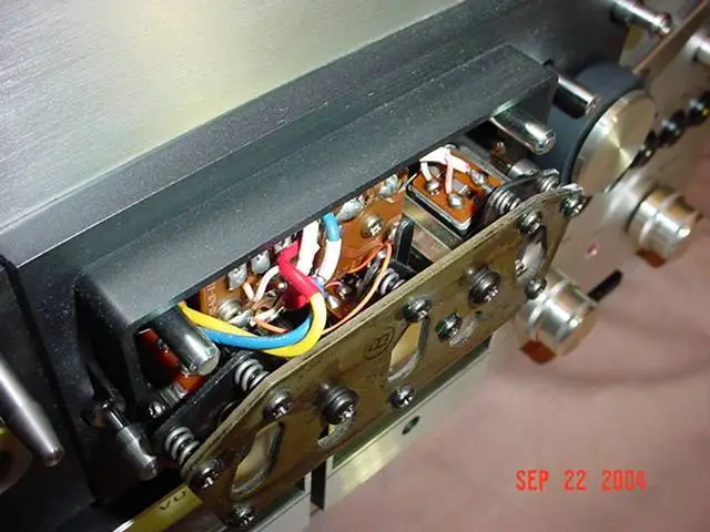

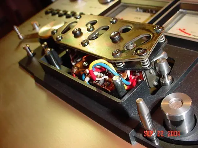

Looking at those 2 heads, the erase-head and playback have seperated inside.. :( When that brown-yellow goo comes further down you need to replace it Daniel..
Took me quite a while to post these picts! :D
Yeah, pretty bad news about the heads tho ... :(
