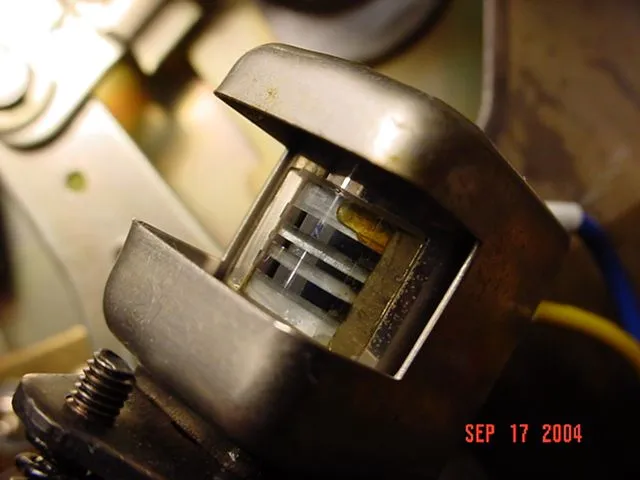

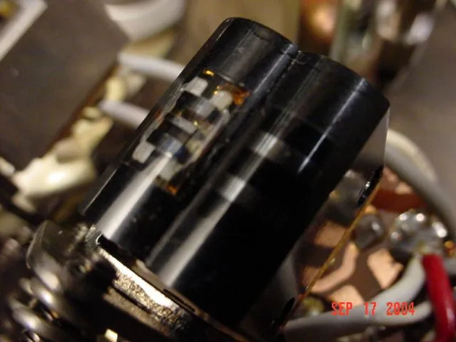

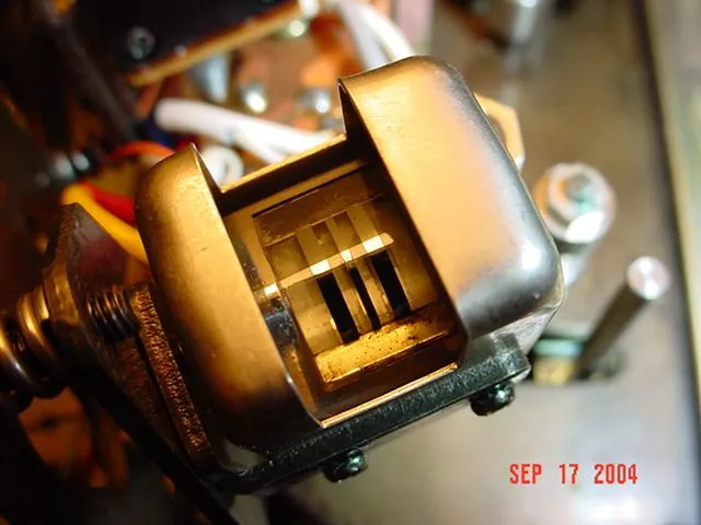

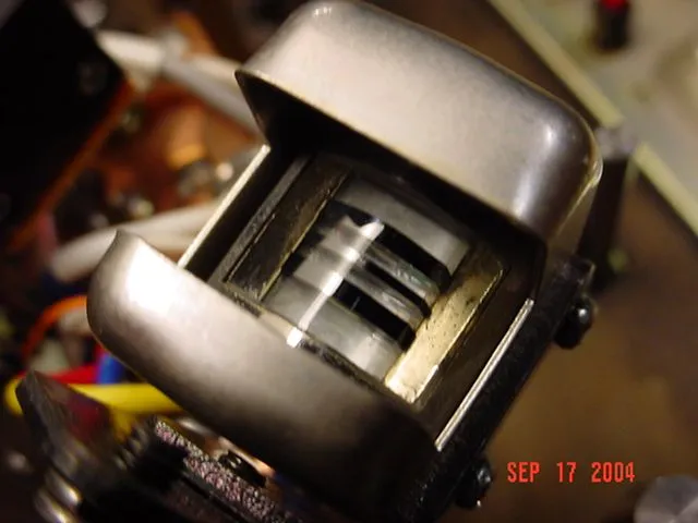

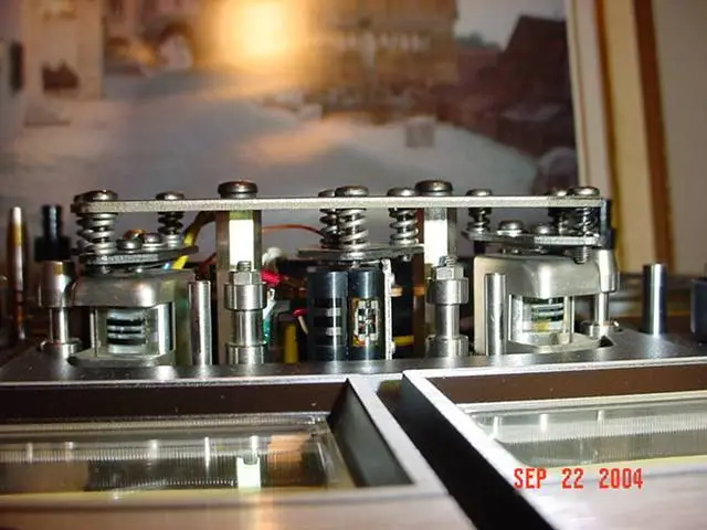

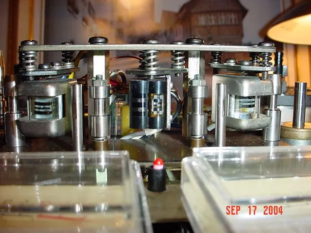

Here come the many picts from the "restoration project" ... The Akai may not look new inside and out but it looks significantly better than when I received it. I think the biggest problem was the whole tape path and heads ... the previous owner never did clean 'em .. :eek: The discoloration UNDERneath the heads is puzzling though ...... $1000 to the first person who tells me what it is! ;)
Many picts to follow!
Daniel :)
Head pict came out quite well don't you think ?
Another one .......
Ahh, the infamous discoloration .... sorry about the bad pict ... it's hard to get it in focus .. :(
I think this is the clearest pict I've ever made this close ... you can see the discoloration better than with a naked eye .... what is that ????? :confused:

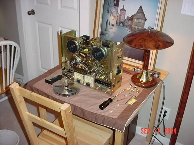

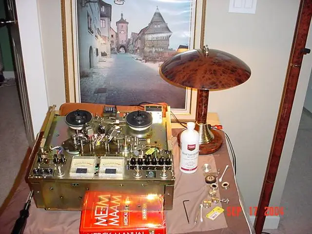

My work table ....

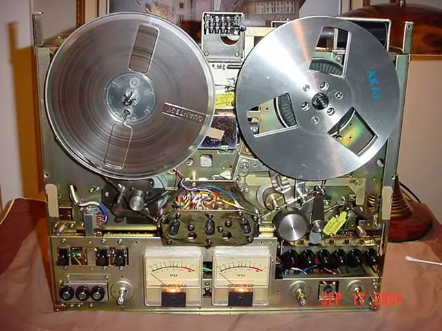

Testing the Akai and seeing it at work ...

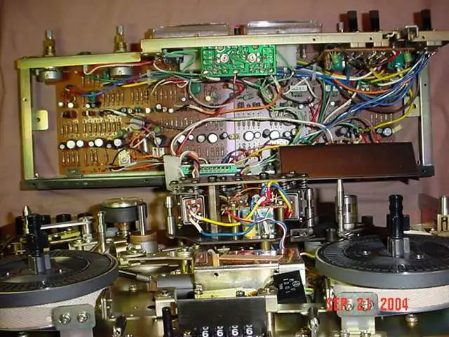

Pretty clean but complex in there ... looks like a brain! :eek:

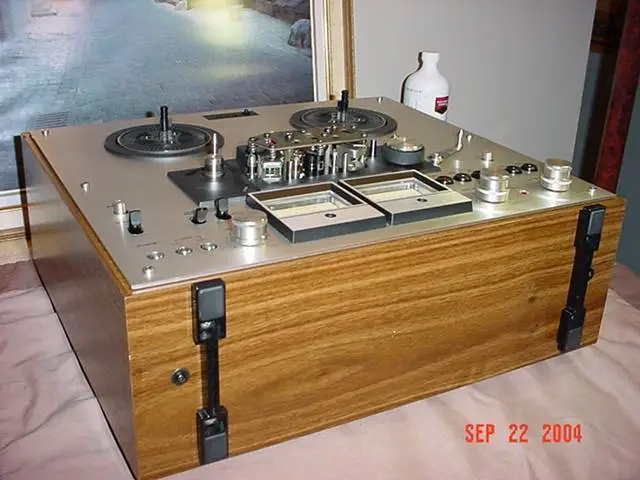

Putting it together .... nice and minty cabinet .....

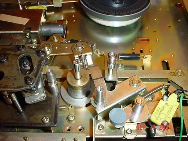

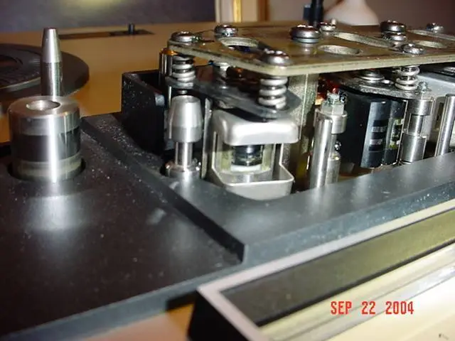

Well, here they are ..... clean but that "discoloration" is getting on my nerves! :mad:

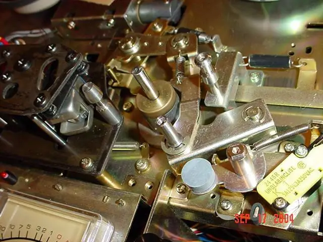

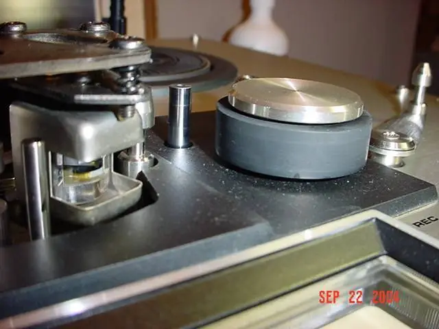

The pinch roller was cleaned with Rubber Renue from MG Chemicals. The pre and post "treatment" pinch roller is quite a dramatic difference ... Before it was brown from oxide that even scrubbing with dish detergent for 15 mins didn't fix completely ... With rubber renue, the roller is virtually new! :)
Couldn't get the brown stuff from the left roller completely ... but it looks much better than before ... :)
