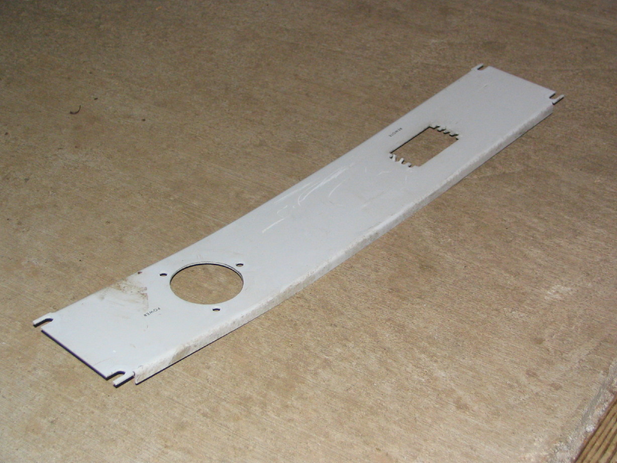

I'll save before and after pics of the back of the unit for later, but check this out...I wanted to clean up and straighten the power receptacle panel. It was bowed in because, at some point in its life, somebody backed this thing into a wall with the big power cable plugged in, and this 2U rackmount panel that holds the power receptacle and remote plug gave in to the momentum of 500~600lbs of tape machine.
Here are before and after pics:
I used a good bench-vise and a shop press and some blocks to straighten it out. It only took about 15 minutes total to straighten it and clean/polish it up. I also straightened a 2U blank panel which I believe was original to the MM-1000 but was mounted in the Ampex upright rack that came with the MM-1000. It was messed up bad...it is pretty heavy-guage steel and it was straight on the top but had a healthy 'S' bend on the bottom, a dent in the face and one of the "ears" was tweakered pretty bad. You can hardly tell now.

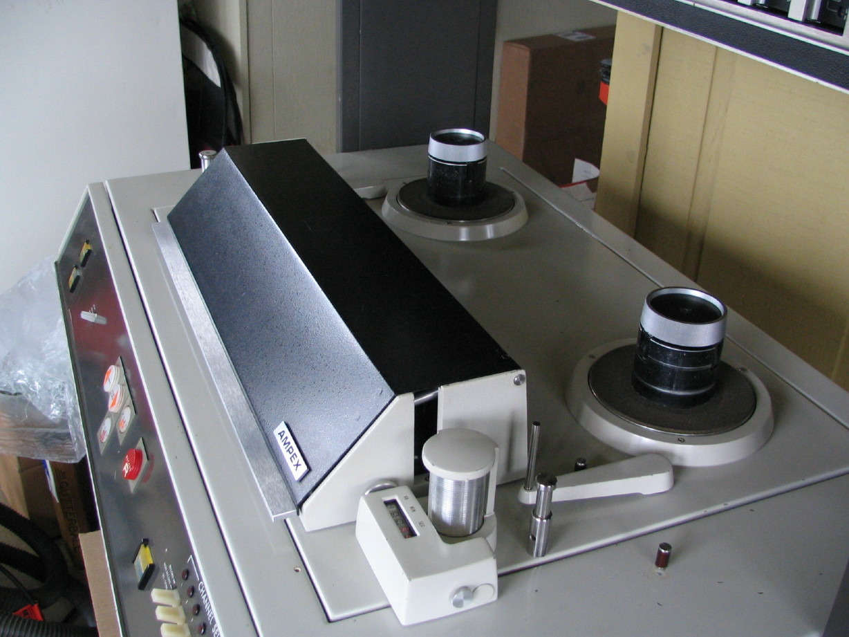

Got most of the transport back together...the problem with the supply motor brake is definitely mechanical but I can't figure it out yet. Anyway, its looking good...

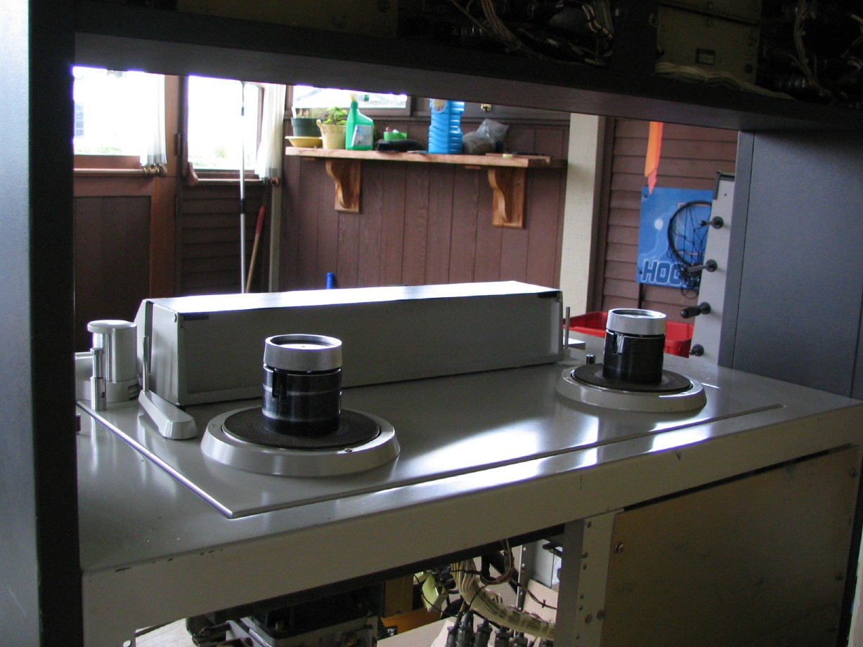

Well, it definitely doesn't look quite as "new" as some of my other refurb projects, but oh well. Here are some shots of the transport. The lifters have to go on yet as does the headblock, and I'm getting ready to remove a reel motor so I can form some new reel corks...I haven't touched the control panel yet...Look at post #3 for some before pictures.

The lifters are a bit involved because the nylon washers that bush between the lifter plates and the deck plate were totally shot, and inadequate IMO so I'm fashioning some bearing surfaces that have more surface area to prevent the lifters from kicking/tilting back when under pressure.
Plus I've cleaned up the safety guard for the tension resistors and remounted that...tracked down the proper hinges and hardware for the control box so that is all ready to remount...polished up the powersupply mounting plate, cleaned up the floor of the console under the power supplies and getting ready to mount a new cooling fan...cleaning up the breaker panel and repainting that 2U blank panel that i mentioned a few posts ago that was just trashed but is now straight and soon won't look like it got run over as far as all the scratches...working on repairing and cleaning the removable side panels...
so there is lots of activity, just not very exciting stuff but things I want to get taken care of before it gets wedged into the control booth.
