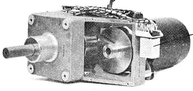

The belt is only accessible from the top of the assembly, meaning you have to remove the capstan shaft and motor assembly to see the belt. See below...

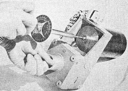

Oh, cool, Cory, thanks for the diagram. Looks like it's not a huge belt on a big fly wheel like some of the early machines that I've seen. That's a pretty ingenious belt design.
Yes. Stout design having the motor and shaft assembly mounted in one frame like that...here is another pic demonstrating the tensioning of the belt. It puts the size of things into perspective...I'm looking at the size of the adult male hand that is holding the capstan shaft. The thing is big. Keep in mind that the capstan shaft itself is about 3/4" or 19mm in diameter.
