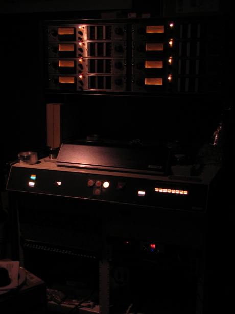

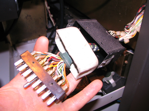

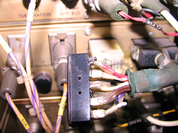

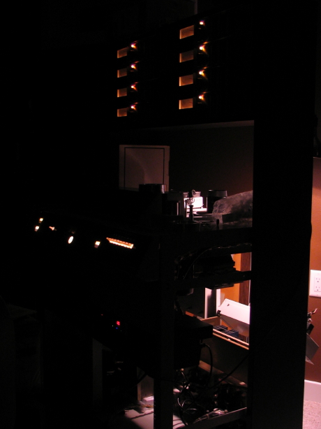

Now back to my record arming problem...the problem follows the cabling, so its NOT in the electronics...but...WHERE????????
Just on the electronics side.
I'm actually pretty excited because that's a pretty substantial clue...

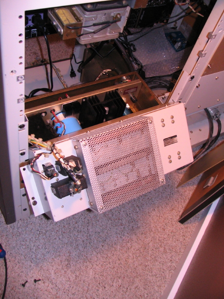

I chased down a couple other hunches to no avail, retraced my steps that led me to believe it was cabling but it wasn't totally adding up because the cabling tested good. I then remembered that I was going to bump the output of the +24V supply.
Remember that it was outputting about +22.5V under load.
I realize now that I refurbished that supply around in between the tracks all arming and then the onset of the track arming problem...recapped it, replaced the bridge rectifier as well as a zener on the regulator board...certainly that might change things. But it was still outputting +24V under no load and I see now that there's a note on the schematic that states that "All voltages listed are with no load on the output...", so I hesitated to increase it because it was outputting +24V with no load. Well, I decided to increase it just a little bit like to +23.5V under load and lo and behold all tracks armed except for 7 and 4. So I took it to +24V under load which was about +24.75V no-load and *BAM* all tracks arm no problem.

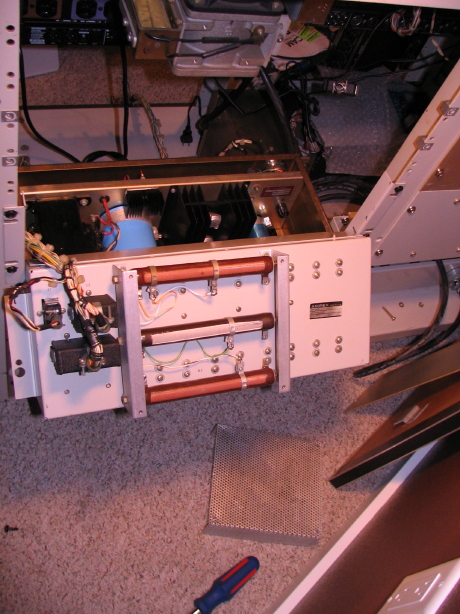

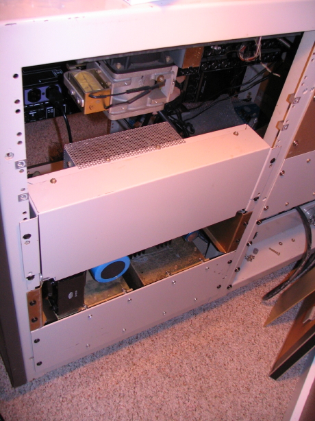

Peck, it does feel good. The machine has been pulled out from the wall and there's a mess in the room from, in part, the unsettled nature of its operation. Time to start straightening up.I want to get a snake mae up before I push it up to the wall to plug it up to the mixer, and get the tensions reset since those are set at the back of the machine. Then I can tuck back up to the wall, clean up my mess, recheck the brakes and then adjust the pinch roller tension and position and then....I get to start calibrating.
How exactly do you bump up those voltages to such precise levels? Is it not the transformer in the power supply that sets this initial voltage?

  Yeah the avatar thing was kind of spontaneous...I'm not one to change it but that record arming thing was, like, the last hurdle before the transport was finally ready again to be dialed in and when I got it licked and was sitting there jest lookin' at thm purty laghts and in perticuler that one big red one that was it.How exactly do you bump up those voltages to such precise levels? Is it not the transformer in the power supply that sets this initial voltage?
What really has me curious is the peculiar order in which the arming lights come on...
