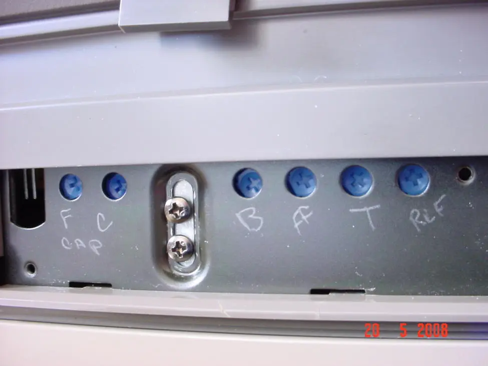

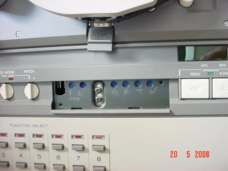

The plastic alignment tools that I bought last year don't seem to work at all on my latest acquisition, the TASCAM 48-OB.
The tools don't fit the 'tape tension' adjustment pots [photos attached]. I tried to make one from a credit card [it fit] but it was impossible to turn [tight fitting]. I need recommendations on what to buy. I don't necessarily wanna go plastic but something which won't pass static or possibly fry the electronics. Any ideas?:confused:

SMI Electronics in Langley has what you want, I think. I got a package of little plastic screwdrivers and adjustments (asst. sizes) for about 9 or 11 dollars. Looks like you need a plastic-tipped Phillips for those adjustments on your 48.

Daniel...where are those trimmers? Help me locate them on my 48 and I'll tell you what size philips bit you need, and then you'll know what set to get.
Cory, the tension trimmers are behind the splicing block. Just remove the 2 screws holding the splice block and you're there.:)

If it doesn't show or dictate the use of non-conductive tool, it is probably fine to use a regular screwdriver, but brian is right that there is the factor of feel and maybe damage but I test-fit a screwdriver bit in one of the pots last night and it turned nice and easy.
BTW I checked and a #1 philips bit fits those trimmers just fine. #2 is too big. The sets from the vendor in the first link include a #0 driver and or a #1.7 (???) driver...don't know what that is. I'd call and ask if the kit includes a #1 equivalent driver. The set in the second link has a #1 driver, but it seems like overkill unless you need all those drivers...

These are very common trim pots. Look carefully at the BOTTOM of the slot. It is flat all the way across, Just like with a screw for a flat blade, except here you have two slots.
A Philips blade is sharpened to a taper or point and so will do a poor job of engaging and will slip. Use a snug fitting flat blade and you'll be fine.
If you wanted to go for perfection you could grind the tip of a Philips blade flat, but why bother? Just use a flat blade that fits snugly.
Also dont worry about ESD in this instance. It's almost certainly not an issue.
