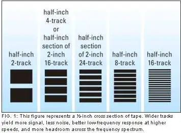

FIG. 1: This figure represents a ½-inch cross section of tape. Wider tracks yield more signal, less noise, better low-frequency response at higher speeds, and more headroom across the frequency spectrum.
As you might expect, a 2-track deck will be somewhat easier — and consequently less expensive — to calibrate and maintain than a multitrack machine. It can be a challenge to get all 16 or 24 tracks working equally well at the same time. That's why I recommend buying a used tape deck from a company that specializes in machine restoration. No tape recorder that is 20 years old or more can be counted on to be fully functional all the time, no matter how nice it looks.

On a 24-track pro machine that uses 2-inch tape, three tracks take up ¼ inch of space (see Fig. 1). On a semipro, narrow-format machine, you will have four or eight tracks for every ¼ inch of tape. The more tape real estate each track uses, the better the overall audio fidelity.

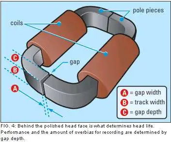

FIG. 4: Behind the polished head face is what determines head life. Performance and the amount of overbias for recording are determined by gap depth.

Here's a couple links that have been helps to me that I've referred to elsewhere, but I'll put 'em here for the collection:
The AnalogRules "BAD HEADS !!! page. Good pics and head construction information and can really help newbies and experienced users alike understand visually what to look for and how them heads are put together. I really like the pictorials and explaination in the EM article about had construction too.
