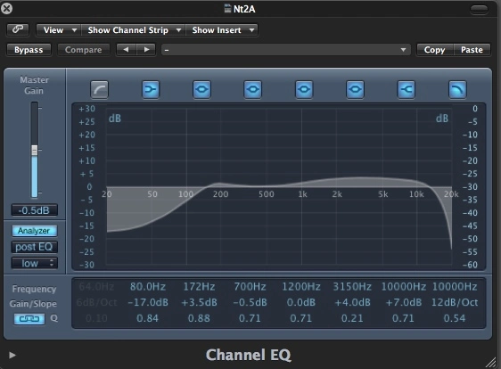

I equalized only the two NT2a L-R panned tracks (the original and the phase-inverted copy), this way:
Would you suggest any other equalization?

Yeah, I think it's worth trying, but to my ears, the low end isn't that lacking. And it might just need an eq tweak.
MeMyGuitar and WhiteStrat,
I suppose that it could just be my hearing. I worked around fighter jets for almost 25 years and could have some hearing loss in the lower frequencies, I don't know that as a fact. To me it sounds like it need a small tweak in the lower frequencies. Other than that I like you technique and your song.
