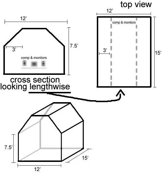

I'm in a mostly-bright attic. Wood floor, plaster and drywall walls...
About 15 feet long by 12 feet wide by 7.5 feet tall, with the slanted ceiling running lengthwise (see attached image below...this is simplified)
the audio monitors are a little close to the wall behind them. Could pull out a foot, but will that do much? (FYI: they're Yorkville YSM1P, with "normal" and 1/4 room switches enabled... that keeps the top end flat and attenuates -2db below 80hz)

I don't hear anything untoward in the clip in either phones (Sony 7506) or nearfields (Mackie HR824). The reason it's more pronounced in the second bar is because ~150HZ is apparently the primary overtone for the note played in that measure.
Based on the fact that I don't hear anything out of the ordinary in that frequency range here, nor see anything untoward in a FFT analysis, I'd agree that you probably have a monitoring problem. If you want to verify that, try two things: first see if that "spike" appears to you if you play it back on other systems in other locations yourself, and second, move around your room while playing back the "problem" clip and see if that spike disappras and reappears at various locations within the room; the modes should be somewhat granular and the spike should not be evenly spread throughout the room.)
Check out the "studio building forum" on this BBS for a whole cauldron of good info on bass trapping. It is frequented by Ethan Winer of Real Traps fame, but he also provids plenty of DIY tips on such treatments as well.

I would recommend running a frequency response analysis on your room. There are free test tones at:
http://www.realtraps.com/test-cd.htm
You will need an SPL meter, but these are inexpensive and good to have anyway.
It's kind of tedious to run the test, but it will tell you whether or not you have a monitoring issue. You probably do. My guess is that you also have other room modes that may be less noticable for whatever reason. It helps to know where they all are so you can avoid temptation to do too much 'corrective' eq at the mode frequencies.
