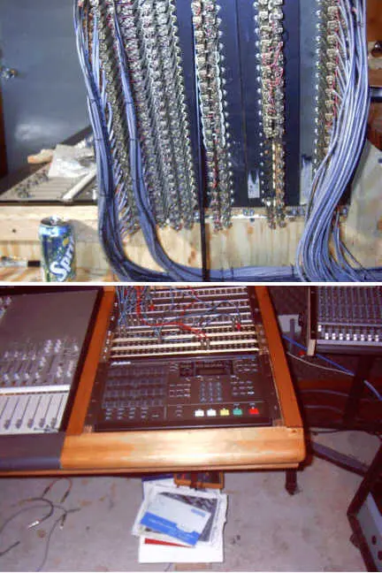

Very cool sir. I've been saying for years that this is exactly the kind of thing a person needs to be able to do if you want a studio. You can save yourself thousands by being able to fabricate these kind of things. I built this one between the control room and studio.

that is damn near identical to what I built several years ago except i made mine with rack ears however mine may be a little diffrent configuration... on the front i used female switchcraft panel mount connectors at the back side i used male Switchcraft panel mount connectors that way in a pinch I can use a standard mic cable to make the connections to my preamps or mixer
however I make my own Cables to the length I need to make my connection.
I built 2 of these boxes for about 40 bucks however price on parts have gone up since then but I would say for 60 bucks you could make 2 really nice rack mount panel boxes.

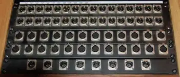

Here's a picture of mine.
Cost me about £75 ($150) The XLR's are all Neutrik but PCB mount which I got for under a £1 each as a job lot of eBay and the blank panels from Thomann for roughly £5 each.
The 32 Male XLR's at the top are, 16 from the live room, 12 from the dead room, 4 from the 2 isolation booths.
The 24 Female XLR's are to my outboard preamps.
The 8 Male XLR's at the bottom are the lounge and the hallway.

The panel was £5-6. The panel connectors were neutriks and cost £2.20 each I think, I skimped a bit more on the cable connectors as they're not going to see much action, they were like £1 each.
And the cable I already had on a reel. It's just standard, screened 2 core installation cable. The amount you need would only cost a few pounds/dollars though.
So about £30-£35 (or $60-$70) to make.
