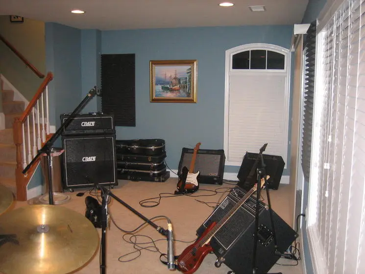

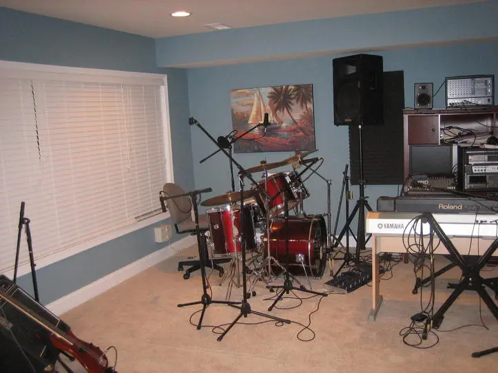

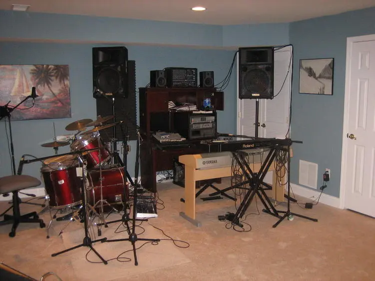

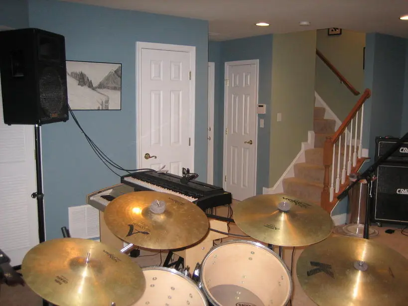

OK so my jam room/recording room is in the basement of my townhouse. It's roughly 21 feet by 15 feet, 8 foot ceilings. I say roughly because the room is not a perfect rectangle and there is a staircase and another short hallway that leads to the garage.
My question is this: Will a few bass traps make a noticable difference? If so, where should I place them? There are only a few places I can put them and unfortunately making them symetrical would be difficult. I am thinking the corner behind the drumset and between the wall and the ceiling above the guitar amps. Or maybe between the wall and the ceiling above the window or above that drawing opposite of the window.
What would be the optimal amount to have? What would be the minimum that is worth-while?
I am thinking about buying a few from realtraps or Ready Accoustics. They both look very nice but Ready accoustics seems to be a little cheaper. Is there a performance difference between the two? Anyone done a comparo? Is there are third company I should consider?
Or I might make them myself.
Any help is appreciated. Thanks dudes.

You didn't tell us specifically what the problem is though. If it's just a jam room, bass traps might be too much. If all you're looking to do is dampen the room in the highs some, then 2" panels would be fine.
So...what's the problem you're trying to solve?

Just a personal observation but when we have 3 guitars, a bass, keys, and drums going, it does get a little muddy in certain ranges. I don't know if bass traps would help with that. I also try to arrange our music to avoid that.
But yeah, we do record and mix in there as well so hopefully there will be a little improvement. Baby steps. :)
I ended up buying two HF panels and four regular baretraps. Diffusors are pricey so perhaps someday. I'll probably put the two HF panels in the reflection points and go from there.
My room does exhibit some of the undesirable qualities. You know that sound you hear when talking in a hallway? That tin sounding echo? My room does that just a little.
Coolio. I will forthwith backpedal from my previous advise with abandon. If things are muddy *and* you're mixing in there, plenty of broad band (4") panels would be the way to go. Ideally I'd like to see superchunks in the available corners.
