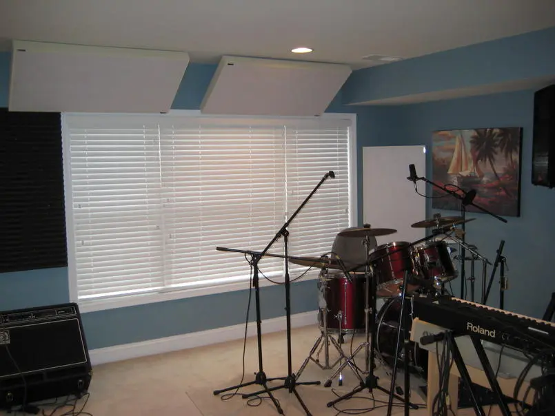

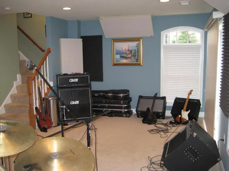

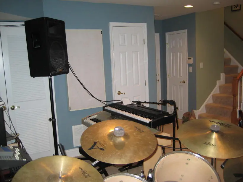

Thanks to everyone who replied to this thread. You guys made this a lot easier and saved me a lot of time. Just thought I would share the finished product with you guys. I tried to use as many of the tips in terms of placement, but in the end, the size of my room and the number of things I have in there constrained my flexibility to a large degree. Still thinking about the drumset and the bass amp trading spots so I can move the monitors to the center of that wall and put my listening position closer to the 38%. But that's another discussion for another day.

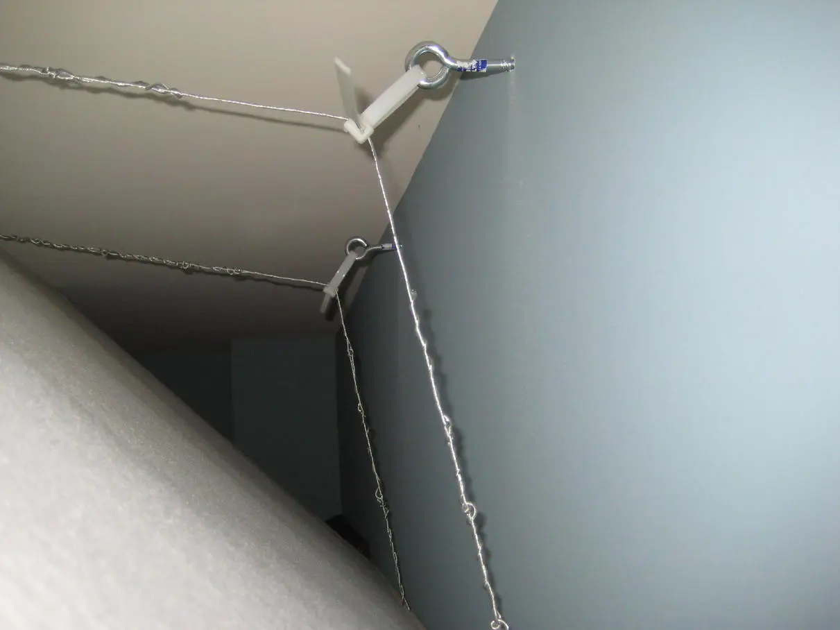

As far as mounting these things, I recommend the following:
Tools necessary:
Drill, stud finder
Materials:
Heavy duty picture wire, eye hole screws, heavy duty zip ties.
The Zip ties I bought have a tensile strength of 175 pounds. Seeing as how the bass traps are 18 pounds, the ties are not going to be be the weak link here.

Since the top and bottom edges of the traps are actually touching the ceiling and wall...couldn’t you have just used real long sheetrock screws (or toggle bolts) to anchor them at those two edges right into the ceiling and wall…instead of having to do all that wire-n-hook stuff in back?
Oh...and the one trap you have on the wall...is it right against the wall or with a space between it and the wall?
I think they need to be away from the wall for max value...?

I suppose, but then wouldn't there be screws showing? Not sure I am completely understanding your method. The way I did it, you don't see any screws or wire unless you stick your head behind the trap and look. I feel pretty good about how solidly they are mounted. I certainly don't want one of these things falling on my drummer's head (18 pounds + sharp metal corners = ouch). Rigging the wire was time consuming and kind of a pain in the ass.

I recently bought a flat screen TV and a wall mount that came with heavy duty bolts and spacers. They included extra spacers of various sizes. I used these spacers on the back of my flat wall mounted trap. I'm not sure what is the optimum amount of space. I have about two inches currently that I could easily adjust (edit: you can't really tell this from the pic. I'll post another one when I get back to Virginia).

Depending on how they're made, sure...that would work just fine.

Yeah, it looks like it would be, which is why I was asking about using long screws....and just screwing them through the corners of the framing...might have to drill a hole first to do it neatly.
Another idea would be to use small hinges...2-3 at each side. First screw (or even glue w/epoxy) to the frames...then just screw into the ceiling and wall. You do one side, and then just swing them into position to do the other.
You would have to use the right screws/anchors for sheetrock.
I'm only thinking out loud...'cuz I plan on adding a few more traps, and I'm considering different options for mounting.
I'm also wondering if it's really necessary to have them angled across the corners...or will you get almost the same affect if you just hung them from the ceiling, but close to the corner joint...???...or on the wall, but close to the corner joint...???

I think 2" is OK...with more being a bit better...but again, it ain't always easy to do or to give up that space. Yours are not obtrusive....they look nice in that space.
Are those Ethan's "Bare Traps"...? They are a pretty good deal at $100 each.
If I hang any from the ceiling, I wouldn't do more than 2" as I don't have the height to give away on anything more. :(
I think though the key is not to have traps flush against the ceiling or walls...but you could, they just don't work as well on the low end if I'm not mistaken.
You already have traps so I'm sure you considered this, but the bare traps only have a few small holes in the backs of the frames that you can use for mounting. So in my case using hinges would have been tricky. I actually considered that when I went to the hardware store. Not sure what kinds of mounting capabilities other traps have but from what I understand many of them have more options than the bare traps.
Once I got my method worked out, the way I installed them was actually quite easy. If I had to do it again I would stick with the wire/eyehole screw/zip tie combination.
