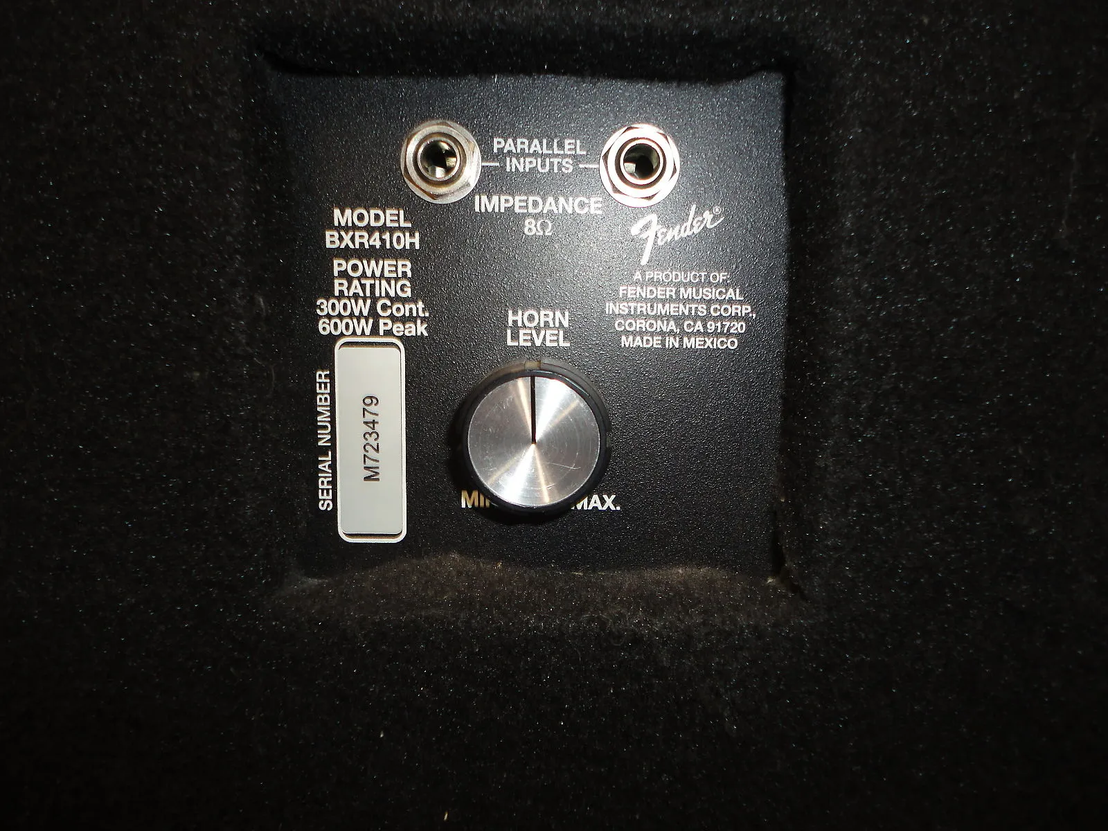

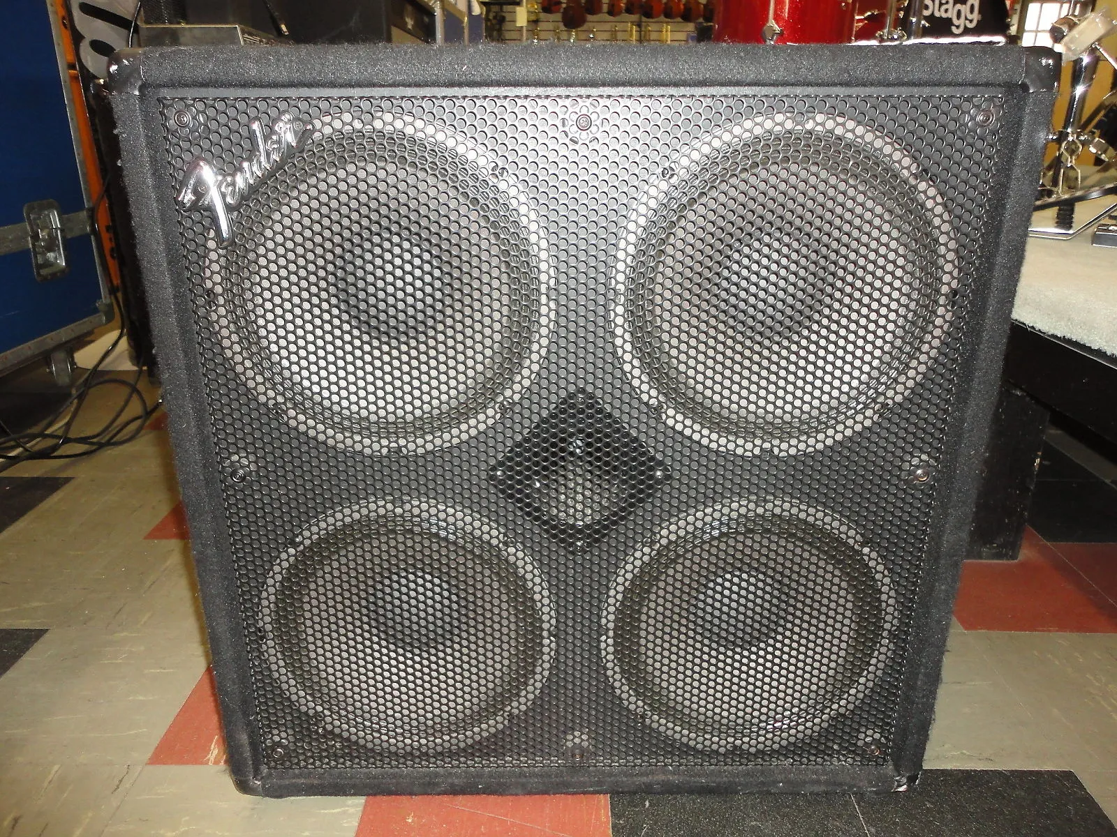

The minimum on the amp head is at 2ohms and max at 4ohms. I notice looking at the pic of the cabinet and it's wired parallel. I'm sure I wont destroy anything if I hook them up, I'm just wondering if it would be worth doing it.

But the speakers are wired parallel and two 8ohms speakers wired that way =4ohms. The Amp head has a left and right channel just like the cabinet. I'm just worried it might not sound the way I want it. This is my first attempt at a stack and the only cabinet that was in my price range that wasn't beat the hell up. Music go round had my ideal cabinet at 250 but wanted to charge 200 for shipping.
It's a solid state head, so you can plug it into a cabinet with a higher impedance. Just don't go below 4 ohms.

The tweeter has a level control on the back so that solves that problem.
