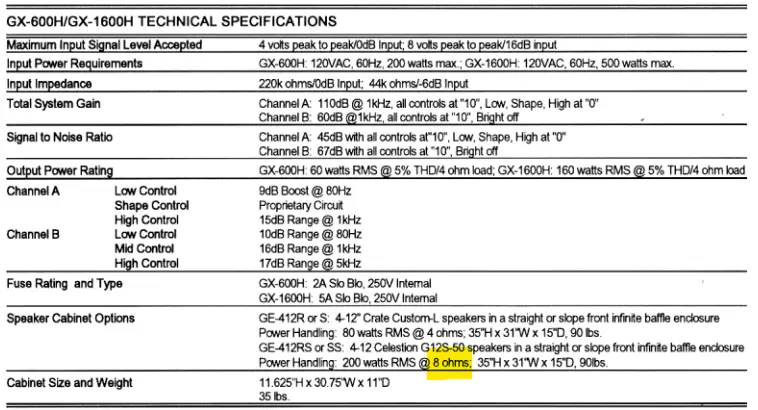

The manual is here: http://pdfstream.manualsonline.com/0/079c970d-a285-ed24-3d6e-a597b4366a6b.pdf
Under EXTERNAL SPEAKER...It also says ' speakerS' with an S at the end. 'S" is Two or more. Two 8 ohm cabinets would be 4 ohms.

Nah, it's just a reference to speakers in general. It's not saying multiple speakers are required. The only prohibition is on loads below 2 ohms, which is consistent with solid state amps in general. You could connect to to a load of 1000 ohms and it would be fine, just really quiet.

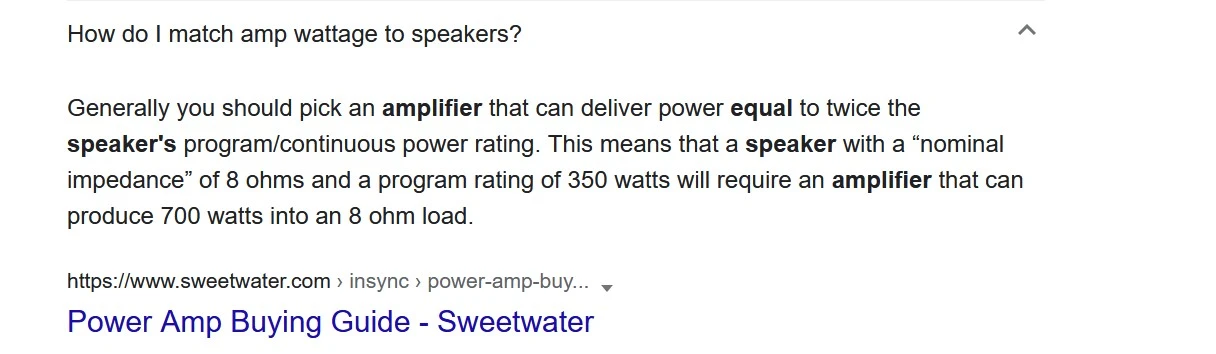

The speaker says on the warning label DO NOT EXCEED WATTAGE, but the how-to-books say to double the wattage. That could be confusing to some people.
As much as l like Sweetwater, that's total BS. It doesn't REQUIRE twice the power. You can put a 200 watt speaker on a Princeton Reverb with a massive 12-15 watts. You just won't burn out the voice coil. It will still work, and depending on the sensitivity of the speaker, may be just as loud as a 20 watt speaker.
I think the trend to do this is because there was a time when the research into failed voice coils determine that the presence of distortion speeded up failure - so a more powerful amp running at less than it's maximum would have lower distortion products and have less impact on the speakers. I don't think the idea was ever that you actually drive a 700W capable amp at full power into a speaker rated at half that. Other people of course reversed this - maintaining that squirting twice as much level is clearly damaging. Both camps believed they were right. This also ignores all the stuff about RMS, Peak, Continuous and Programme power. I think I like the car analogy. A big engine that never gets stressed in a small car is better than a big car with underpowered engine thrashing itself to death ....... I think?

For a valve amp the speaker should be rated at at least 50% over the stated amp power, better 100% because valves do not have a 'sudden death' clip point, they keep putting out power at ever increasing distortion.
Could you provide any references for this recommendation? Screen clip from a book or database?
