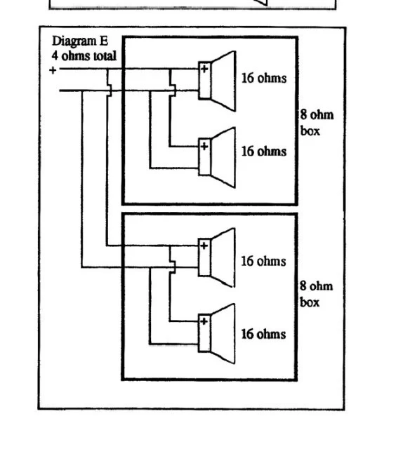

Anyways..Can you get two of them? 2x 8 ohm cabinet is 4 ohms.

8 ohm and 8 ohms is 4 total.
It is not a waster if you wanted the amplifier to see a total load of 4 ohms. The stated max spec on the amplifier was 4 ohms.
Right, but half the power would be turned into heat in the load resistor, so you would only have half the power left to go to the speaker cabinet. What is the advantage?
