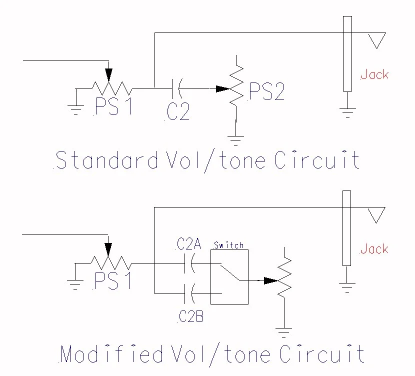

If you are going to replace the pot, why not put a push/pull in it. You can switch between 2 different caps for you treble cutoff. I used some pots for different pickup combos (http://home.comcast.net/~bonrox/guitars/Callie.htm),
I just recently helped a buddy of mine put in a push/pull for the tone section, which just what you are talking about. It's a simple hookup. Let me know if you need it drawn out, but all you need to do is just replace the cap in your current circuit, with 2 caps and a switch).
I just attached an example for you
