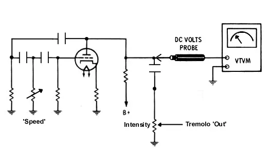

that still leaves me with the no tremolo problem to deal with in the meantime. I will have to take a look at some tremolo circuits and do the test with the analog meter I have. I am not sure what I am seeing on the scope. It may be to slow for it?
The best way I've found to 'see' a tremolo circuit in action is with a plain old-school analog voltmeter or even a VTVM, like so;
VTVM.webp​
As the 'Speed' control is set higher, the needle should swing faster. Assuming the wiring is right (even if you check all capacitors and resistors for value, remember the wires connecting them together!), and the tube is good, all the can be done is now test the capacitors for leakage. Few people have a leakage tester, and your typical Fluke DVM can't check leakage, so just changing all three oscillator capacitors is usually fast and pretty much guaranteed to solve the problem. Well, as long as the footswitch part is right.

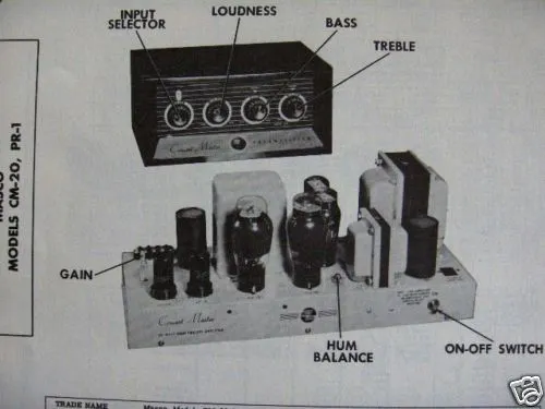

I am having fun doing this more than anything else. But if I do fix this it may be the last one on the planet? No one I know has ever seen another one and I know quite a few old musicians. Then I have my masco amp to work on. I replaced the filter caps and some other parts but I am not quite there yet. I only have the amp, it is shown with a preamp. The amp is a dual rectifier with 2 6L6s rated at twenty watts rms. I also fixed the bias circuit on one of the 6L6s and now I have distortion in the preamp circuit. It is getting twice as much voltage to the plate than what is stated on the schematic so next I will check its plate resistor. The gain pot is shot and I bought one off of ebay, supposedly brand new but it was no good.
Well no oscillation on my analog meter on any tube plate so I will be replacing the caps.
